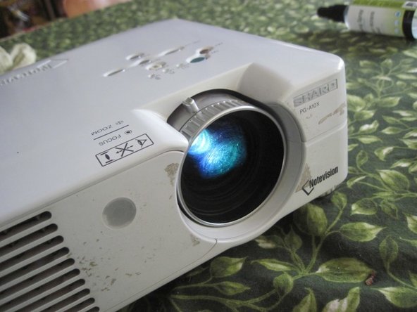

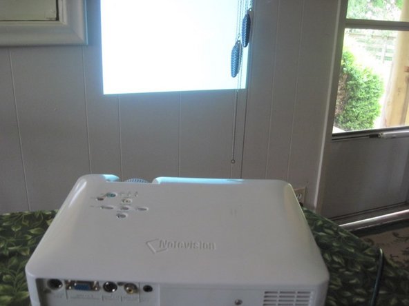

Sharp PG-A10X Thermal Fuse Replacement

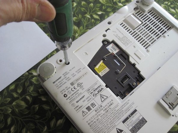

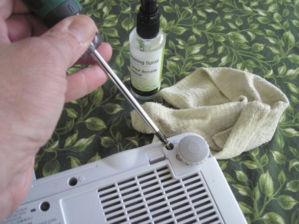

  1. Sharp PG-A10X Thermal Fuse Replacement, Open the case: crwdns2935265:01crwdnd2935265:01crwdnd2935265:03crwdne2935265:0 Sharp PG-A10X Thermal Fuse Replacement, Open the case: crwdns2935265:01crwdnd2935265:02crwdnd2935265:03crwdne2935265:0 Sharp PG-A10X Thermal Fuse Replacement, Open the case: crwdns2935265:01crwdnd2935265:03crwdnd2935265:03crwdne2935265:0
    • We are assuming that since you are using "iFixIt" then you will want to ignore the warning about electrical shocks. Unplug the projector from the power (no danger of shocks now) and remove the six 0.5" phillips head screws.

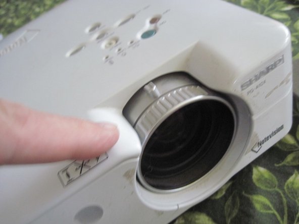

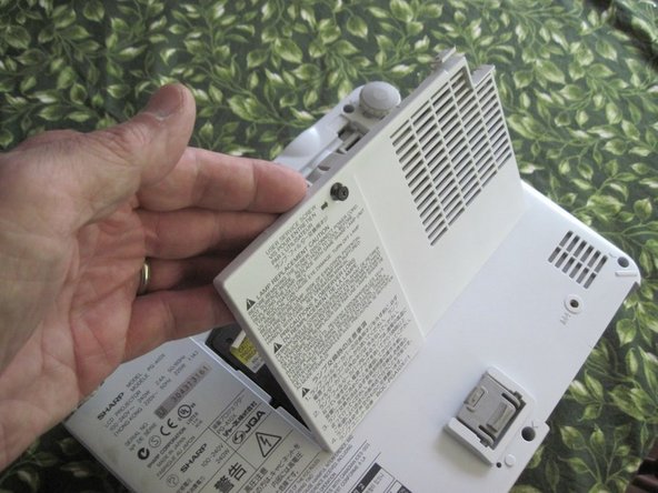

  2. Sharp PG-A10X Thermal Fuse Replacement, Remove the lamp access panel: crwdns2935265:02crwdnd2935265:01crwdnd2935265:03crwdne2935265:0 Sharp PG-A10X Thermal Fuse Replacement, Remove the lamp access panel: crwdns2935265:02crwdnd2935265:02crwdnd2935265:03crwdne2935265:0 Sharp PG-A10X Thermal Fuse Replacement, Remove the lamp access panel: crwdns2935265:02crwdnd2935265:03crwdnd2935265:03crwdne2935265:0
    • Although not exactly necessary for this procedure, it's a good idea to remove the lamp access panel too at this point. Loosen the captive phillips screw at the edge of this cover (it's black) and then pressing the catch with your finger, open the cover like a door.

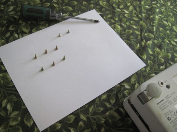

  3. Sharp PG-A10X Thermal Fuse Replacement, Remove two screws on the back: crwdns2935265:03crwdnd2935265:01crwdnd2935265:03crwdne2935265:0 Sharp PG-A10X Thermal Fuse Replacement, Remove two screws on the back: crwdns2935265:03crwdnd2935265:02crwdnd2935265:03crwdne2935265:0 Sharp PG-A10X Thermal Fuse Replacement, Remove two screws on the back: crwdns2935265:03crwdnd2935265:03crwdnd2935265:03crwdne2935265:0
    • There are two more screws to remove, the two chrome-plated phillips screws in the back-panel near the input sockets. There is another screw like these near the black power socket--it is not necessary to remove that one. Keep these two screws separate from the six longer ones you just removed in the previous step.

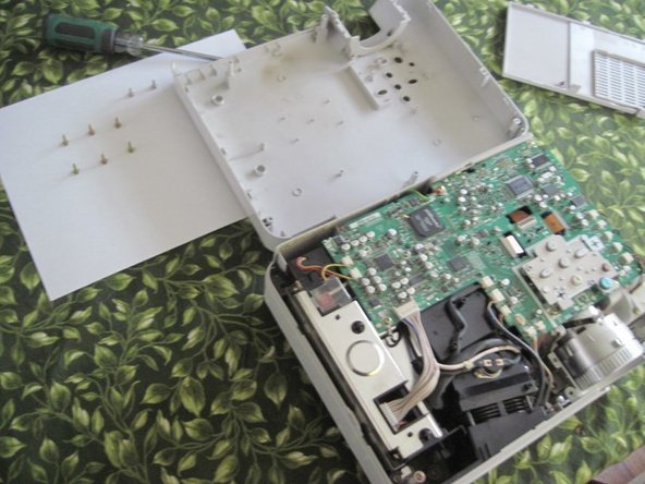

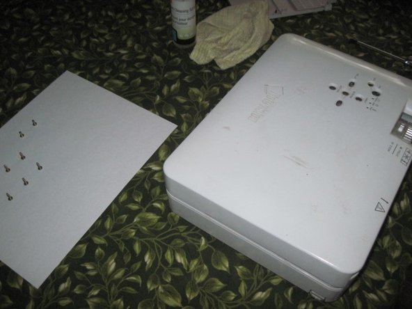

  4. Sharp PG-A10X Thermal Fuse Replacement, Pry the case apart: crwdns2935265:04crwdnd2935265:01crwdnd2935265:03crwdne2935265:0 Sharp PG-A10X Thermal Fuse Replacement, Pry the case apart: crwdns2935265:04crwdnd2935265:02crwdnd2935265:03crwdne2935265:0 Sharp PG-A10X Thermal Fuse Replacement, Pry the case apart: crwdns2935265:04crwdnd2935265:03crwdnd2935265:03crwdne2935265:0
    • Turn the projector over (right side up). If you have not already removed the six screws from the holes (unscrewed in step one) then they should fall on the table now. Pick them up and keep track of them. With a flat-blade screwdriver (or a butter-knife) carefully work around the match joint between the case halfs until the top is free (it clips)

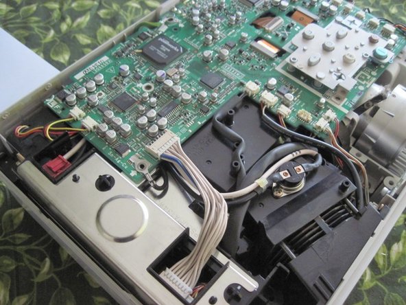

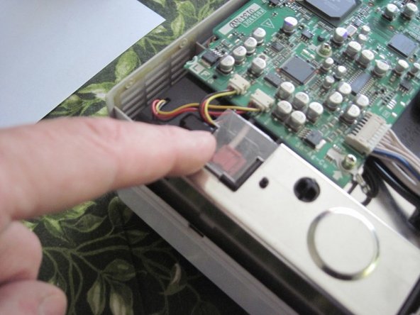

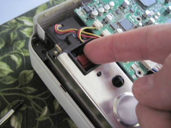

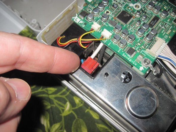

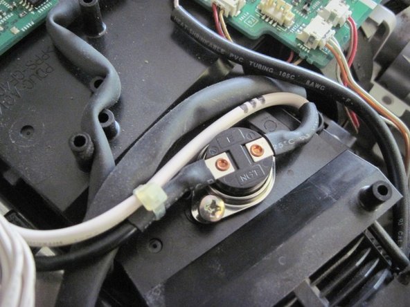

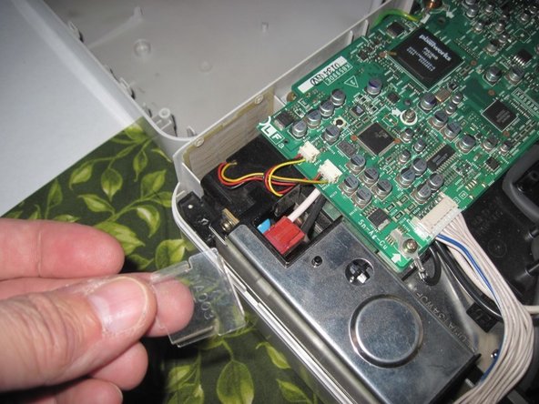

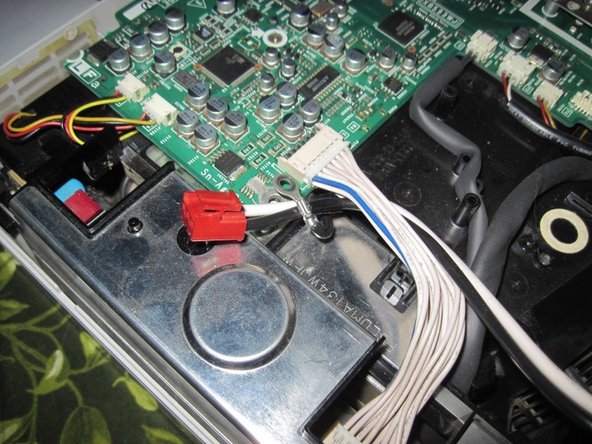

  5. Sharp PG-A10X Thermal Fuse Replacement, Disconnect the thermal fuse (1): crwdns2935265:05crwdnd2935265:01crwdnd2935265:03crwdne2935265:0 Sharp PG-A10X Thermal Fuse Replacement, Disconnect the thermal fuse (1): crwdns2935265:05crwdnd2935265:02crwdnd2935265:03crwdne2935265:0 Sharp PG-A10X Thermal Fuse Replacement, Disconnect the thermal fuse (1): crwdns2935265:05crwdnd2935265:03crwdnd2935265:03crwdne2935265:0
    • The part we are replacing, the thermal fuse, is a silver button with one black and one white wire connected to it. Both of these plug into the chassis at this red connector. Remove the clear plastic cover with a flat screwdriver.

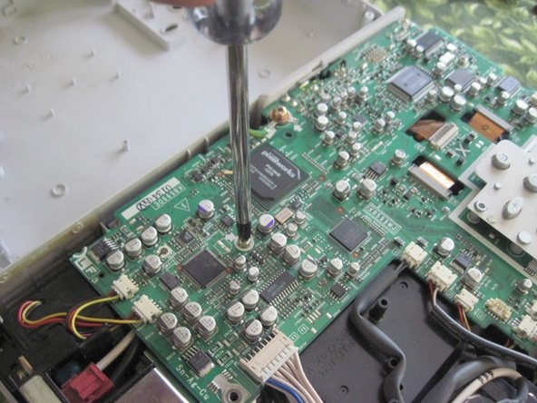

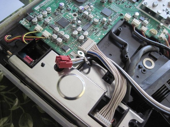

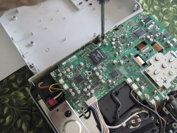

  6. Sharp PG-A10X Thermal Fuse Replacement, Loosen the circuit board (1): crwdns2935265:06crwdnd2935265:01crwdnd2935265:03crwdne2935265:0 Sharp PG-A10X Thermal Fuse Replacement, Loosen the circuit board (1): crwdns2935265:06crwdnd2935265:02crwdnd2935265:03crwdne2935265:0 Sharp PG-A10X Thermal Fuse Replacement, Loosen the circuit board (1): crwdns2935265:06crwdnd2935265:03crwdnd2935265:03crwdne2935265:0
    • There are more than four screws holding down the circuit board. You only need to remove four of them--just enough to raise the corner of the board that is over the thermal fuse wires. Two of these screws also have round wire-lugs under them: the one on the lower left and the one in the top middle.

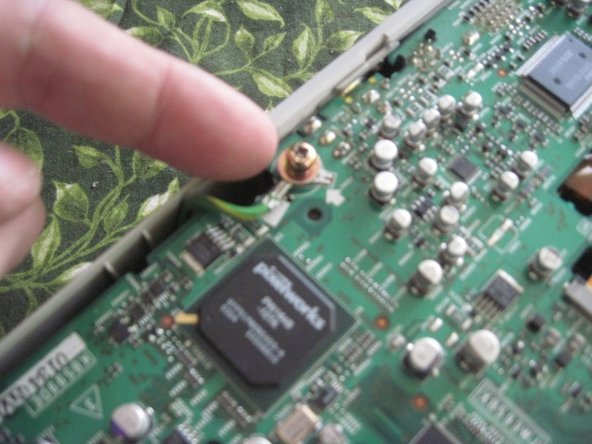

  7. Sharp PG-A10X Thermal Fuse Replacement, Loosen the circuit board (2): crwdns2935265:07crwdnd2935265:01crwdnd2935265:02crwdne2935265:0 Sharp PG-A10X Thermal Fuse Replacement, Loosen the circuit board (2): crwdns2935265:07crwdnd2935265:02crwdnd2935265:02crwdne2935265:0
    • One of the screws, the back one in the middle, is larger than the others. Just remember what holes they came out of to put them back. Four screws: 1) front left corner, 2) back edge in the middle, 3) one halfway between these two, 4) one next to the lens near the control buttons. The circuit board does not come off.

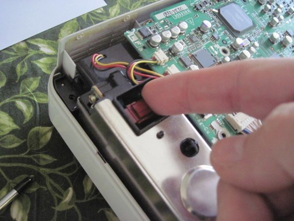

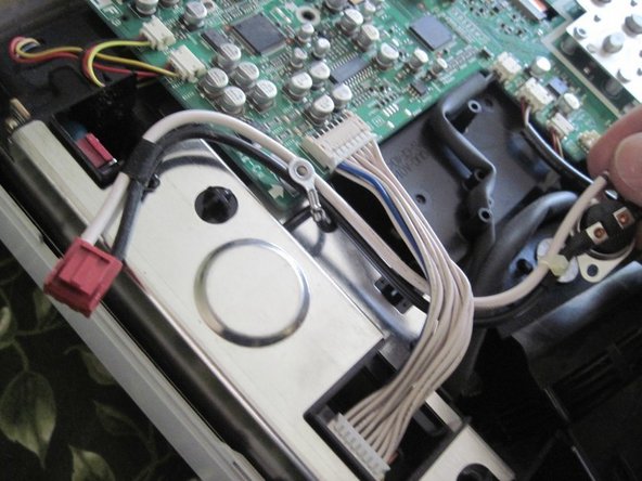

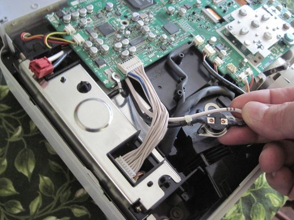

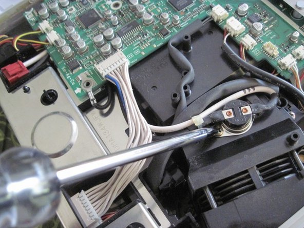

  8. Sharp PG-A10X Thermal Fuse Replacement, Remove the thermal fuse (1): crwdns2935265:08crwdnd2935265:01crwdnd2935265:03crwdne2935265:0 Sharp PG-A10X Thermal Fuse Replacement, Remove the thermal fuse (1): crwdns2935265:08crwdnd2935265:02crwdnd2935265:03crwdne2935265:0 Sharp PG-A10X Thermal Fuse Replacement, Remove the thermal fuse (1): crwdns2935265:08crwdnd2935265:03crwdnd2935265:03crwdne2935265:0
    • Now you can slide the red connector for the fuse back off it's socket: use a flat blade screwdriver to release the catch. Also, remove the single screw holding the fuse assembly itself (The business end) to the black fan-box. Keep your screws organized!

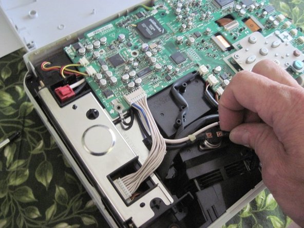

  9. Sharp PG-A10X Thermal Fuse Replacement, Remove the thermal fuse (2): crwdns2935265:09crwdnd2935265:01crwdnd2935265:03crwdne2935265:0 Sharp PG-A10X Thermal Fuse Replacement, Remove the thermal fuse (2): crwdns2935265:09crwdnd2935265:02crwdnd2935265:03crwdne2935265:0 Sharp PG-A10X Thermal Fuse Replacement, Remove the thermal fuse (2): crwdns2935265:09crwdnd2935265:03crwdnd2935265:03crwdne2935265:0
    • Gently lift the circuit board front left corner and work the black and white wires of the thermal fuse out from beneath it. Note that they go under the circuit board but over the black connecting wire on the corner screw hole, and under the wire harness between the circuit board and chassis. No need to remove the wire harness.

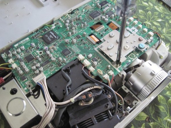

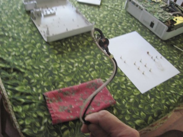

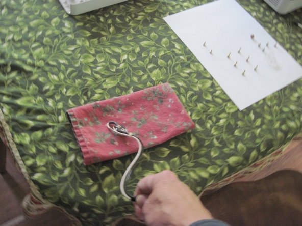

  10. Sharp PG-A10X Thermal Fuse Replacement, "FIX" the thermal fuse!: crwdns2935265:010crwdnd2935265:01crwdnd2935265:03crwdne2935265:0 Sharp PG-A10X Thermal Fuse Replacement, "FIX" the thermal fuse!: crwdns2935265:010crwdnd2935265:02crwdnd2935265:03crwdne2935265:0 Sharp PG-A10X Thermal Fuse Replacement, "FIX" the thermal fuse!: crwdns2935265:010crwdnd2935265:03crwdnd2935265:03crwdne2935265:0
    • This is the cool part. You can replace the thermal fuse you just removed with a new one, OR it is possible to "re-set" the fuse for another go. Hold the assembly by the plug in one hand, set the button on a padded surface on the table (silver side down) raise it up about 18" and SLAP the button part DOWN on the pad. One "whap".
  11. Sharp PG-A10X Thermal Fuse Replacement, Replace the thermal fuse: crwdns2935265:011crwdnd2935265:01crwdnd2935265:03crwdne2935265:0 Sharp PG-A10X Thermal Fuse Replacement, Replace the thermal fuse: crwdns2935265:011crwdnd2935265:02crwdnd2935265:03crwdne2935265:0 Sharp PG-A10X Thermal Fuse Replacement, Replace the thermal fuse: crwdns2935265:011crwdnd2935265:03crwdnd2935265:03crwdne2935265:0
    • Whether you fixed the fuse with a "whap" or whether you bought a new part assembly (part #QCNW-B110WJZZ, Bi-metal PCB--Google it, you'll find one like the one in the picture) snake the fuse wires and connector back under the wire harness, over the black wire and under the corner of the circuit board (gently pry the corner of the board up).

  16. Sharp PG-A10X Thermal Fuse Replacement, Replace the case screws: crwdns2935265:016crwdnd2935265:01crwdnd2935265:03crwdne2935265:0 Sharp PG-A10X Thermal Fuse Replacement, Replace the case screws: crwdns2935265:016crwdnd2935265:02crwdnd2935265:03crwdne2935265:0 Sharp PG-A10X Thermal Fuse Replacement, Replace the case screws: crwdns2935265:016crwdnd2935265:03crwdnd2935265:03crwdne2935265:0
    • Replace the two plated screws at the connector panel on the back, and then turn the projector upside-down and replace the six case screws in the deep holes on the bottom. Tight, but not too tight--remember this is plastic.

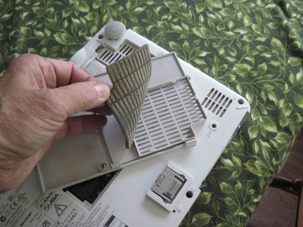

  17. Sharp PG-A10X Thermal Fuse Replacement, Clean the filter: crwdns2935265:017crwdnd2935265:01crwdnd2935265:03crwdne2935265:0 Sharp PG-A10X Thermal Fuse Replacement, Clean the filter: crwdns2935265:017crwdnd2935265:02crwdnd2935265:03crwdne2935265:0 Sharp PG-A10X Thermal Fuse Replacement, Clean the filter: crwdns2935265:017crwdnd2935265:03crwdnd2935265:03crwdne2935265:0
    • The lamp access panel has a foam air filter in it that is easy to clean. It's also easy to tear! So be careful, remove the foam from the access panel. You can carefully vacuum the dirt with a vacuum cleaner, blow it with compressed air, or even wash it with water and dry it if you like. Just be careful not to tear it. Put it back and close the lid.
