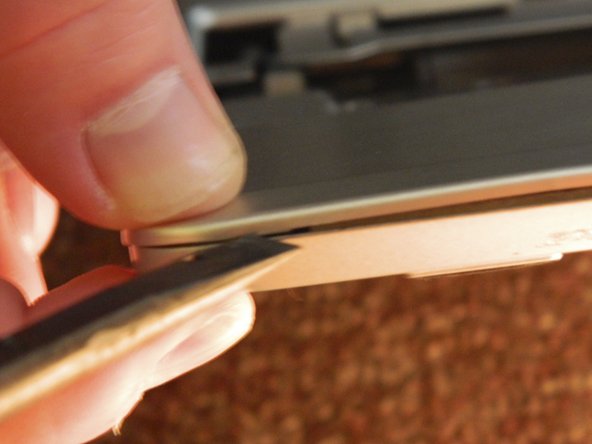

  4. Sharp PC-MM20 Keyboard Replacement: crwdns2935265:04crwdnd2935265:01crwdnd2935265:02crwdne2935265:0 Sharp PC-MM20 Keyboard Replacement: crwdns2935265:04crwdnd2935265:02crwdnd2935265:02crwdne2935265:0
    • Next, open the laptop and focus on the front of the base of the laptop.
    • Notice that there are small notches in between the two plates of the laptop. There are several slots such as this that are found across the front base of the laptop.
    • Take a flat edge and wedge it into the slot to pop it open.
