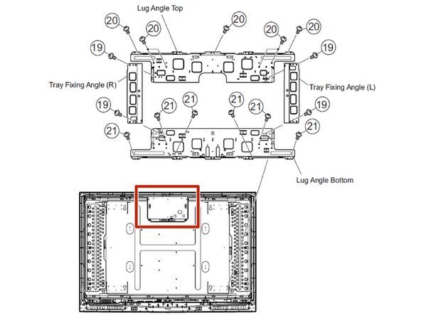

  8. Sharp LC-42D62U  T-Con Board Replacement, Remove the tray fixing angles and the lug angle top: crwdns2935265:08crwdnd2935265:01crwdnd2935265:01crwdne2935265:0
    • Remove the 7 screws holding the lug angle top.
    • Then remove only the bottom screws from the tray fixing angles, leaving the top screws attached to the lug angle top.

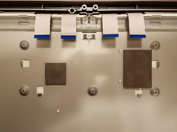

  10. Sharp LC-42D62U  T-Con Board Replacement, Remove the last screw and disconnect the 4 ribbon cables: crwdns2935265:010crwdnd2935265:01crwdnd2935265:01crwdne2935265:0
    • To disconnect the ribbon cables, lift the brown tab on the connector.
    • Make sure the ribbons are positioned correctly in the connector when reassembling the new board.
  11. Sharp LC-42D62U  T-Con Board Replacement, Remove the T-Con board: crwdns2935265:011crwdnd2935265:01crwdnd2935265:02crwdne2935265:0 Sharp LC-42D62U  T-Con Board Replacement, Remove the T-Con board: crwdns2935265:011crwdnd2935265:02crwdnd2935265:02crwdne2935265:0
    • There are two pads glued under the board (see yellow marks in the picture): use a heat gun to soften them and then gently pry them to detach the board from the frame.
    • There are also 4 tabs holding the board: gently pull the board to release it, after the pads are disconnected.
    • Reposition the pads on the chassis before installing the new board.
