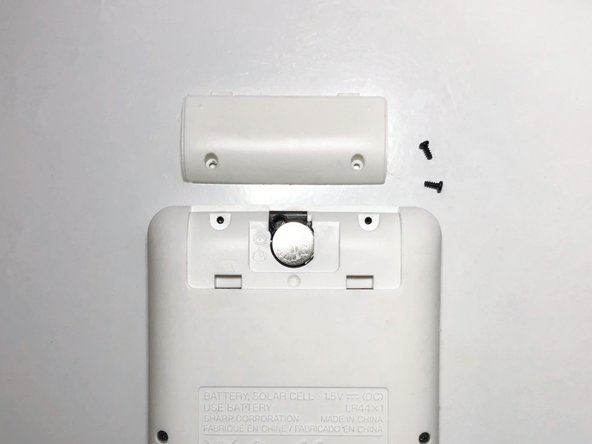

    • Turn off the calculator by pressing both the [2NDF ] and [ON] buttons at the same time.
  2. Sharp EL-W535XG Battery Replacement: crwdns2935265:02crwdnd2935265:01crwdnd2935265:01crwdne2935265:0
    • Flip the calculator so that the battery cover is facing you, and it will be easy to remove.
  3. Sharp EL-W535XG Battery Replacement: crwdns2935265:03crwdnd2935265:01crwdnd2935265:02crwdne2935265:0 Sharp EL-W535XG Battery Replacement: crwdns2935265:03crwdnd2935265:02crwdnd2935265:02crwdne2935265:0
    • Remove the two screws securing the battery cover with the Tri-point #000 screwdriver.
    • Remove the battery cover.
    • Make sure not to remove the other screws on the calculator, just the two screws on the battery cover.

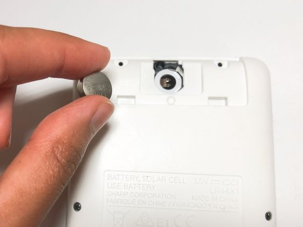

  4. Sharp EL-W535XG Battery Replacement: crwdns2935265:04crwdnd2935265:01crwdnd2935265:02crwdne2935265:0 Sharp EL-W535XG Battery Replacement: crwdns2935265:04crwdnd2935265:02crwdnd2935265:02crwdne2935265:0
    • Remove the worn-out LR44 battery inside using a spudger.
  5. Sharp EL-W535XG Battery Replacement: crwdns2935265:05crwdnd2935265:01crwdnd2935265:01crwdne2935265:0
    • Gently insert the new LR44 battery in the empty battery slot.
  6. Sharp EL-W535XG Battery Replacement: crwdns2935265:06crwdnd2935265:01crwdnd2935265:01crwdne2935265:0
    • Place and screw the battery cover on using the Tri-point #000 screwdriver.
    • Tightly screw the battery cover to prevent losing screws.
