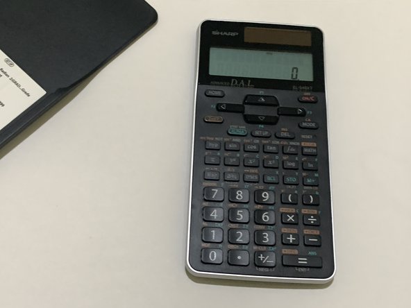

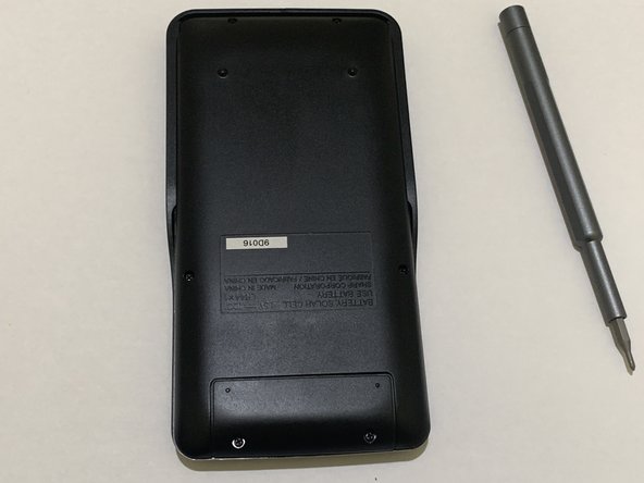

    • Place the calculator on a clean workspace with the back facing up.
  2. Sharp EL-546XT Battery Replacement: crwdns2935265:02crwdnd2935265:01crwdnd2935265:03crwdne2935265:0 Sharp EL-546XT Battery Replacement: crwdns2935265:02crwdnd2935265:02crwdnd2935265:03crwdne2935265:0 Sharp EL-546XT Battery Replacement: crwdns2935265:02crwdnd2935265:03crwdnd2935265:03crwdne2935265:0

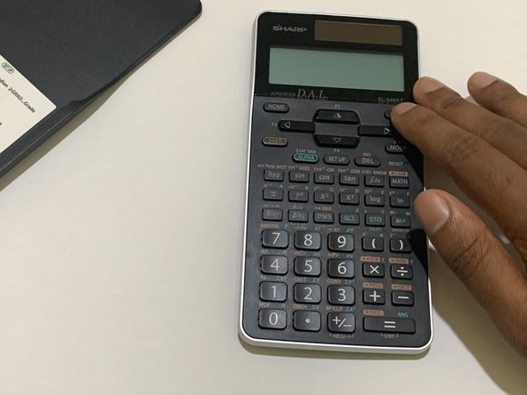

    • Remove the calculator cover if you had it on.
    • Turn off the calculator using the 2nd F button then clicking the ON button.
  3. Sharp EL-546XT Battery Replacement: crwdns2935265:03crwdnd2935265:01crwdnd2935265:03crwdne2935265:0 Sharp EL-546XT Battery Replacement: crwdns2935265:03crwdnd2935265:02crwdnd2935265:03crwdne2935265:0 Sharp EL-546XT Battery Replacement: crwdns2935265:03crwdnd2935265:03crwdnd2935265:03crwdne2935265:0

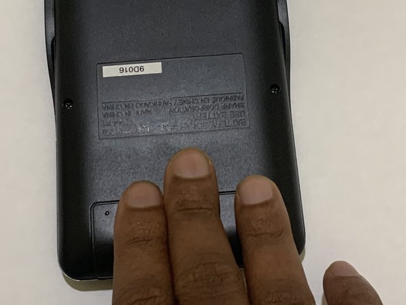

    • Put the calculator cover back on to ensure you don't accidentally press any buttons.

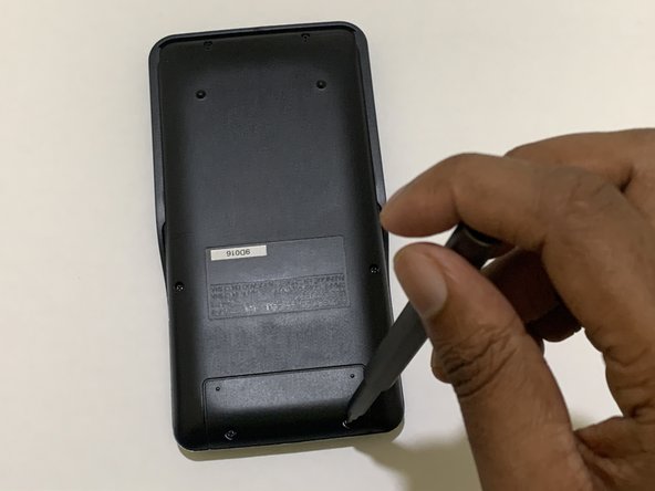

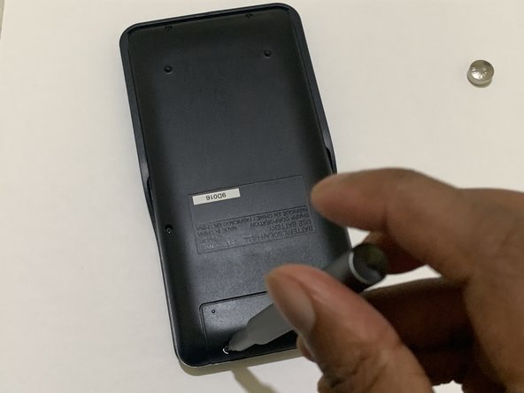

    • Remove the screws from the battery door.
    • Do not remove the other screws as they are not for the battery compartment.

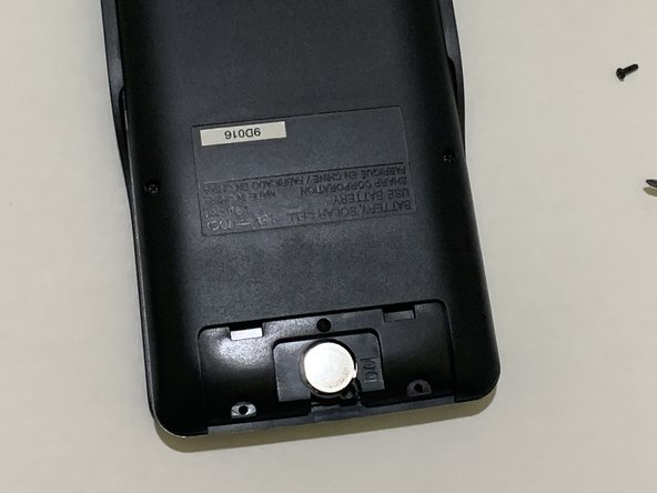

  4. Sharp EL-546XT Battery Replacement: crwdns2935265:04crwdnd2935265:01crwdnd2935265:02crwdne2935265:0 Sharp EL-546XT Battery Replacement: crwdns2935265:04crwdnd2935265:02crwdnd2935265:02crwdne2935265:0
    • Remove the battery door from the calculator.

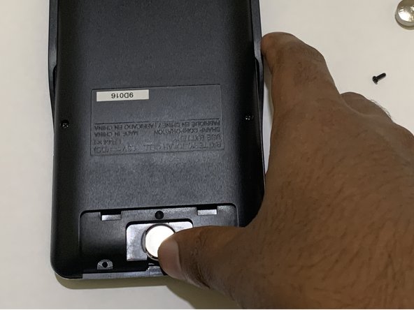

  5. Sharp EL-546XT Battery Replacement: crwdns2935265:05crwdnd2935265:01crwdnd2935265:03crwdne2935265:0 Sharp EL-546XT Battery Replacement: crwdns2935265:05crwdnd2935265:02crwdnd2935265:03crwdne2935265:0 Sharp EL-546XT Battery Replacement: crwdns2935265:05crwdnd2935265:03crwdnd2935265:03crwdne2935265:0

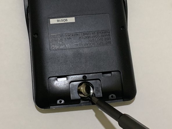

    • Use a spudger to gently push the coin battery out through the small hole located below the battery.
    • Be careful not to apply too much force when pushing the old battery out to avoid damaging the calculator or the battery compartment.

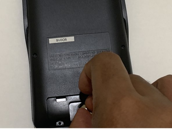

  6. Sharp EL-546XT Battery Replacement: crwdns2935265:06crwdnd2935265:01crwdnd2935265:03crwdne2935265:0 Sharp EL-546XT Battery Replacement: crwdns2935265:06crwdnd2935265:02crwdnd2935265:03crwdne2935265:0 Sharp EL-546XT Battery Replacement: crwdns2935265:06crwdnd2935265:03crwdnd2935265:03crwdne2935265:0

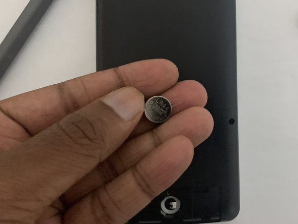

    • Gently insert the new battery into the battery compartment.
    • Handle the new batteries with care.

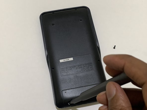

  8. Sharp EL-546XT Battery Replacement: crwdns2935265:08crwdnd2935265:01crwdnd2935265:03crwdne2935265:0 Sharp EL-546XT Battery Replacement: crwdns2935265:08crwdnd2935265:02crwdnd2935265:03crwdne2935265:0 Sharp EL-546XT Battery Replacement: crwdns2935265:08crwdnd2935265:03crwdnd2935265:03crwdne2935265:0
    • Attach the screws back to the battery door.
  9. Sharp EL-546XT Battery Replacement: crwdns2935265:09crwdnd2935265:01crwdnd2935265:03crwdne2935265:0 Sharp EL-546XT Battery Replacement: crwdns2935265:09crwdnd2935265:02crwdnd2935265:03crwdne2935265:0 Sharp EL-546XT Battery Replacement: crwdns2935265:09crwdnd2935265:03crwdnd2935265:03crwdne2935265:0
    • Take the calculator out of the cover.
    • Turn on the calculator and test if it's functioning.
