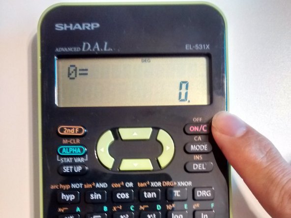

  3. Sharp EL-531X Battery Replacement, Turn the calculator off: crwdns2935265:03crwdnd2935265:01crwdnd2935265:03crwdne2935265:0 Sharp EL-531X Battery Replacement, Turn the calculator off: crwdns2935265:03crwdnd2935265:02crwdnd2935265:03crwdne2935265:0 Sharp EL-531X Battery Replacement, Turn the calculator off: crwdns2935265:03crwdnd2935265:03crwdnd2935265:03crwdne2935265:0
    • Remove the grey protective case and set aside.
    • Press the orange <2nd F> button, located in the top-left corner of the keyboard.
    • Press the pink <ON/C> button, located in the top-right corner of the keyboard.
    • Flip the device over so the green backing and battery door face up.

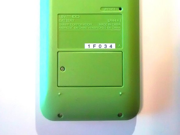

  4. Sharp EL-531X Battery Replacement, Remove the battery door screw: crwdns2935265:04crwdnd2935265:01crwdnd2935265:02crwdne2935265:0 Sharp EL-531X Battery Replacement, Remove the battery door screw: crwdns2935265:04crwdnd2935265:02crwdnd2935265:02crwdne2935265:0
    • This screw is removable with the #0 Phillips screwdriver.
    • Insert the #0 Phillips screwdriver into the screw head.
    • Turn the screwdriver counterclockwise until the screw releases from the housing.
    • Carefully flip the calculator over and allow the screw to fall into the palm of your hand.
    • Note: The battery door may fall with the screw. If this is the case, place both parts into the small container for later use.
    • Place the screw into small container.

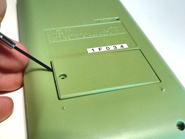

  5. Sharp EL-531X Battery Replacement, Remove the battery door (optional): crwdns2935265:05crwdnd2935265:01crwdnd2935265:03crwdne2935265:0 Sharp EL-531X Battery Replacement, Remove the battery door (optional): crwdns2935265:05crwdnd2935265:02crwdnd2935265:03crwdne2935265:0 Sharp EL-531X Battery Replacement, Remove the battery door (optional): crwdns2935265:05crwdnd2935265:03crwdnd2935265:03crwdne2935265:0
    • If the battery door sticks, use the 1.5 mm flat blade screwdriver or prying tool to CAREFULLY and GENTLY pull up on the left side of the door.
    • Remove the battery door and place in small container.

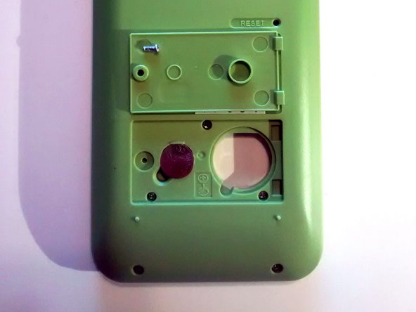

  6. Sharp EL-531X Battery Replacement, Remove the battery: crwdns2935265:06crwdnd2935265:01crwdnd2935265:02crwdne2935265:0 Sharp EL-531X Battery Replacement, Remove the battery: crwdns2935265:06crwdnd2935265:02crwdnd2935265:02crwdne2935265:0
    • The small LR44 battery is located on the left hand side of the battery compartment.
    • CAREFULLY insert the 1.5mm flat blade screwdriver into the small space located on the bottom left hand side of the battery.
    • GENTLY press down on the screwdriver. The battery will easily slide upward.
    • Remove the battery from the battery compartment.
    • Set battery aside to discard properly after repair.
