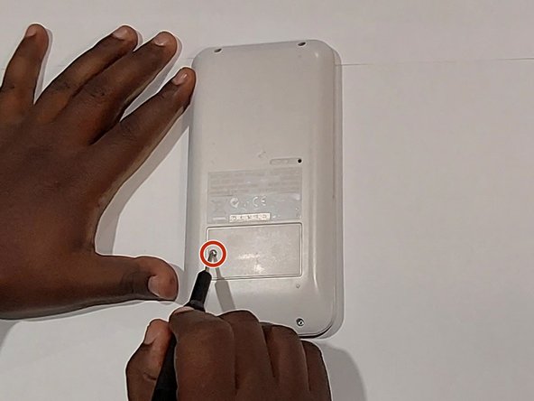

    • Remove the single screw from the battery door using a Phillips #00 screwdriver.

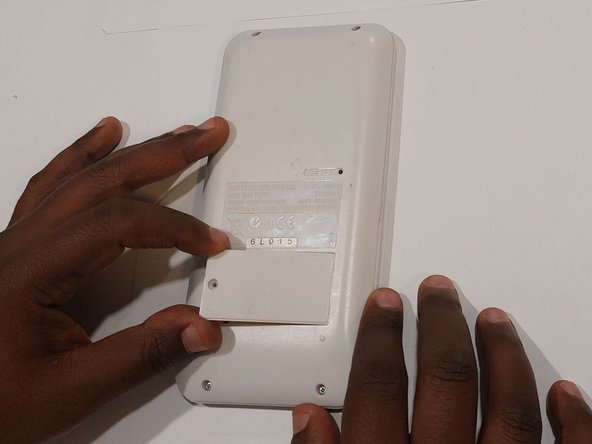

    • Remove the battery door.
