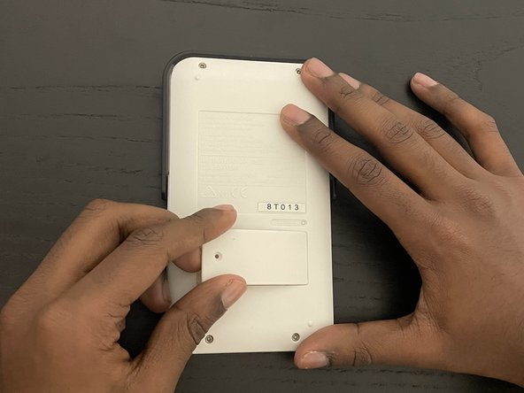

    • Find a clean workspace free of clutter.
    • Cover the calculator with the gray screen it came with. This will prevent any buttons from being pressed when it's flipped over.
  2. Sharp EL-510RN Battery Replacement: crwdns2935265:02crwdnd2935265:01crwdnd2935265:03crwdne2935265:0 Sharp EL-510RN Battery Replacement: crwdns2935265:02crwdnd2935265:02crwdnd2935265:03crwdne2935265:0 Sharp EL-510RN Battery Replacement: crwdns2935265:02crwdnd2935265:03crwdnd2935265:03crwdne2935265:0

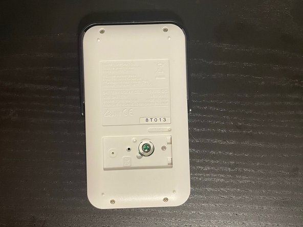

    • Flip the calculator over so the backside is facing up.
    • Use a Phillips #0 screwdriver to remove the screw securing the battery cover.
    • Use a spudger to pry open the battery cover.

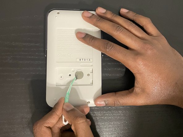

  3. Sharp EL-510RN Battery Replacement: crwdns2935265:03crwdnd2935265:01crwdnd2935265:03crwdne2935265:0 Sharp EL-510RN Battery Replacement: crwdns2935265:03crwdnd2935265:02crwdnd2935265:03crwdne2935265:0 Sharp EL-510RN Battery Replacement: crwdns2935265:03crwdnd2935265:03crwdnd2935265:03crwdne2935265:0
    • Use a spudger to pry the battery out of the back of the calculator.
    • Always use an ESD safe tool when working with batteries or delicate components such as the motherboard.

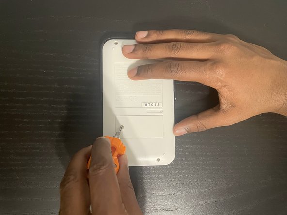

  4. Sharp EL-510RN Battery Replacement: crwdns2935265:04crwdnd2935265:01crwdnd2935265:03crwdne2935265:0 Sharp EL-510RN Battery Replacement: crwdns2935265:04crwdnd2935265:02crwdnd2935265:03crwdne2935265:0 Sharp EL-510RN Battery Replacement: crwdns2935265:04crwdnd2935265:03crwdnd2935265:03crwdne2935265:0
    • Insert the new battery into the socket.
    • Put the panel back on and screw it into place.
