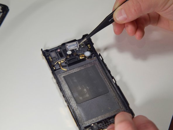

  4. Sharp Aquos Serie mini SHV31 Speaker Replacement, Speaker: crwdns2935265:04crwdnd2935265:01crwdnd2935265:02crwdne2935265:0 Sharp Aquos Serie mini SHV31 Speaker Replacement, Speaker: crwdns2935265:04crwdnd2935265:02crwdnd2935265:02crwdne2935265:0
    • On the back cover of battery casing, remove the speaker using the tweezers.
