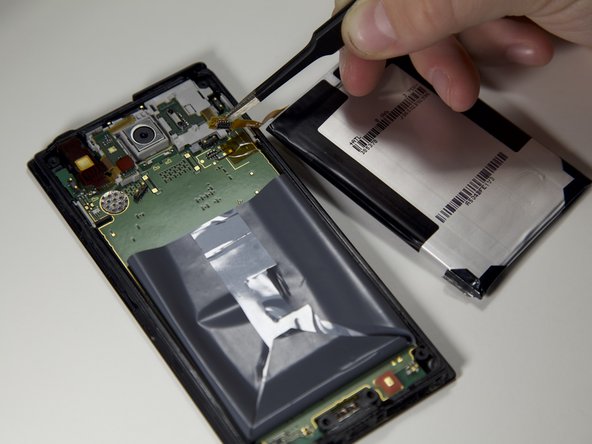

    • Begin by using a nylon spudger to pry off the back.
  2. Sharp Aquos Serie mini SHV31 Battery Replacement: crwdns2935265:02crwdnd2935265:01crwdnd2935265:02crwdne2935265:0 Sharp Aquos Serie mini SHV31 Battery Replacement: crwdns2935265:02crwdnd2935265:02crwdnd2935265:02crwdne2935265:0
    • Remove case around battery using a T5 screwdriver to remove four 5mm silver screws.
    • Remove two 6mm T5 black screws.
  3. Sharp Aquos Serie mini SHV31 Battery Replacement: crwdns2935265:03crwdnd2935265:01crwdnd2935265:01crwdne2935265:0
    • Use the tweezers to remove the pink clips on either side of the device and then take the casing off.
  4. Sharp Aquos Serie mini SHV31 Battery Replacement, Battery: crwdns2935265:04crwdnd2935265:01crwdnd2935265:01crwdne2935265:0
    • Peel back the grey paper wrapping around the battery.
  5. Sharp Aquos Serie mini SHV31 Battery Replacement: crwdns2935265:05crwdnd2935265:01crwdnd2935265:02crwdne2935265:0 Sharp Aquos Serie mini SHV31 Battery Replacement: crwdns2935265:05crwdnd2935265:02crwdnd2935265:02crwdne2935265:0
    • Use the tweezers to remove the Pancake connector that connects the battery to the phone.
