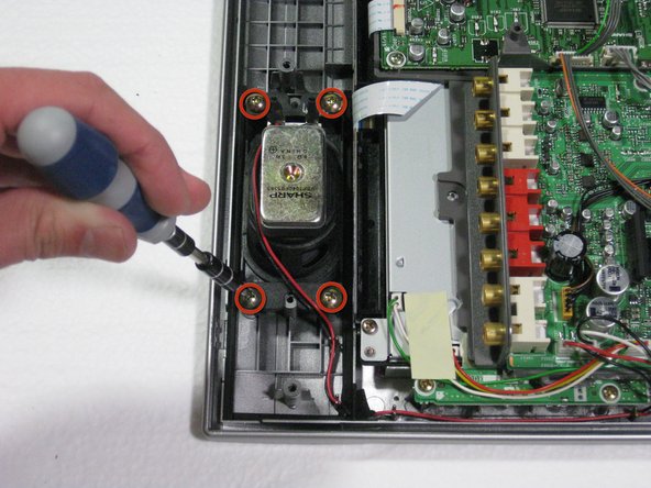

  6. Sharp Aquos LC13B2UA Speakers Replacement, Speakers: crwdns2935265:06crwdnd2935265:01crwdnd2935265:02crwdne2935265:0 Sharp Aquos LC13B2UA Speakers Replacement, Speakers: crwdns2935265:06crwdnd2935265:02crwdnd2935265:02crwdne2935265:0
    • Remove the eight 9mm screws from both speakers.
    • Do not remove the speakers yet—they are still attached.

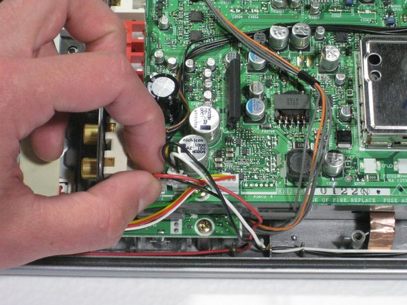

  7. Sharp Aquos LC13B2UA Speakers Replacement: crwdns2935265:07crwdnd2935265:01crwdnd2935265:02crwdne2935265:0 Sharp Aquos LC13B2UA Speakers Replacement: crwdns2935265:07crwdnd2935265:02crwdnd2935265:02crwdne2935265:0
    • Remove the two speaker cables from the circuit board by pinching the plastic connectors and firmly pulling up.
    • Pull on the plastic part of the connector, even though it may seem easiest to pull on the wires.
  8. Sharp Aquos LC13B2UA Speakers Replacement: crwdns2935265:08crwdnd2935265:01crwdnd2935265:02crwdne2935265:0 Sharp Aquos LC13B2UA Speakers Replacement: crwdns2935265:08crwdnd2935265:02crwdnd2935265:02crwdne2935265:0
    • Remove the two black tape strips (one on each side) securing the power cable to the frame.
    • The speakers can now be removed.
