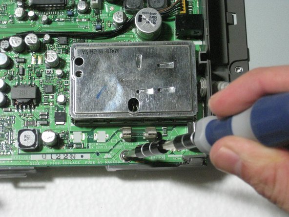

  4. Sharp Aquos LC13B2UA LCD Replacement: crwdns2935265:04crwdnd2935265:01crwdnd2935265:02crwdne2935265:0 Sharp Aquos LC13B2UA LCD Replacement: crwdns2935265:04crwdnd2935265:02crwdnd2935265:02crwdne2935265:0
    • Using a Phillips #2 screwdriver, remove the eight 6mm Phillips screws located around the edge.
    • Using a Phillips #2 screwdriver, remove the two 6mm Phillips screws located near the inputs.

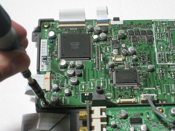

  11. Sharp Aquos LC13B2UA LCD Replacement: crwdns2935265:011crwdnd2935265:01crwdnd2935265:03crwdne2935265:0 Sharp Aquos LC13B2UA LCD Replacement: crwdns2935265:011crwdnd2935265:02crwdnd2935265:03crwdne2935265:0 Sharp Aquos LC13B2UA LCD Replacement: crwdns2935265:011crwdnd2935265:03crwdnd2935265:03crwdne2935265:0
    • Remove the three 5mm Philips screws attaching the circuit board to the LCD.
    • Remove the five 6mm Phillips screws from the edges of the circuit board attacking it to the LCD.

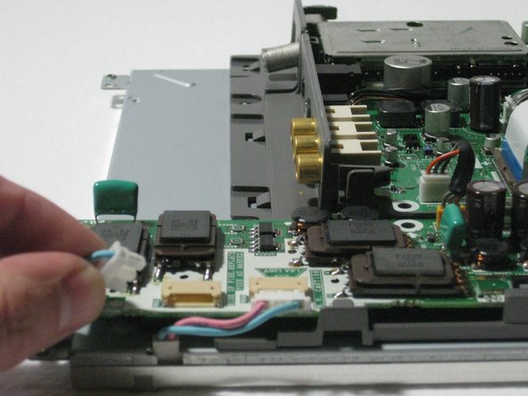

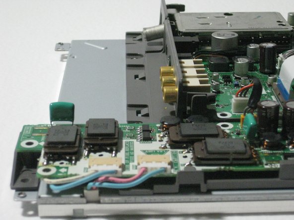

  12. Sharp Aquos LC13B2UA LCD Replacement: crwdns2935265:012crwdnd2935265:01crwdnd2935265:03crwdne2935265:0 Sharp Aquos LC13B2UA LCD Replacement: crwdns2935265:012crwdnd2935265:02crwdnd2935265:03crwdne2935265:0 Sharp Aquos LC13B2UA LCD Replacement: crwdns2935265:012crwdnd2935265:03crwdnd2935265:03crwdne2935265:0
    • Turn the circuit board so the blue and pink side cables are facing you.
    • Hold the white plastic, squeeze and pull from the sides.
    • Pull on the plastic part of the connector, even though it may seem easiest to pull on the wires.

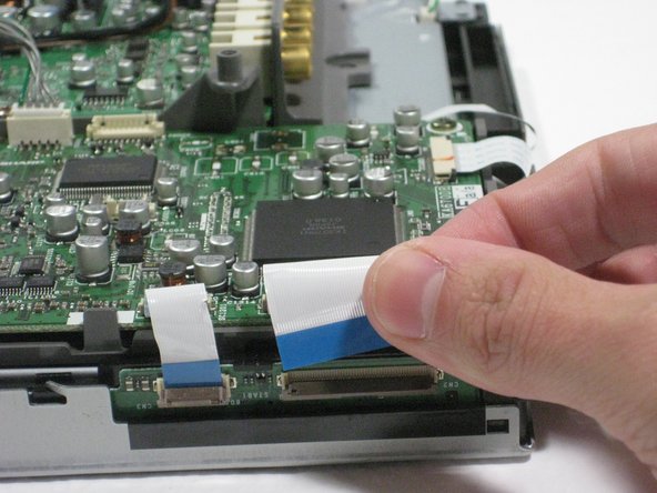

  13. Sharp Aquos LC13B2UA LCD Replacement: crwdns2935265:013crwdnd2935265:01crwdnd2935265:03crwdne2935265:0 Sharp Aquos LC13B2UA LCD Replacement: crwdns2935265:013crwdnd2935265:02crwdnd2935265:03crwdne2935265:0 Sharp Aquos LC13B2UA LCD Replacement: crwdns2935265:013crwdnd2935265:03crwdnd2935265:03crwdne2935265:0
    • Turn the television so the right hand side is facing you.
    • To remove the ribbon cables, fold the brown casing down and pull directly upward on the ribbon.
    • Turn the television so the left hand side is facing you, and remove the ribbon cable in the same manner.

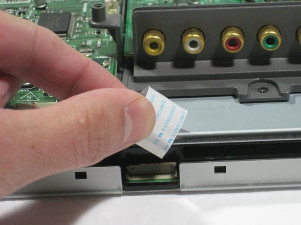

  14. Sharp Aquos LC13B2UA LCD Replacement: crwdns2935265:014crwdnd2935265:01crwdnd2935265:03crwdne2935265:0 Sharp Aquos LC13B2UA LCD Replacement: crwdns2935265:014crwdnd2935265:02crwdnd2935265:03crwdne2935265:0 Sharp Aquos LC13B2UA LCD Replacement: crwdns2935265:014crwdnd2935265:03crwdnd2935265:03crwdne2935265:0
    • Turn the circuit board so that the left side is facing you.
    • Detach the data cable from the circuit board.
    • To do this, slide your finger nail from the middle of the connector until the little black tabs rotates down toward the board as shown in the second picture.
