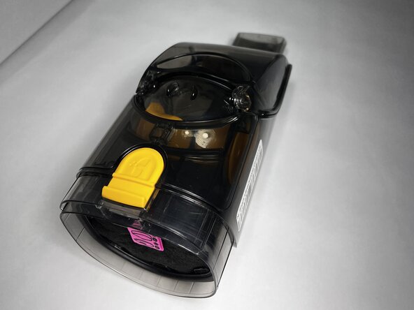

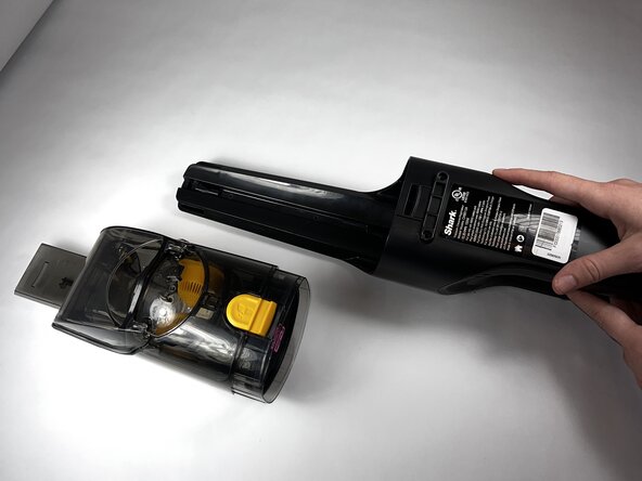

    • Press the dust cup release button and gently pull the dust cup away from the body of the vacuum.

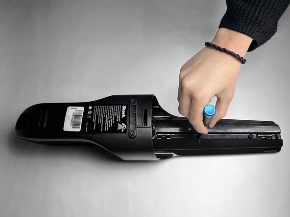

  3. Shark UltraCyclone CH951 U4 Motor Replacement: crwdns2935265:03crwdnd2935265:01crwdnd2935265:01crwdne2935265:0
    • Remove the two 12.2 mm screws underneath the dust cup button using a TR9 Torx screwdriver.
  4. Shark UltraCyclone CH951 U4 Motor Replacement: crwdns2935265:04crwdnd2935265:01crwdnd2935265:01crwdne2935265:0
    • Remove the 13.9 mm screw beneath the charging port using a TR9 Torx screwdriver.
  5. Shark UltraCyclone CH951 U4 Motor Replacement: crwdns2935265:05crwdnd2935265:01crwdnd2935265:01crwdne2935265:0
    • Use the TR9 Torx screwdriver to remove two 11.6 mm screws that hold the exterior motor in place.
    • They are located underneath where the dust cup previously was and above the exterior motor.

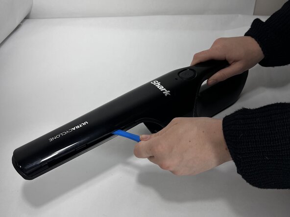

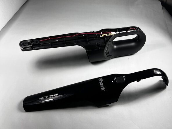

    • Run an iFixit Opening Tool under the casing along the vacuum body until the shell is removed starting around the attachment port, and sliding down towards the charging port.
    • If necessary, apply gentle force.

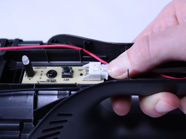

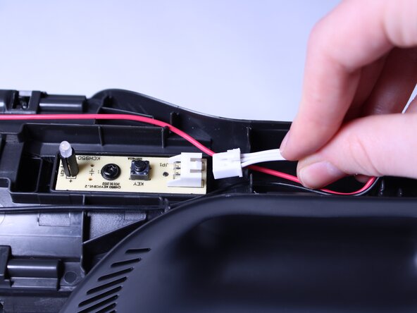

  7. Shark UltraCyclone CH951 U4 Motor Replacement, Motor: crwdns2935265:07crwdnd2935265:01crwdnd2935265:03crwdne2935265:0 Shark UltraCyclone CH951 U4 Motor Replacement, Motor: crwdns2935265:07crwdnd2935265:02crwdnd2935265:03crwdne2935265:0 Shark UltraCyclone CH951 U4 Motor Replacement, Motor: crwdns2935265:07crwdnd2935265:03crwdnd2935265:03crwdne2935265:0
    • Press down on the connection point of the white wire and disconnect it.
    • The connector looks like a white latch. Push down on the edge to pop it out of place.

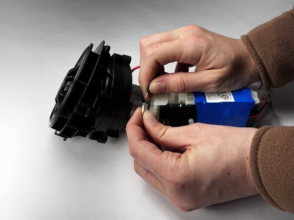

  8. Shark UltraCyclone CH951 U4 Motor Replacement: crwdns2935265:08crwdnd2935265:01crwdnd2935265:03crwdne2935265:0 Shark UltraCyclone CH951 U4 Motor Replacement: crwdns2935265:08crwdnd2935265:02crwdnd2935265:03crwdne2935265:0 Shark UltraCyclone CH951 U4 Motor Replacement: crwdns2935265:08crwdnd2935265:03crwdnd2935265:03crwdne2935265:0

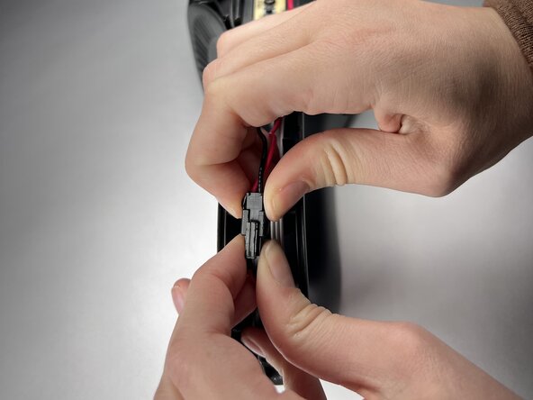

    • Disconnect the red wire by squeezing each side and gently pulling the two sides apart.

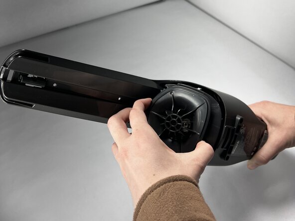

    • Gently pull on the exterior motor.
    • The wires that were previously disconnected will be attached and will need to pass through the handle of the vacuum. Complete this step carefully so that no damage is done.

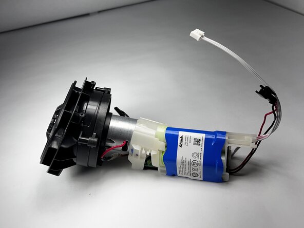

    • Remove the exterior motor, attached to the interior motor and battery.

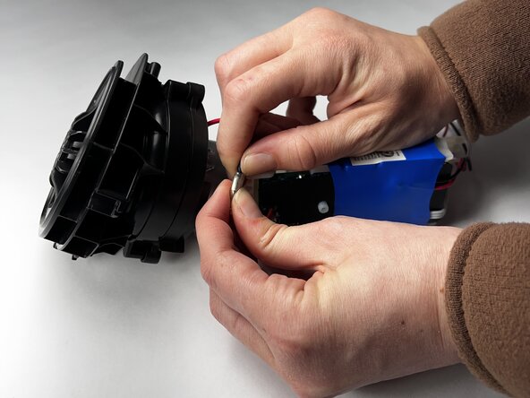

  10. Shark UltraCyclone CH951 U4 Motor Replacement: crwdns2935265:010crwdnd2935265:01crwdnd2935265:03crwdne2935265:0 Shark UltraCyclone CH951 U4 Motor Replacement: crwdns2935265:010crwdnd2935265:02crwdnd2935265:03crwdne2935265:0 Shark UltraCyclone CH951 U4 Motor Replacement: crwdns2935265:010crwdnd2935265:03crwdnd2935265:03crwdne2935265:0

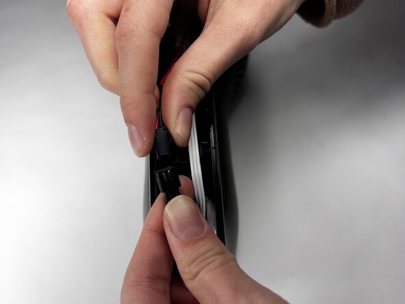

    • Squeeze the translucent rubber cover on the two wires and gently pull apart to disconnect both of them.
  11. Shark UltraCyclone CH951 U4 Motor Replacement: crwdns2935265:011crwdnd2935265:01crwdnd2935265:01crwdne2935265:0
    • When buying a replacement, most will come attached to a battery and new motorboard.
