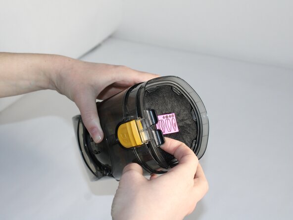

    • Press the dust cup release button and gently pull the dust cup away from the body of the vacuum.

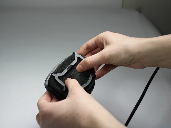

    • Place your fingers under the black tab on the plastic holder. Gently pull towards you.
    • The entire component should come out.

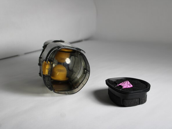

    • Gently pull on the pink tag tab to remove the covering.

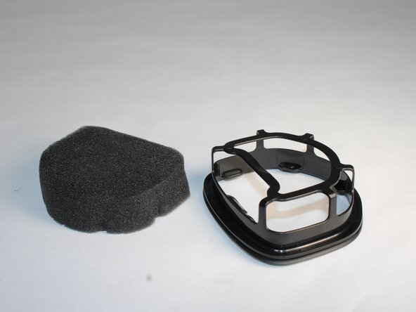

    • Rotate the component, and gently push from the bottom to dislodge the filter from the plastic holder.
    • Clean the filter if there is dirt or debris that is clogging the suction by running it under water and letting it dry completely before reassembling.
    • Replace the component if there is a defect.
