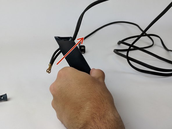

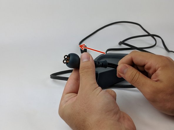

  3. Shark Ultimate Professional Power Cord Replacement: crwdns2935265:03crwdnd2935265:01crwdnd2935265:03crwdne2935265:0 Shark Ultimate Professional Power Cord Replacement: crwdns2935265:03crwdnd2935265:02crwdnd2935265:03crwdne2935265:0 Shark Ultimate Professional Power Cord Replacement: crwdns2935265:03crwdnd2935265:03crwdnd2935265:03crwdne2935265:0
    • Pull the split end of the power cord upward through the ball joint of the iron.
    • Pull the rubber stopper through the split end of the wire.
    • Pull the wire through the plastic cover.
