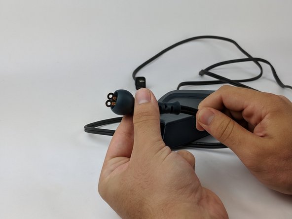

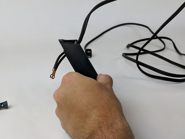

  3. Shark Ultimate Professional Mode Display Replacement: crwdns2935265:03crwdnd2935265:01crwdnd2935265:03crwdne2935265:0 Shark Ultimate Professional Mode Display Replacement: crwdns2935265:03crwdnd2935265:02crwdnd2935265:03crwdne2935265:0 Shark Ultimate Professional Mode Display Replacement: crwdns2935265:03crwdnd2935265:03crwdnd2935265:03crwdne2935265:0
    • Pull the split end of the power cord upward through the ball joint of the iron.
    • Set aside the power cord.

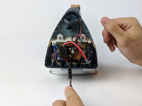

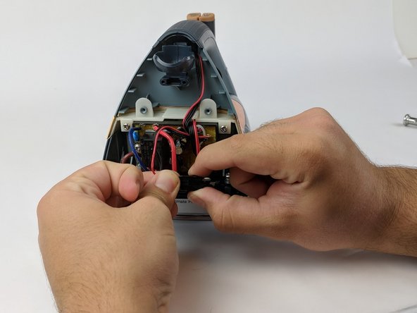

  4. Shark Ultimate Professional Mode Display Replacement: crwdns2935265:04crwdnd2935265:01crwdnd2935265:03crwdne2935265:0 Shark Ultimate Professional Mode Display Replacement: crwdns2935265:04crwdnd2935265:02crwdnd2935265:03crwdne2935265:0 Shark Ultimate Professional Mode Display Replacement: crwdns2935265:04crwdnd2935265:03crwdnd2935265:03crwdne2935265:0
    • Use the Philips head #0 screwdriver to remove remaining 6.58mm screws that hold a wire on the bottom (brown and blue).
    • Unscrew from left to right.
    • Wires order (from left to right): Brown, Blue, Black, Red
    • Unclip the black adapter piece on the bottom right.
  5. Shark Ultimate Professional Mode Display Replacement: crwdns2935265:05crwdnd2935265:01crwdnd2935265:02crwdne2935265:0 Shark Ultimate Professional Mode Display Replacement: crwdns2935265:05crwdnd2935265:02crwdnd2935265:02crwdne2935265:0
    • Use the Philips head #0 screwdriver to remove two 9.75mm screws (left and right) affixed to circuit board.

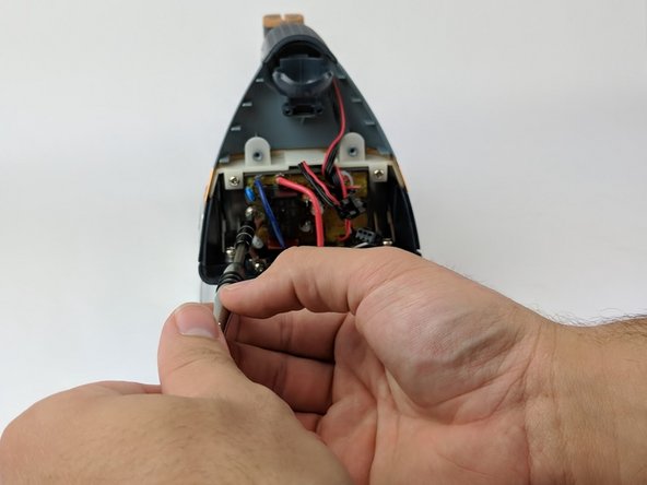

  6. Shark Ultimate Professional Mode Display Replacement: crwdns2935265:06crwdnd2935265:01crwdnd2935265:02crwdne2935265:0 Shark Ultimate Professional Mode Display Replacement: crwdns2935265:06crwdnd2935265:02crwdnd2935265:02crwdne2935265:0
    • Use the Philips head #0 screwdriver to remove the two 9.82mm screws (left and right) from the white border on top of the circuit board.
    • Pull the circuit board out from its affixed position.

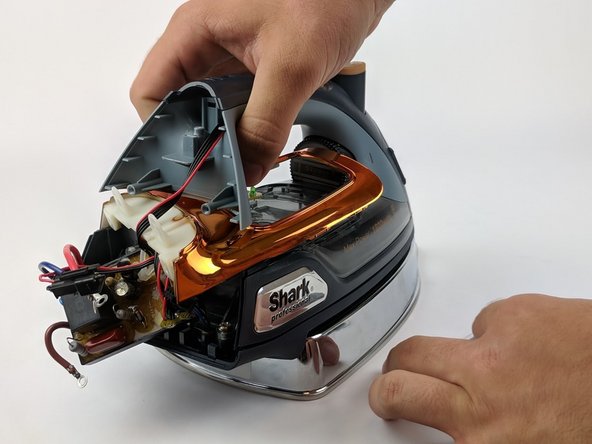

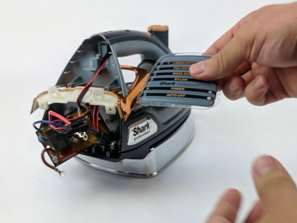

  7. Shark Ultimate Professional Mode Display Replacement: crwdns2935265:07crwdnd2935265:01crwdnd2935265:03crwdne2935265:0 Shark Ultimate Professional Mode Display Replacement: crwdns2935265:07crwdnd2935265:02crwdnd2935265:03crwdne2935265:0 Shark Ultimate Professional Mode Display Replacement: crwdns2935265:07crwdnd2935265:03crwdnd2935265:03crwdne2935265:0
    • Lift the handle and wiggle the plastic trim and the orange-chrome bezel out from under the handle.
    • Remove and set aside the mode display.
