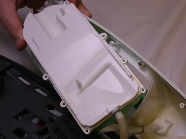

    • Start by gently moving the midframe from the top portion of the panel to expose the bottom portion of the mop's water tank / bladder.
  3. Shark Steam Pocket Mop Water Tank / Bladder Replacement: crwdns2935265:03crwdnd2935265:01crwdnd2935265:03crwdne2935265:0 Shark Steam Pocket Mop Water Tank / Bladder Replacement: crwdns2935265:03crwdnd2935265:02crwdnd2935265:03crwdne2935265:0 Shark Steam Pocket Mop Water Tank / Bladder Replacement: crwdns2935265:03crwdnd2935265:03crwdnd2935265:03crwdne2935265:0
    • Remove the 10 quarter inch phillips head screws from the bottom portion of the water tank / bladder.
    • Then gently lift the water tank / bladder out of its plastic housing. and turn it over.
    • To fully remove the water tank / bladder, use your tweezers to remove the metal ring that keeps the hose fastened to the plastic tank.
