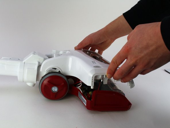

    • Push the red Lift Away button down and lift up on the vacuum handle to detach the base.
    • The handle was removed for convenience but is not required.

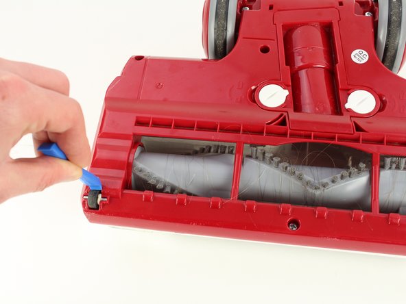

  3. Shark Rotator Slim-Light Lift-Away Upright Roller Brush Belt Replacement: crwdns2935265:03crwdnd2935265:01crwdnd2935265:02crwdne2935265:0 Shark Rotator Slim-Light Lift-Away Upright Roller Brush Belt Replacement: crwdns2935265:03crwdnd2935265:02crwdnd2935265:02crwdne2935265:0
    • Pry the small wheels at the bottom of the base using the plastic opening tool.

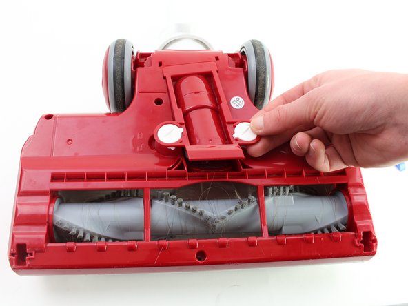

  4. Shark Rotator Slim-Light Lift-Away Upright Roller Brush Belt Replacement: crwdns2935265:04crwdnd2935265:01crwdnd2935265:02crwdne2935265:0 Shark Rotator Slim-Light Lift-Away Upright Roller Brush Belt Replacement: crwdns2935265:04crwdnd2935265:02crwdnd2935265:02crwdne2935265:0

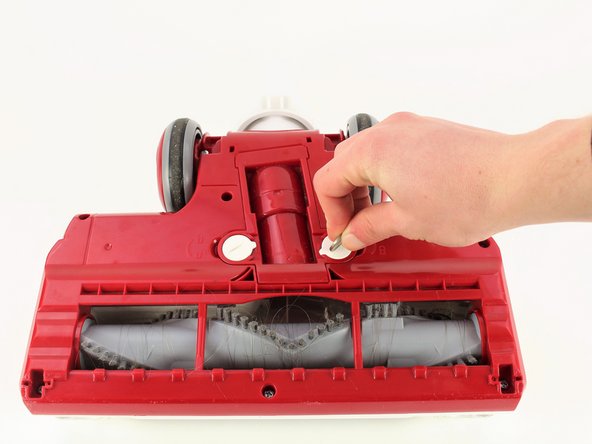

    • Using a coin, turn the big white knobs located above the roller brush counter-clockwise.

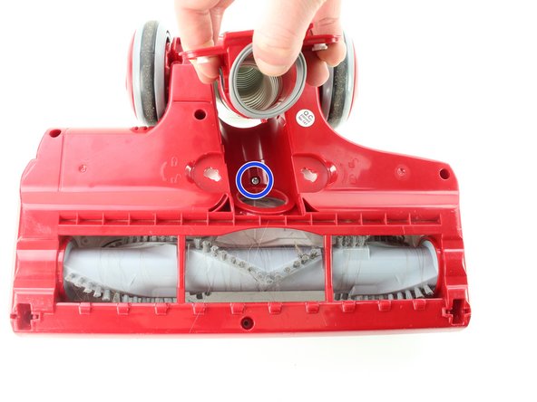

  5. Shark Rotator Slim-Light Lift-Away Upright Roller Brush Belt Replacement: crwdns2935265:05crwdnd2935265:01crwdnd2935265:03crwdne2935265:0 Shark Rotator Slim-Light Lift-Away Upright Roller Brush Belt Replacement: crwdns2935265:05crwdnd2935265:02crwdnd2935265:03crwdne2935265:0 Shark Rotator Slim-Light Lift-Away Upright Roller Brush Belt Replacement: crwdns2935265:05crwdnd2935265:03crwdnd2935265:03crwdne2935265:0
    • Lift up the suction hose to reveal a screw.
    • Remove the 12.7 mm Phillips #02 screw.

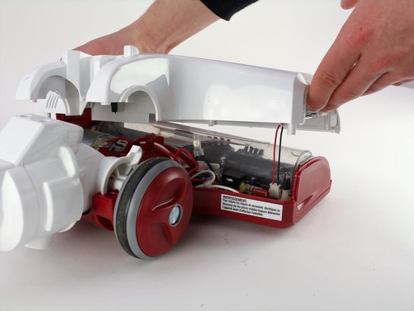

  7. Shark Rotator Slim-Light Lift-Away Upright Roller Brush Belt Replacement: crwdns2935265:07crwdnd2935265:01crwdnd2935265:03crwdne2935265:0 Shark Rotator Slim-Light Lift-Away Upright Roller Brush Belt Replacement: crwdns2935265:07crwdnd2935265:02crwdnd2935265:03crwdne2935265:0 Shark Rotator Slim-Light Lift-Away Upright Roller Brush Belt Replacement: crwdns2935265:07crwdnd2935265:03crwdnd2935265:03crwdne2935265:0
    • Turn the vacuum upright and pull the white upper section of the brush roller circuit housing.
    • Be careful when lifting the housing as there is a connector attached.

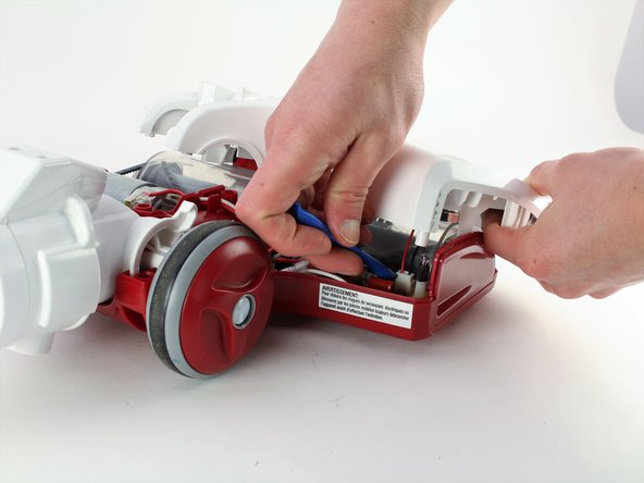

  8. Shark Rotator Slim-Light Lift-Away Upright Roller Brush Belt Replacement: crwdns2935265:08crwdnd2935265:01crwdnd2935265:02crwdne2935265:0 Shark Rotator Slim-Light Lift-Away Upright Roller Brush Belt Replacement: crwdns2935265:08crwdnd2935265:02crwdnd2935265:02crwdne2935265:0
    • Remove the connector attached to the circuit boards using a plastic opening tool.

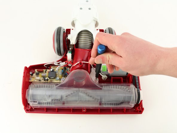

    • Remove the two 12.7 mm screws located at the top of the clear plastic brush roller housing using a Phillips #02 screwdriver.
    • Lift the clear plastic brush roller housing.

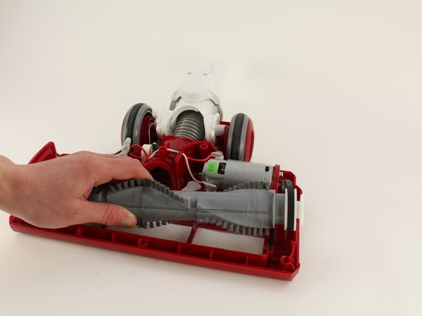

    • Wiggle the brush roller upwards from the left and right side slots.

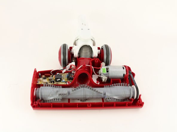

  11. Shark Rotator Slim-Light Lift-Away Upright Roller Brush Belt Replacement, Roller Brush Belt: crwdns2935265:011crwdnd2935265:01crwdnd2935265:01crwdne2935265:0
    • Remove the roller brush by sliding it out toward the left, off the belt.
  12. Shark Rotator Slim-Light Lift-Away Upright Roller Brush Belt Replacement: crwdns2935265:012crwdnd2935265:01crwdnd2935265:01crwdne2935265:0
    • Remove the belt from the motor gear by sliding the belt away from the gear and belt motor.
    • In the following picture the belt was already removed.
