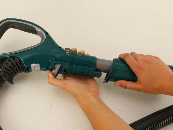

    • Press down on the hose release button and pull away from the vacuum
  2. Shark Rotator Powered Lift-Away Speed Hose Replacement: crwdns2935265:02crwdnd2935265:01crwdnd2935265:03crwdne2935265:0 Shark Rotator Powered Lift-Away Speed Hose Replacement: crwdns2935265:02crwdnd2935265:02crwdnd2935265:03crwdne2935265:0 Shark Rotator Powered Lift-Away Speed Hose Replacement: crwdns2935265:02crwdnd2935265:03crwdnd2935265:03crwdne2935265:0

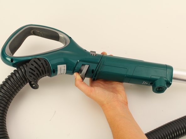

    • Press down on the wand release button and remove the wand from the vacuum.
  3. Shark Rotator Powered Lift-Away Speed Hose Replacement: crwdns2935265:03crwdnd2935265:01crwdnd2935265:03crwdne2935265:0 Shark Rotator Powered Lift-Away Speed Hose Replacement: crwdns2935265:03crwdnd2935265:02crwdnd2935265:03crwdne2935265:0 Shark Rotator Powered Lift-Away Speed Hose Replacement: crwdns2935265:03crwdnd2935265:03crwdnd2935265:03crwdne2935265:0
    • Press down on the handle release button and pull the wand away from the vacuum.

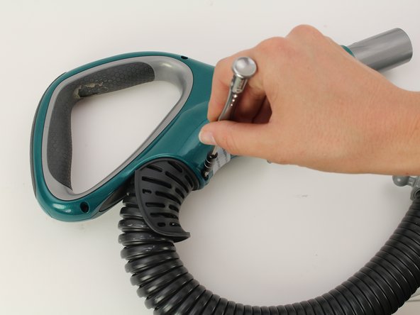

    • Remove five 13.4 mm screws from the handle with a T20 Torx bit.

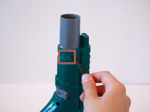

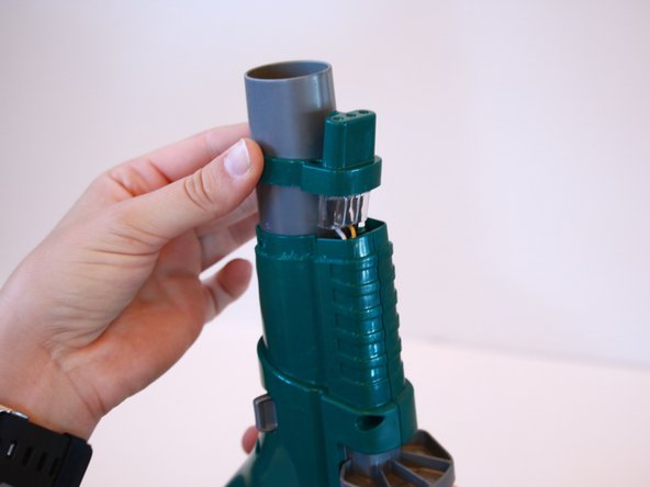

  6. Shark Rotator Powered Lift-Away Speed Hose Replacement: crwdns2935265:06crwdnd2935265:01crwdnd2935265:03crwdne2935265:0 Shark Rotator Powered Lift-Away Speed Hose Replacement: crwdns2935265:06crwdnd2935265:02crwdnd2935265:03crwdne2935265:0 Shark Rotator Powered Lift-Away Speed Hose Replacement: crwdns2935265:06crwdnd2935265:03crwdnd2935265:03crwdne2935265:0
    • Remove the neck ring by placing a spudger under the brace and lifting outwards.
    • It may be helpful to use a heat gun on the brace and then attempt removing with a spudger.

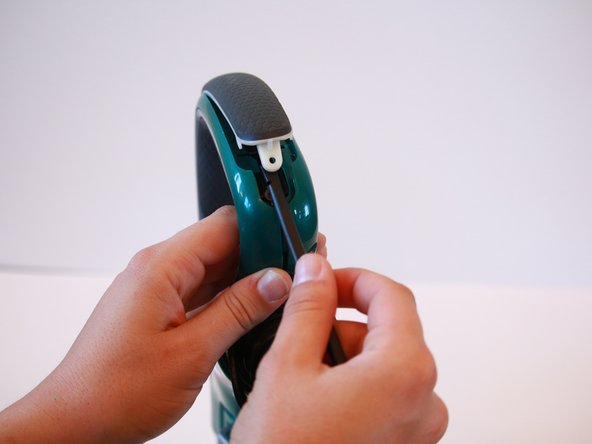

  7. Shark Rotator Powered Lift-Away Speed Hose Replacement: crwdns2935265:07crwdnd2935265:01crwdnd2935265:01crwdne2935265:0
    • Run the spudger along the center seam of the handle, pulling it apart as you go.

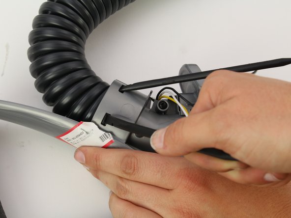

  10. Shark Rotator Powered Lift-Away Speed Hose Replacement: crwdns2935265:010crwdnd2935265:01crwdnd2935265:02crwdne2935265:0 Shark Rotator Powered Lift-Away Speed Hose Replacement: crwdns2935265:010crwdnd2935265:02crwdnd2935265:02crwdne2935265:0
    • Using two spudgers, unclip the hose from the handle.

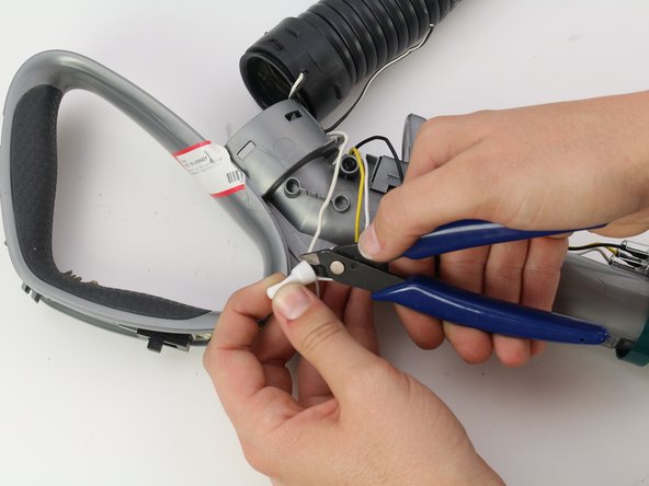

  11. Shark Rotator Powered Lift-Away Speed Hose Replacement: crwdns2935265:011crwdnd2935265:01crwdnd2935265:02crwdne2935265:0 Shark Rotator Powered Lift-Away Speed Hose Replacement: crwdns2935265:011crwdnd2935265:02crwdnd2935265:02crwdne2935265:0
    • Use wire cutters to clip the white and black wire that connect the hose to the handle.
    • Soldering or wire connectors are necessary for reassembly.
    • Any time you are dealing with electrical components, be sure the device is unplugged.
