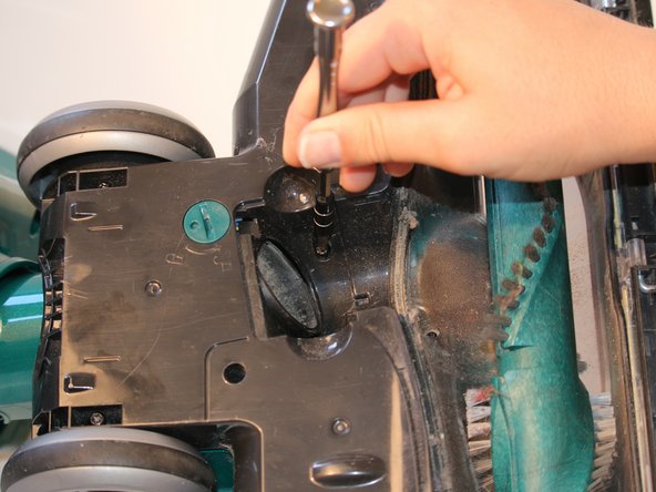

    • Flip the vacuum on its underside, and use a coin to rotate the cam-screws on the bottom panel so that their grooves are parallel with the front of the vacuum.
  2. Shark Rotator Powered Lift-Away Speed Headlight Replacement: crwdns2935265:02crwdnd2935265:01crwdnd2935265:02crwdne2935265:0 Shark Rotator Powered Lift-Away Speed Headlight Replacement: crwdns2935265:02crwdnd2935265:02crwdnd2935265:02crwdne2935265:0
    • Squeeze the sides of the roller brush cover release clasp, and swing the cover open.
  3. Shark Rotator Powered Lift-Away Speed Headlight Replacement: crwdns2935265:03crwdnd2935265:01crwdnd2935265:01crwdne2935265:0
    • Using a T20 screwdriver remove five 15.9 mm screws on the outside of the cover.
  4. Shark Rotator Powered Lift-Away Speed Headlight Replacement: crwdns2935265:04crwdnd2935265:01crwdnd2935265:02crwdne2935265:0 Shark Rotator Powered Lift-Away Speed Headlight Replacement: crwdns2935265:04crwdnd2935265:02crwdnd2935265:02crwdne2935265:0
    • Using a T20 screwdriver, remove three 13.4 mm screws from where the roller brush cover attaches to the bottom of the vacuum.

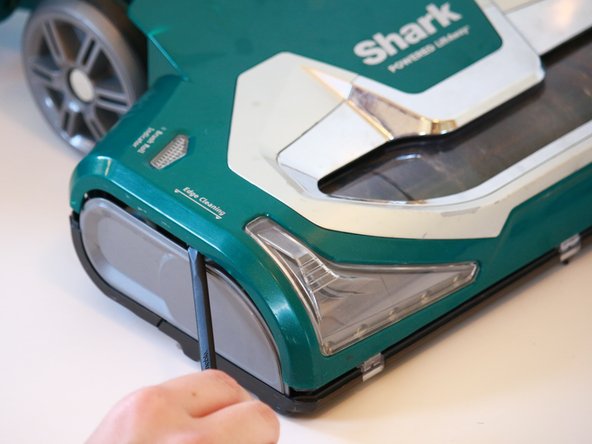

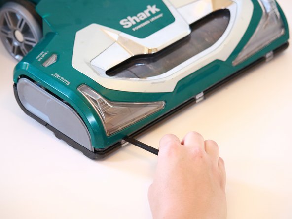

    • Flip the vacuum into the upright position, and use a spudger to open the front assembly cover by prying the seam where the colored front assembly and the grey side covers meet.
  10. Shark Rotator Powered Lift-Away Speed Headlight Replacement: crwdns2935265:010crwdnd2935265:01crwdnd2935265:01crwdne2935265:0
    • Separate the front assembly cover from the vacuum.
  11. Shark Rotator Powered Lift-Away Speed Headlight Replacement: crwdns2935265:011crwdnd2935265:01crwdnd2935265:03crwdne2935265:0 Shark Rotator Powered Lift-Away Speed Headlight Replacement: crwdns2935265:011crwdnd2935265:02crwdnd2935265:03crwdne2935265:0 Shark Rotator Powered Lift-Away Speed Headlight Replacement: crwdns2935265:011crwdnd2935265:03crwdnd2935265:03crwdne2935265:0

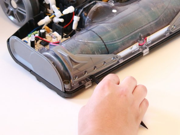

    • Use a spudger to remove the headlight covers by prying the seams where the headlight covers meet the bottom front of the vacuum.
  12. Shark Rotator Powered Lift-Away Speed Headlight Replacement: crwdns2935265:012crwdnd2935265:01crwdnd2935265:03crwdne2935265:0 Shark Rotator Powered Lift-Away Speed Headlight Replacement: crwdns2935265:012crwdnd2935265:02crwdnd2935265:03crwdne2935265:0 Shark Rotator Powered Lift-Away Speed Headlight Replacement: crwdns2935265:012crwdnd2935265:03crwdnd2935265:03crwdne2935265:0

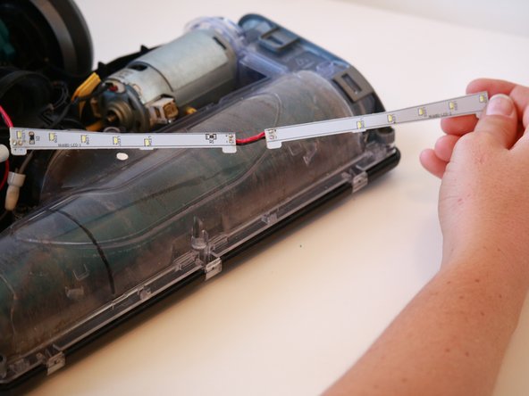

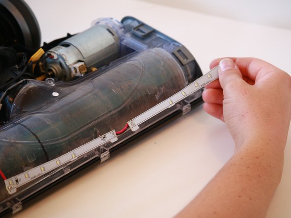

    • Pull the LED headlight strand up and away from where it is attached to the bottom front of the vacuum.
  13. Shark Rotator Powered Lift-Away Speed Headlight Replacement: crwdns2935265:013crwdnd2935265:01crwdnd2935265:03crwdne2935265:0 Shark Rotator Powered Lift-Away Speed Headlight Replacement: crwdns2935265:013crwdnd2935265:02crwdnd2935265:03crwdne2935265:0 Shark Rotator Powered Lift-Away Speed Headlight Replacement: crwdns2935265:013crwdnd2935265:03crwdnd2935265:03crwdne2935265:0

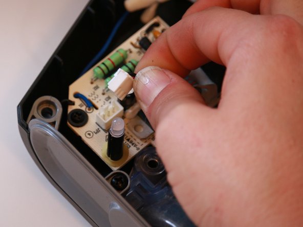

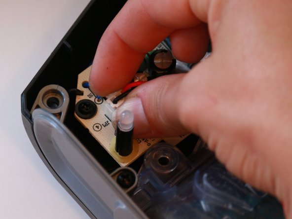

    • Pinch the tabs on the circuit board clasp for the LED headlight inwards , and pull the clasp up and away to detach the headlight.
