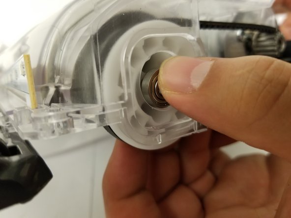

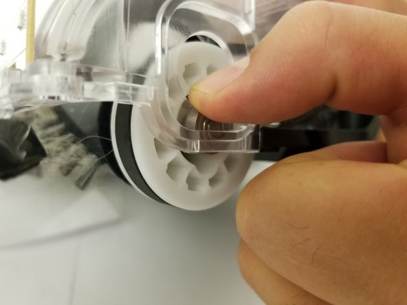

  8. Shark Rotator Powered Lift-Away Roller Brush Replacement, Roller Brush: crwdns2935265:08crwdnd2935265:01crwdnd2935265:01crwdne2935265:0
    • Remove white cap with a Flathead screwdriver or any other wedge-like tool.
  9. Shark Rotator Powered Lift-Away Roller Brush Replacement: crwdns2935265:09crwdnd2935265:01crwdnd2935265:03crwdne2935265:0 Shark Rotator Powered Lift-Away Roller Brush Replacement: crwdns2935265:09crwdnd2935265:02crwdnd2935265:03crwdne2935265:0 Shark Rotator Powered Lift-Away Roller Brush Replacement: crwdns2935265:09crwdnd2935265:03crwdnd2935265:03crwdne2935265:0
    • Gently push piece in.
    • Pull piece down and out of the container.
  10. Shark Rotator Powered Lift-Away Roller Brush Replacement: crwdns2935265:010crwdnd2935265:01crwdnd2935265:01crwdne2935265:0
    • Turn vacuum head over to remove brush.
