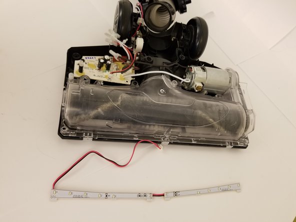

  8. Shark Rotator Powered Lift-Away Headlight Replacement, Headlights: crwdns2935265:08crwdnd2935265:01crwdnd2935265:01crwdne2935265:0
    • Detach the headlight’s red and black wires from plastic clip as shown.
  9. Shark Rotator Powered Lift-Away Headlight Replacement: crwdns2935265:09crwdnd2935265:01crwdnd2935265:01crwdne2935265:0
    • Follow the headlight’s red and black wires to the circuit board.
  10. Shark Rotator Powered Lift-Away Headlight Replacement: crwdns2935265:010crwdnd2935265:01crwdnd2935265:01crwdne2935265:0
    • Unclip the 2-pin electrical connector by pressing the tab then lift up.
  11. Shark Rotator Powered Lift-Away Headlight Replacement: crwdns2935265:011crwdnd2935265:01crwdnd2935265:02crwdne2935265:0 Shark Rotator Powered Lift-Away Headlight Replacement: crwdns2935265:011crwdnd2935265:02crwdnd2935265:02crwdne2935265:0
    • Carefully lift the headlights and its wires from the vacuum assembly.

Shark sent a brand new replacement nozzle to me (covered in their 5yr warranty) but head lights STILL DO NOT WORK - which makes me wonder where else the issue could be because the above “fix” would not have fixed my vacuum head lights.
Ginger Myrick - crwdns2934203:0crwdne2934203:0
These steps are great, but how do you ACTUALLY replace the led light strip itself? Do u need a special strip? Just any led strip? U left a few more steps out. Is like to replace mine instead of buying a whole new vacuum head.
