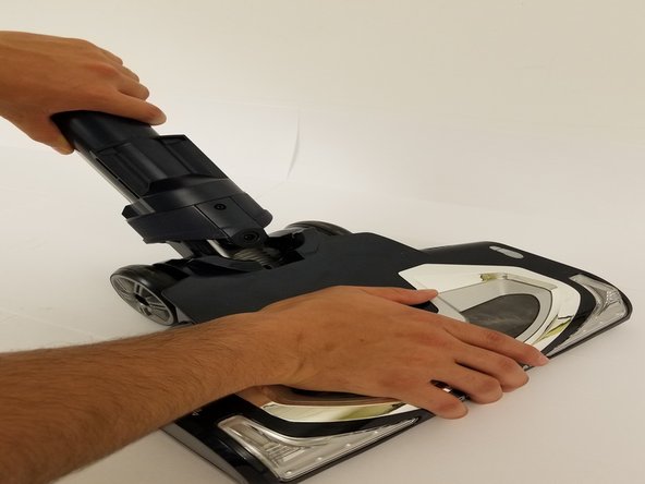

    • Push the lift away button and pull the handle up to separate the body from the wand section.
  2. Shark Rotator Powered Lift-Away Brush Belt Replacement: crwdns2935265:02crwdnd2935265:01crwdnd2935265:01crwdne2935265:0
    • Push lift away button on the wand then lift up on the top section to separate.
  3. Shark Rotator Powered Lift-Away Brush Belt Replacement: crwdns2935265:03crwdnd2935265:01crwdnd2935265:02crwdne2935265:0 Shark Rotator Powered Lift-Away Brush Belt Replacement: crwdns2935265:03crwdnd2935265:02crwdnd2935265:02crwdne2935265:0
    • Tilt the wand shaft backwards for convenient.

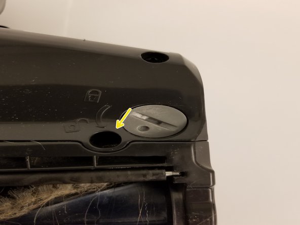

    • Lay the head nozzle piece upside down.
    • Rotate the three gray taps to the unlock position.

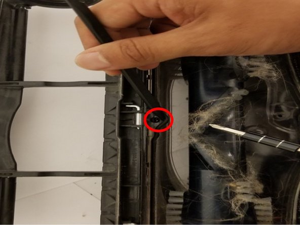

    • Remove the 13 screws (circled in yellow) using a phillips screwdriver.
    • Be sure to keep track of which screws go into which hole.
    • Remove the one screw (circled in red) that has a Torx head (might be Phillips head on some models).
    • The Torx screw is hidden under a rubber gasket. Carefully, lift up the gasket without damaging it to access this screw.
    • Remove the horizontal screw (circled in orange) that attaches the gray side panel (necessary to remove the white cap on the roller brush in step 8)

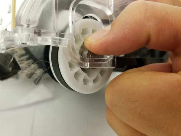

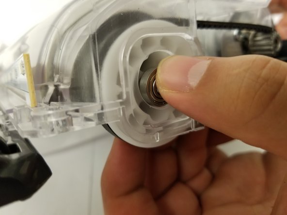

    • Gently press in on brush to detach.
    • Pull brush down and out.
  10. Shark Rotator Powered Lift-Away Brush Belt Replacement: crwdns2935265:010crwdnd2935265:01crwdnd2935265:01crwdne2935265:0
    • Slide the belt off of the gear.
