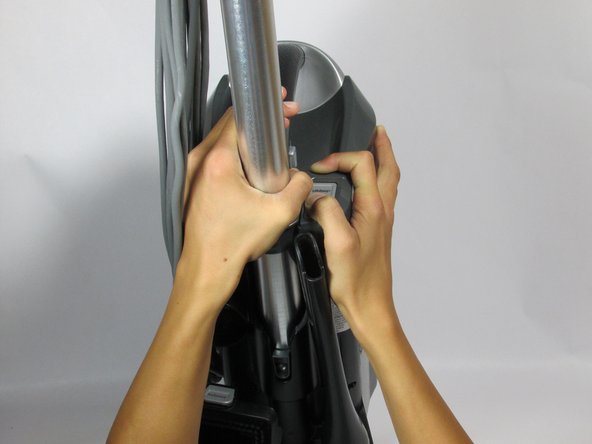

    • Make sure the vacuum is turned off and unplugged before proceeding.
    • Place the vacuum upright and locate the attachment you want removed.
  2. Shark Rotator Lift-Away Speed Vacuum Hose and Wand Accessory Replacement: crwdns2935265:02crwdnd2935265:01crwdnd2935265:03crwdne2935265:0 Shark Rotator Lift-Away Speed Vacuum Hose and Wand Accessory Replacement: crwdns2935265:02crwdnd2935265:02crwdnd2935265:03crwdne2935265:0 Shark Rotator Lift-Away Speed Vacuum Hose and Wand Accessory Replacement: crwdns2935265:02crwdnd2935265:03crwdnd2935265:03crwdne2935265:0
    • Slide the attachments off of the end of the wand.
    • Some attachments may have a "Release" button--if so, hold down the button while sliding the attachment off.
    • The back of the vacuum has slots to hold up to two vacuum attachments. To store, simply place the attachment onto the circular slots.
  3. Shark Rotator Lift-Away Speed Vacuum Hose and Wand Accessory Replacement: crwdns2935265:03crwdnd2935265:01crwdnd2935265:02crwdne2935265:0 Shark Rotator Lift-Away Speed Vacuum Hose and Wand Accessory Replacement: crwdns2935265:03crwdnd2935265:02crwdnd2935265:02crwdne2935265:0
    • Locate the button that says “Release Wand” and press down.
    • Press button while lifting upwards on the handle at the top of the wand.
  4. Shark Rotator Lift-Away Speed Vacuum Hose and Wand Accessory Replacement: crwdns2935265:04crwdnd2935265:01crwdnd2935265:02crwdne2935265:0 Shark Rotator Lift-Away Speed Vacuum Hose and Wand Accessory Replacement: crwdns2935265:04crwdnd2935265:02crwdnd2935265:02crwdne2935265:0
    • Locate the black hose on the back of the vacuum.
    • Locate the silver release levers on the top and bottom of the hose.
    • Press on the silver release levers and pull up and away from the device to release the hose.
