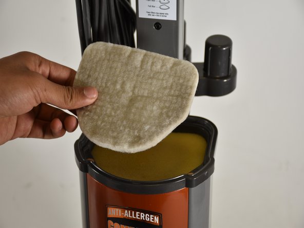

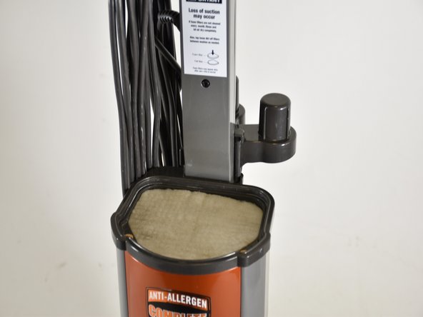

    1. Shark Rocket Professional Secondary Filters Replacement, Secondary Filters: crwdns2935265:03crwdnd2935265:01crwdnd2935265:03crwdne2935265:0 Shark Rocket Professional Secondary Filters Replacement, Secondary Filters: crwdns2935265:03crwdnd2935265:02crwdnd2935265:03crwdne2935265:0 Shark Rocket Professional Secondary Filters Replacement, Secondary Filters: crwdns2935265:03crwdnd2935265:03crwdnd2935265:03crwdne2935265:0
      • As you look beneath the base of the dust cup, you will see a white foam filter. Remove this filter with your fingers.
    2. Shark Rocket Professional Secondary Filters Replacement: crwdns2935265:04crwdnd2935265:01crwdnd2935265:01crwdne2935265:0
      • Removing the first filter will reveal a second, thicker foam filter. Remove this as well.
      • Shark recommends that you rinse and air dry these filters monthly.
      • Remember to replace the filters in the correct order.
