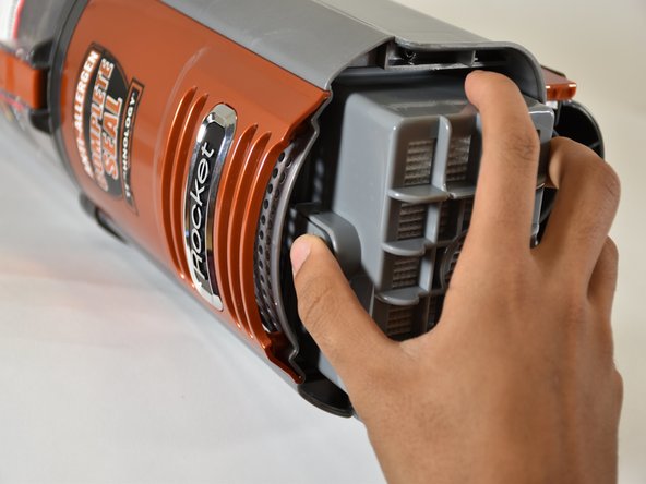

    • Look towards the side of the vacuum for the orange "Floor Nozzle" button.
    • Press the "Floor Nozzle" button and pull out the body of the vacuum up and away from the floor motor.
  2. Shark Rocket Professional HEPA Filter Replacement: crwdns2935265:02crwdnd2935265:01crwdnd2935265:03crwdne2935265:0 Shark Rocket Professional HEPA Filter Replacement: crwdns2935265:02crwdnd2935265:02crwdnd2935265:03crwdne2935265:0 Shark Rocket Professional HEPA Filter Replacement: crwdns2935265:02crwdnd2935265:03crwdnd2935265:03crwdne2935265:0
    • Locate an orange dial at the bottom of the now-separate body of the vacuum.
    • Turn the dial so that it is pointed towards the open-lock icon.

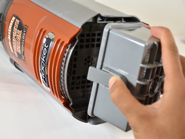

  3. Shark Rocket Professional HEPA Filter Replacement: crwdns2935265:03crwdnd2935265:01crwdnd2935265:03crwdne2935265:0 Shark Rocket Professional HEPA Filter Replacement: crwdns2935265:03crwdnd2935265:02crwdnd2935265:03crwdne2935265:0 Shark Rocket Professional HEPA Filter Replacement: crwdns2935265:03crwdnd2935265:03crwdnd2935265:03crwdne2935265:0
    • Open the cap to reveal the HEPA filter. The HEPA filter is a large grey rectangle with a tab on the side.
    • Press the tab, and pull out the filter.
