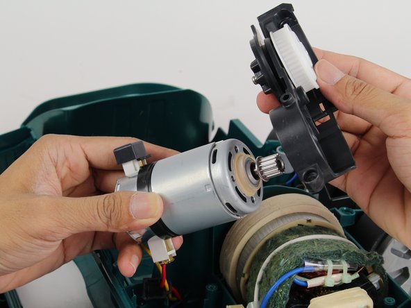

  18. Shark Rocket Powerhead AH401 Motor Replacement: crwdns2935265:018crwdnd2935265:01crwdnd2935265:02crwdne2935265:0 Shark Rocket Powerhead AH401 Motor Replacement: crwdns2935265:018crwdnd2935265:02crwdnd2935265:02crwdne2935265:0
    • Remove the belt-assembly unit by pulling the belt-assembly unit away from the motor.
  19. Shark Rocket Powerhead AH401 Motor Replacement: crwdns2935265:019crwdnd2935265:01crwdnd2935265:02crwdne2935265:0 Shark Rocket Powerhead AH401 Motor Replacement: crwdns2935265:019crwdnd2935265:02crwdnd2935265:02crwdne2935265:0

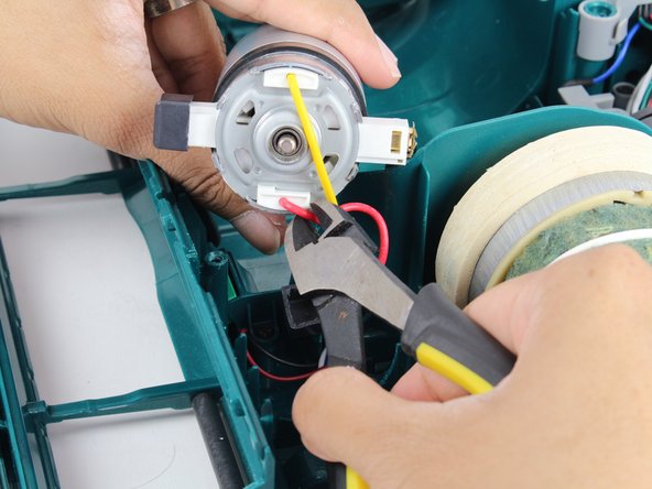

    • Rotate the motor unit over so that the wires are exposed.
    • Cut wires with cutting pliers to release the motor.
