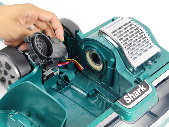

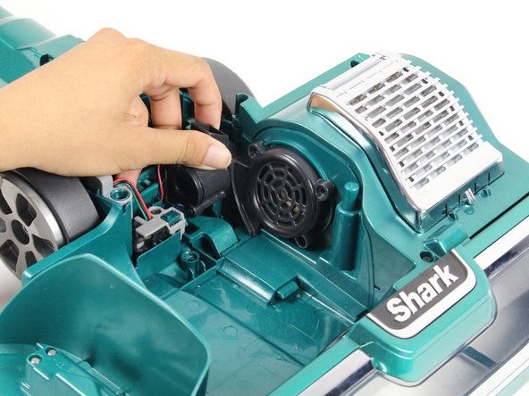

  6. Shark Rocket Powerhead AH401 Motherboard Replacement, Motherboard: crwdns2935265:06crwdnd2935265:01crwdnd2935265:03crwdne2935265:0 Shark Rocket Powerhead AH401 Motherboard Replacement, Motherboard: crwdns2935265:06crwdnd2935265:02crwdnd2935265:03crwdne2935265:0 Shark Rocket Powerhead AH401 Motherboard Replacement, Motherboard: crwdns2935265:06crwdnd2935265:03crwdnd2935265:03crwdne2935265:0
    • Remove the three 10mm screws by rotating counter clockwise with a T15 Torx screwdriver.
    • Remove the airpath grille by gently lifting up and away from the motor compartment.

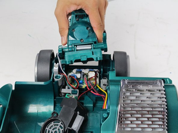

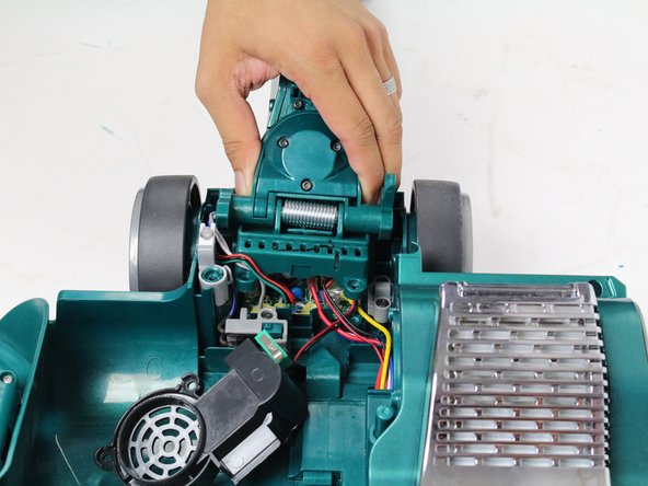

    • Lift and gently remove the hinge compartment covering the motherboard.

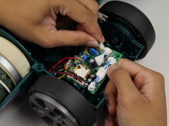

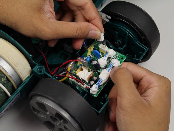

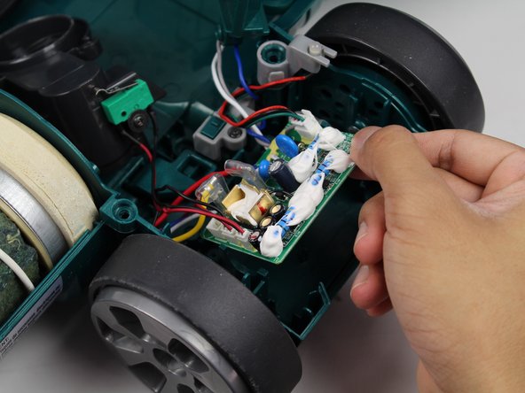

    • Lift the motherboard out of its compartment.

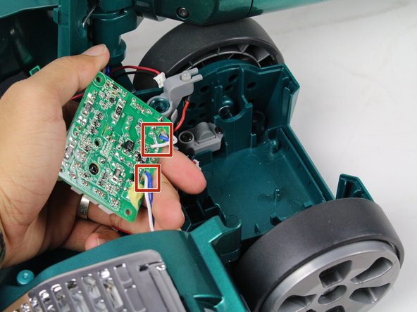

  11. Shark Rocket Powerhead AH401 Motherboard Replacement: crwdns2935265:011crwdnd2935265:01crwdnd2935265:03crwdne2935265:0 Shark Rocket Powerhead AH401 Motherboard Replacement: crwdns2935265:011crwdnd2935265:02crwdnd2935265:03crwdne2935265:0 Shark Rocket Powerhead AH401 Motherboard Replacement: crwdns2935265:011crwdnd2935265:03crwdnd2935265:03crwdne2935265:0
    • Locate and remove these connections by pulling the plugs out of the sockets.

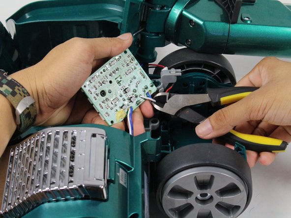

  12. Shark Rocket Powerhead AH401 Motherboard Replacement: crwdns2935265:012crwdnd2935265:01crwdnd2935265:03crwdne2935265:0 Shark Rocket Powerhead AH401 Motherboard Replacement: crwdns2935265:012crwdnd2935265:02crwdnd2935265:03crwdne2935265:0 Shark Rocket Powerhead AH401 Motherboard Replacement: crwdns2935265:012crwdnd2935265:03crwdnd2935265:03crwdne2935265:0
    • Flip the motherboard over to reveal the wires underneath.
    • Locate and cut all the wires connected to the motherboard using cutting pliers.
