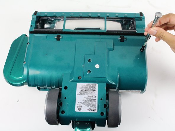

    • Flip the device over so that the bottom is face up.
    • Remove the eight screws shown by rotating counter-clockwise with a T15 Torx screwdriver.
    • Two 14 mm Torx screws
    • Two 16 mm Torx screws
    • Four 21 mm Torx screws

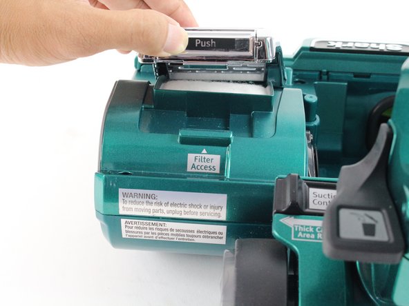

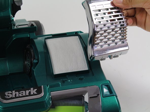

  4. Shark Rocket Powerhead AH401 Belt Replacement, Filter Grille: crwdns2935265:04crwdnd2935265:01crwdnd2935265:02crwdne2935265:0 Shark Rocket Powerhead AH401 Belt Replacement, Filter Grille: crwdns2935265:04crwdnd2935265:02crwdnd2935265:02crwdne2935265:0
    • Push inward on the top of the filter grille where it says "Push."
    • Lift the filter grille upward.
  5. Shark Rocket Powerhead AH401 Belt Replacement: crwdns2935265:05crwdnd2935265:01crwdnd2935265:02crwdne2935265:0 Shark Rocket Powerhead AH401 Belt Replacement: crwdns2935265:05crwdnd2935265:02crwdnd2935265:02crwdne2935265:0
    • Lift gently and pull the grille up towards you until it releases.
    • The post-motor filter is underneath the filter grille.

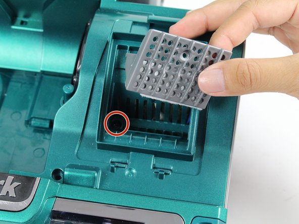

  7. Shark Rocket Powerhead AH401 Belt Replacement: crwdns2935265:07crwdnd2935265:01crwdnd2935265:03crwdne2935265:0 Shark Rocket Powerhead AH401 Belt Replacement: crwdns2935265:07crwdnd2935265:02crwdnd2935265:03crwdne2935265:0 Shark Rocket Powerhead AH401 Belt Replacement: crwdns2935265:07crwdnd2935265:03crwdnd2935265:03crwdne2935265:0
    • Remove the grey filter plate by simply lifting upward.
    • Remove the 14mm screw by rotating counter clockwise with a T10 Torx screwdriver.

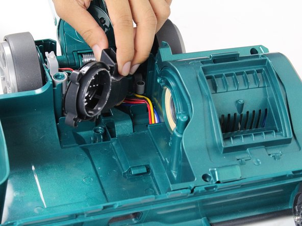

    • Remove the airpath grille from the side of the motor compartment by pulling out and away from the attached area.

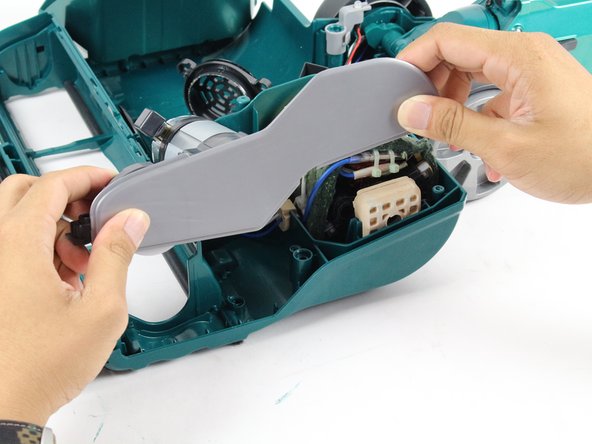

  10. Shark Rocket Powerhead AH401 Belt Replacement: crwdns2935265:010crwdnd2935265:01crwdnd2935265:02crwdne2935265:0 Shark Rocket Powerhead AH401 Belt Replacement: crwdns2935265:010crwdnd2935265:02crwdnd2935265:02crwdne2935265:0

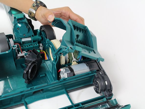

    • Remove the motor compartment panel by lifting up and away from the device.

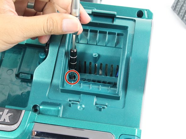

    • Remove one 14mm screw by rotating counter-clockwise with a T15 Torx screwdriver.

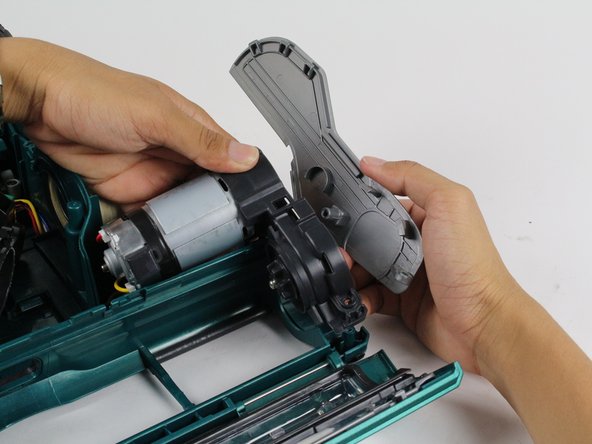

    • Remove the side panel by pulling the panel out and away from the motor.
    • The side panel is connected with clips which connect near the brushroll axle.

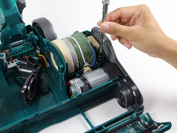

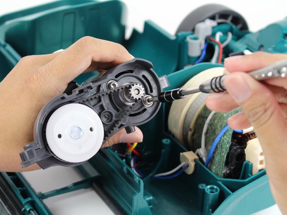

  15. Shark Rocket Powerhead AH401 Belt Replacement: crwdns2935265:015crwdnd2935265:01crwdnd2935265:02crwdne2935265:0 Shark Rocket Powerhead AH401 Belt Replacement: crwdns2935265:015crwdnd2935265:02crwdnd2935265:02crwdne2935265:0
    • Loosen the two screws by rotating counter clockwise with a T15 Torx screwdriver.
    • The screws only need to be loosened in order to free the belt.

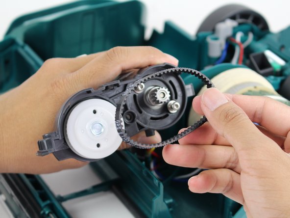

  16. Shark Rocket Powerhead AH401 Belt Replacement: crwdns2935265:016crwdnd2935265:01crwdnd2935265:02crwdne2935265:0 Shark Rocket Powerhead AH401 Belt Replacement: crwdns2935265:016crwdnd2935265:02crwdnd2935265:02crwdne2935265:0
    • Remove the belt by pulling the belt away from the axle.

These instructions were fantastic accept for one section. On Step 9 you never mention to first remove the Motor Compartment Panel before removing the airpath grille. The picture just shows the panel already removed. Otherwise, I followed the directions forwards and backwards and I was successful!! I went to the local vacuum repair store to purchase a new belt. They did not have the Shark belt so I purchased the Bissell BIBL, BELT geared 80R4, 47A2 for $3.50 and it worked perfectly!!

there is a hidden screw on the outside of the compartment/ motor side where the handle mets the motor compartment panel / in the corner iif i could leave a pic i would.
