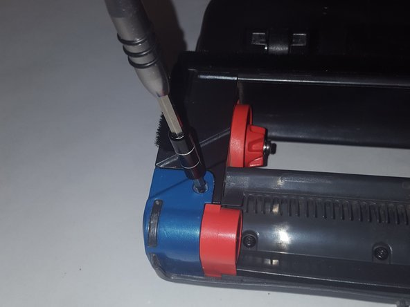

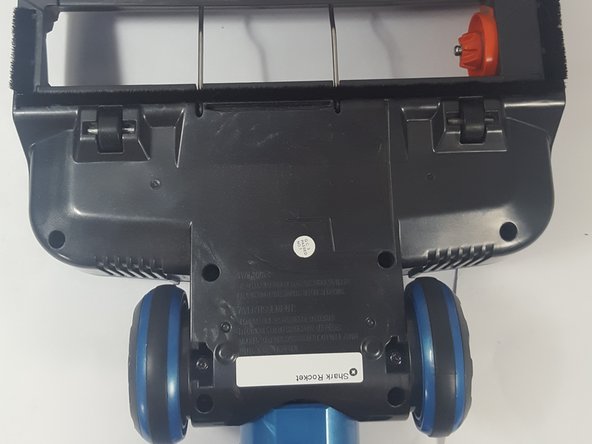

  5. Shark Rocket HV381 Motor Replacement, Wheel: crwdns2935265:05crwdnd2935265:01crwdnd2935265:02crwdne2935265:0 Shark Rocket HV381 Motor Replacement, Wheel: crwdns2935265:05crwdnd2935265:02crwdnd2935265:02crwdne2935265:0
    • On the back of the vacuum head, locate and unscrew the four T15 screws. Once done the wheels can be removed.

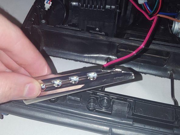

  6. Shark Rocket HV381 Motor Replacement, LED: crwdns2935265:06crwdnd2935265:01crwdnd2935265:02crwdne2935265:0 Shark Rocket HV381 Motor Replacement, LED: crwdns2935265:06crwdnd2935265:02crwdnd2935265:02crwdne2935265:0
    • On the back of the vacuum head, located near the bottom, should be a row of screws. Using the T15 Screwdriver, remove all the screws on the bottom and the sides.
  7. Shark Rocket HV381 Motor Replacement: crwdns2935265:07crwdnd2935265:01crwdnd2935265:01crwdne2935265:0
    • On the top side of the vacuum head, where the LED is located, use the Small Flathead screwdriver to pry open the cover. There should be no resistance.

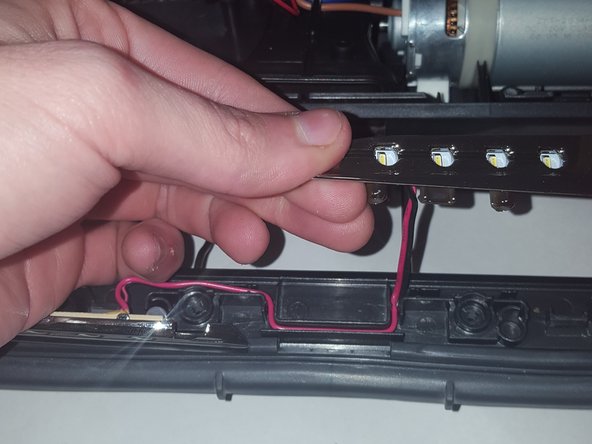

  8. Shark Rocket HV381 Motor Replacement: crwdns2935265:08crwdnd2935265:01crwdnd2935265:03crwdne2935265:0 Shark Rocket HV381 Motor Replacement: crwdns2935265:08crwdnd2935265:02crwdnd2935265:03crwdne2935265:0 Shark Rocket HV381 Motor Replacement: crwdns2935265:08crwdnd2935265:03crwdnd2935265:03crwdne2935265:0
    • Picking the LED from the side, pull upwards to unwind the wires from their tracks.
    • Make sure that you are gentle because the wires are very fragile. One strong pull could easily snap them from the LED.

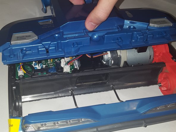

  9. Shark Rocket HV381 Motor Replacement, Motor: crwdns2935265:09crwdnd2935265:01crwdnd2935265:02crwdne2935265:0 Shark Rocket HV381 Motor Replacement, Motor: crwdns2935265:09crwdnd2935265:02crwdnd2935265:02crwdne2935265:0

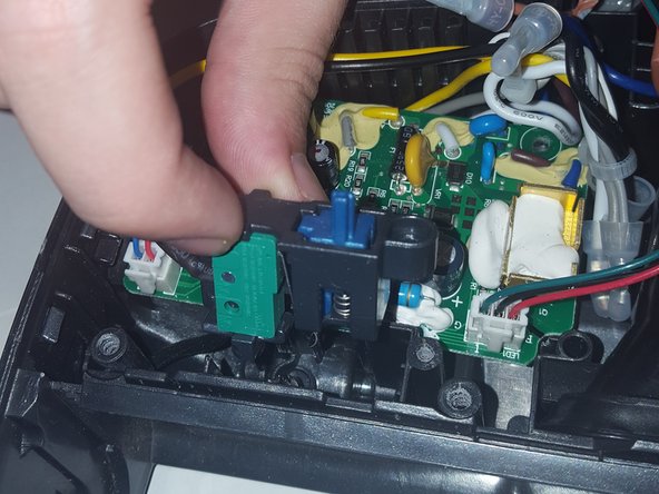

    • On the top of the vacuum head, to the tight of the 'Brush Roller Access' buttons, locate the two screws parallel to each other. Using the T15 to unscrew these two, lift up the panel by the flap as shown.
    • Careful while lifting up the panel! There are wires that are connected to it as shown below which are fragile.
  10. Shark Rocket HV381 Motor Replacement: crwdns2935265:010crwdnd2935265:01crwdnd2935265:01crwdne2935265:0
    • Using the T10 screwdriver, unscrew the screw as shown. This should free the panel from the wires. Place the panel to the side.

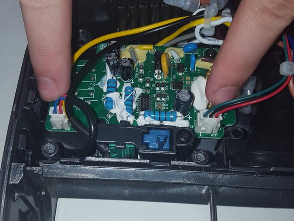

  11. Shark Rocket HV381 Motor Replacement: crwdns2935265:011crwdnd2935265:01crwdnd2935265:03crwdne2935265:0 Shark Rocket HV381 Motor Replacement: crwdns2935265:011crwdnd2935265:02crwdnd2935265:03crwdne2935265:0 Shark Rocket HV381 Motor Replacement: crwdns2935265:011crwdnd2935265:03crwdnd2935265:03crwdne2935265:0
    • Using the T10 screwdriver, unscrew the three screws as shown in the picture. It is important that you take your time to unscrew all three at the same pace. We found that increments of half a turn worked best.
    • The decision to unclip the wires from the motherboard or remove the blue device doesn't matter on order. Complete both steps before proceeding.
    • As easy as unclipping the wires may sound, you must be careful to avoid breaking them.

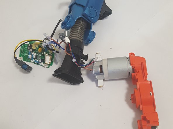

  15. Shark Rocket HV381 Motor Replacement: crwdns2935265:015crwdnd2935265:01crwdnd2935265:03crwdne2935265:0 Shark Rocket HV381 Motor Replacement: crwdns2935265:015crwdnd2935265:02crwdnd2935265:03crwdne2935265:0 Shark Rocket HV381 Motor Replacement: crwdns2935265:015crwdnd2935265:03crwdnd2935265:03crwdne2935265:0

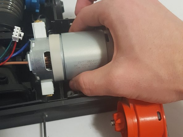

    • Firmly grasping the engine, pull it upwards until you hear either a soft click or loud crack. We experience both yet the vacuum was able to function just fine afterward. Keep moving it upwards until you can take the engine, motherboard, and hose out.

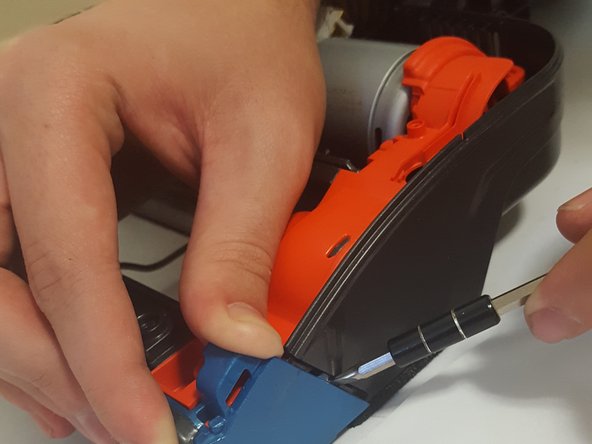

  16. Shark Rocket HV381 Motor Replacement: crwdns2935265:016crwdnd2935265:01crwdnd2935265:01crwdne2935265:0
    • You now have access to the engine! This step is entirely optional, but the orange rotary piece can be removed using the T10 Screwdriver on the screws shown here.
