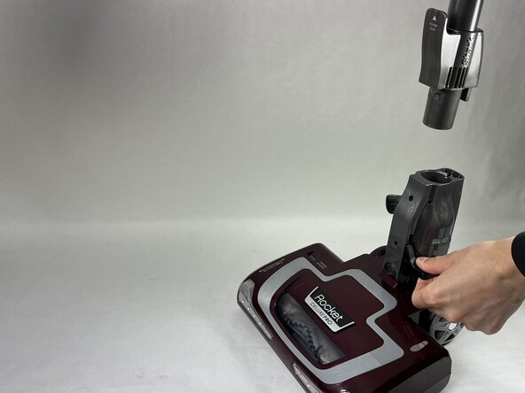

    • Make sure vacuum is turned off and unplugged before starting.
    • Push down on the black wand release lever to remove the motorized floor nozzle.

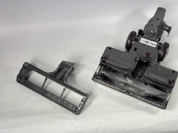

    • Rotate the three locks that secure the brushroll cover with a spudger.
    • Remove the brushroll cover.
    • The locks will click when they have reached the "unlock" position.

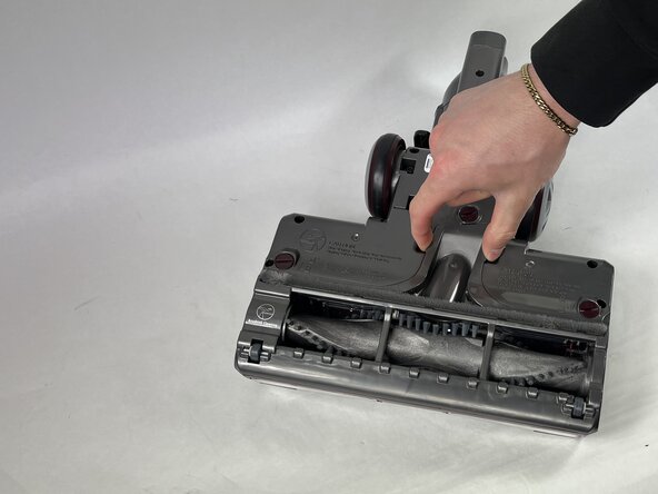

    • Remove the ten 9.4 mm Torx T8 screws on the bottom side of the motorized floor nozzle.
