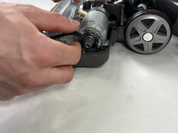

    • Remove the brushroll belt from floor nozzle motor by sliding it off of the gear.
    • Be careful not to damage the brushroll belt if it is in good condition when removing it.

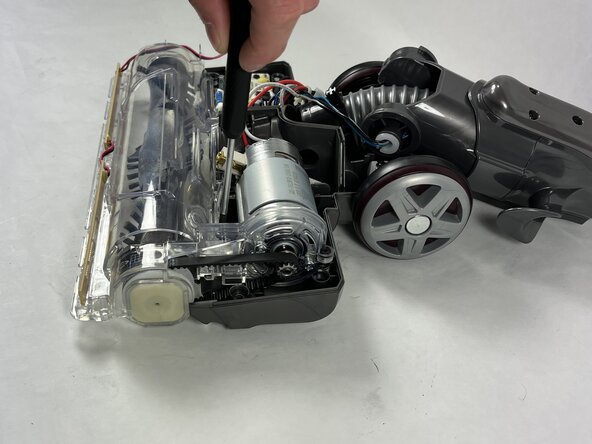

    • Remove the two 13.1 mm Phillips #1 screws from the brushroll motor.
  7. Shark Rocket HV322 Brushroll and Brushroll Belt Replacement: crwdns2935265:07crwdnd2935265:01crwdnd2935265:02crwdne2935265:0 Shark Rocket HV322 Brushroll and Brushroll Belt Replacement: crwdns2935265:07crwdnd2935265:02crwdnd2935265:02crwdne2935265:0

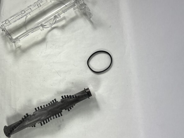

    • Remove the clear plastic cover from the motorized floor nozzle.
    • The brushroll and brushroll belt will slide out during this step
