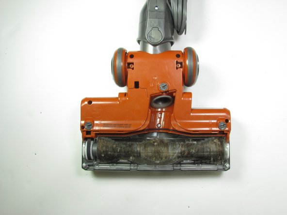

    • Flip the vacuum so the bottom base is visible.
    • Gently pry the bottom two wheels off with a plastic opening tool.

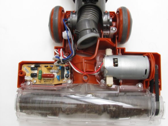

  2. Shark Rocket HV301 Rotary Belt Replacement: crwdns2935265:02crwdnd2935265:01crwdnd2935265:03crwdne2935265:0 Shark Rocket HV301 Rotary Belt Replacement: crwdns2935265:02crwdnd2935265:02crwdnd2935265:03crwdne2935265:0 Shark Rocket HV301 Rotary Belt Replacement: crwdns2935265:02crwdnd2935265:03crwdnd2935265:03crwdne2935265:0
    • Remove five visible screws with a Phillips #2 screwdriver.
    • Locate and twist the three plastic screws to the unlock position with a quarter or flathead screwdriver.

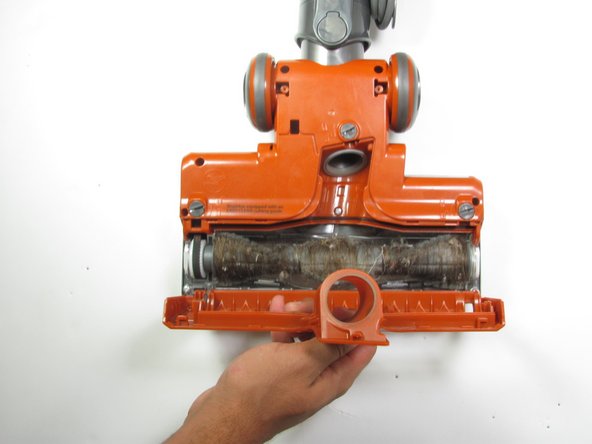

  3. Shark Rocket HV301 Rotary Belt Replacement: crwdns2935265:03crwdnd2935265:01crwdnd2935265:03crwdne2935265:0 Shark Rocket HV301 Rotary Belt Replacement: crwdns2935265:03crwdnd2935265:02crwdnd2935265:03crwdne2935265:0 Shark Rocket HV301 Rotary Belt Replacement: crwdns2935265:03crwdnd2935265:03crwdnd2935265:03crwdne2935265:0
    • Remove plate covering the roller brush.

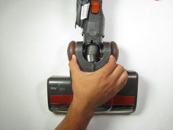

    • Turn the vacuum over so the rotary brush is on the ground.
    • Grab the vacuum on both sides of the hose and pull up to remove the top of the vacuum halfway.

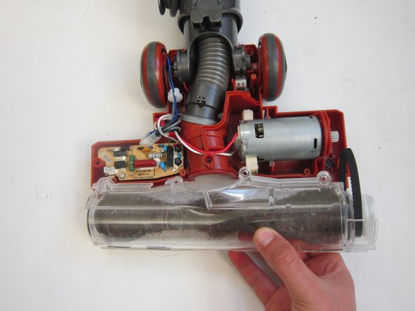

  7. Shark Rocket HV301 Rotary Belt Replacement: crwdns2935265:07crwdnd2935265:01crwdnd2935265:02crwdne2935265:0 Shark Rocket HV301 Rotary Belt Replacement: crwdns2935265:07crwdnd2935265:02crwdnd2935265:02crwdne2935265:0

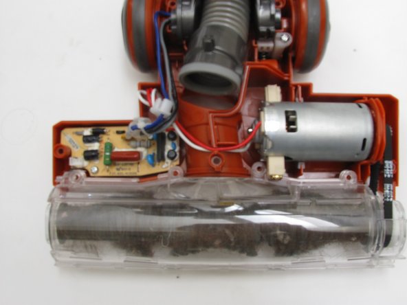

    • Use a Phillips #2 screwdriver to remove the four visible screws securing the rotary brush to the vacuum.
  8. Shark Rocket HV301 Rotary Belt Replacement: crwdns2935265:08crwdnd2935265:01crwdnd2935265:03crwdne2935265:0 Shark Rocket HV301 Rotary Belt Replacement: crwdns2935265:08crwdnd2935265:02crwdnd2935265:03crwdne2935265:0 Shark Rocket HV301 Rotary Belt Replacement: crwdns2935265:08crwdnd2935265:03crwdnd2935265:03crwdne2935265:0
    • Remove the rotary belt on right side of vacuum from the bearing.
    • Gently lift the casing to remove the belt and brush from the vacuum.

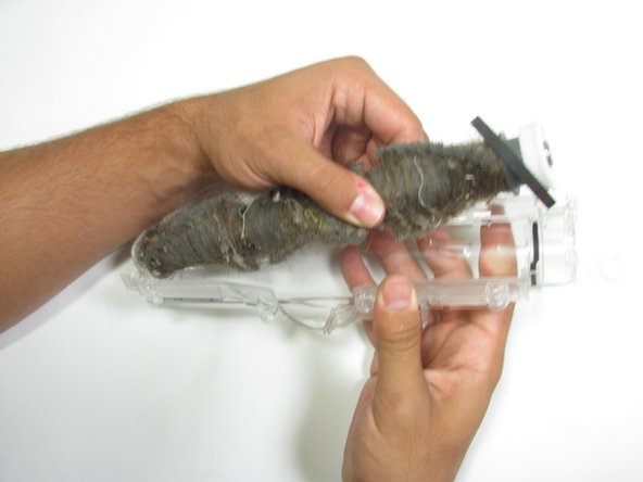

  9. Shark Rocket HV301 Rotary Belt Replacement: crwdns2935265:09crwdnd2935265:01crwdnd2935265:03crwdne2935265:0 Shark Rocket HV301 Rotary Belt Replacement: crwdns2935265:09crwdnd2935265:02crwdnd2935265:03crwdne2935265:0 Shark Rocket HV301 Rotary Belt Replacement: crwdns2935265:09crwdnd2935265:03crwdnd2935265:03crwdne2935265:0

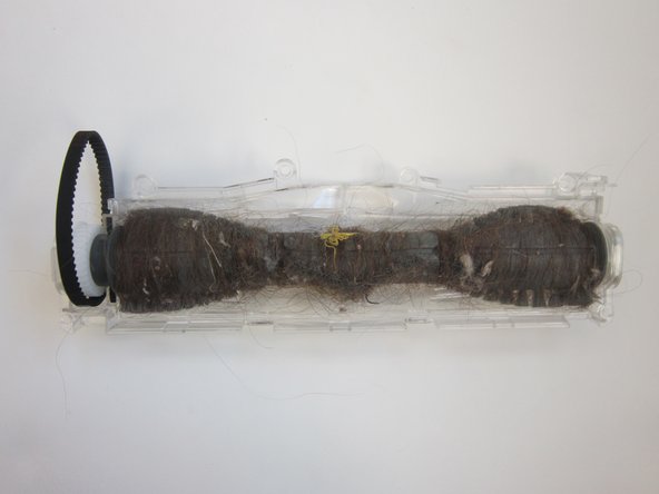

    • Gently pry off the plastic casing on both sides of rotary brush.
    • Lift the clear plastic shell from the rotary brush.

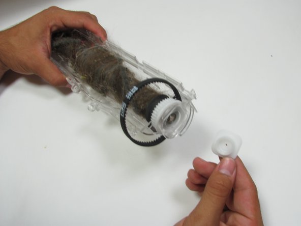

  10. Shark Rocket HV301 Rotary Belt Replacement: crwdns2935265:010crwdnd2935265:01crwdnd2935265:01crwdne2935265:0
    • Remove the rotary belt attached to the brush and replace it if needed.
  11. Shark Rocket HV301 Rotary Belt Replacement, Rotary Belt: crwdns2935265:011crwdnd2935265:01crwdnd2935265:01crwdne2935265:0
    • Replace belt if torn or damaged.

I could not get it out without removing the brush roll motor. So I am putting it back together and I need to know if the motor has a top and bottom. What I mean is does it matter ? Thank you
