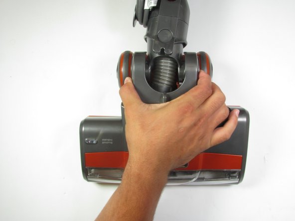

    • Place the base of the vacuum face down so the roller brush is facing you.
    • Locate the five screws and remove the screws using a Phillips #1 screwdriver. On some models, the screws may be Torx T4 instead of Phillips.
    • On some models, you may need to remove the two screws next to the big wheels, under the top two circled screws in the picture, with a Torx T3 screwdriver.
    • You may want to disconnect the base from the stick of the vacuum to make it easier to move around.

Great instructions, now where do I get the replacement hose. I can't seem to find one anywhere, please tell be where to look
Kay Fisher - crwdns2934203:0crwdne2934203:0
Rob the hose from the hard floor attachment, you probably do not use it as at low speed the brush head is awesome on hard floors.
Suzannne Scheans -
I found a hose that is a perfect fit. EVERBILT 6 ft Bilge and Pump Discharge Hose. 1-1/8 inch ID. Got it at Home Depot.
Nick Verciglio - crwdns2934203:0crwdne2934203:0
How did you get the hose from Home Depot to work? I’d like to try it, and I was hoping you would give some advice.
Joey Griffin -
Thank you so much for this recommendation! The Everbilt Bilge and Pump hose works perfectly!!! And now I have back up if I need to replace it again.
Thank you for the instructions as well Shelby! So much better than spending another $50 on a replacement head!
