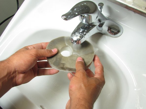

    3. Shark Rocket HV301 Filter Replacement: crwdns2935265:03crwdnd2935265:01crwdnd2935265:03crwdne2935265:0 Shark Rocket HV301 Filter Replacement: crwdns2935265:03crwdnd2935265:02crwdnd2935265:03crwdne2935265:0 Shark Rocket HV301 Filter Replacement: crwdns2935265:03crwdnd2935265:03crwdnd2935265:03crwdne2935265:0
      • Wash the filters by running tap water through them until clear unless you are buying new filters.
      • Lay thee filters out until they are completely dry.

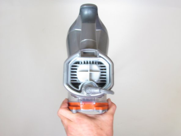

      • Locate the motor filter lid on the top of the vacuum with the vacuum facing you.
      • Remove the motor filter lid by pushing the release clip on the top and pulling towards you.

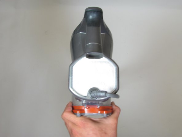

    5. Shark Rocket HV301 Filter Replacement: crwdns2935265:05crwdnd2935265:01crwdnd2935265:02crwdne2935265:0 Shark Rocket HV301 Filter Replacement: crwdns2935265:05crwdnd2935265:02crwdnd2935265:02crwdne2935265:0
      • Pinch the tab on the motor filter to remove it from the vacuum.
