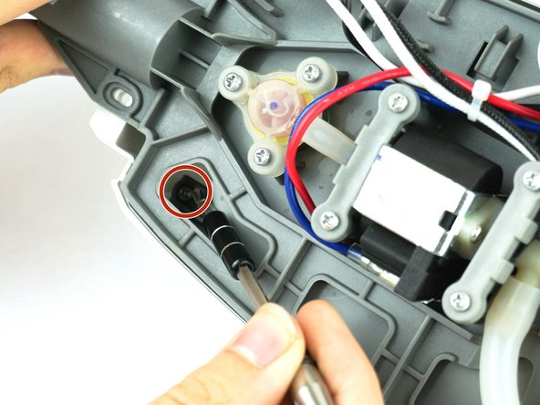

  12. Shark Professional Steam Pocket Mop Water Tank Replacement, Water Tank: crwdns2935265:012crwdnd2935265:01crwdnd2935265:02crwdne2935265:0 Shark Professional Steam Pocket Mop Water Tank Replacement, Water Tank: crwdns2935265:012crwdnd2935265:02crwdnd2935265:02crwdne2935265:0
    • Remove the top left 12.0 mm Phillips head #2 screw from inside body.

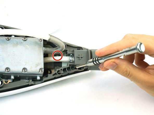

  13. Shark Professional Steam Pocket Mop Water Tank Replacement: crwdns2935265:013crwdnd2935265:01crwdnd2935265:02crwdne2935265:0 Shark Professional Steam Pocket Mop Water Tank Replacement: crwdns2935265:013crwdnd2935265:02crwdnd2935265:02crwdne2935265:0
    • Remove four 12.0 mm Phillips head #2 screws from the inside of the mop body.

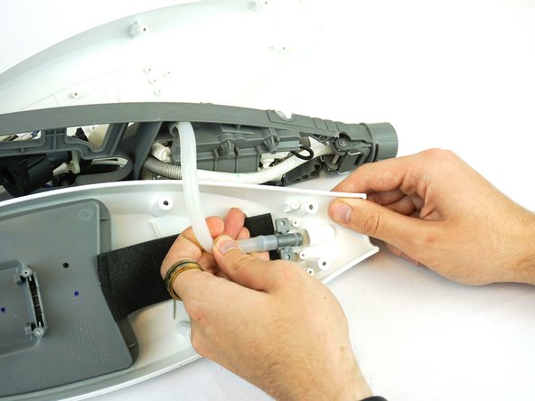

  14. Shark Professional Steam Pocket Mop Water Tank Replacement: crwdns2935265:014crwdnd2935265:01crwdnd2935265:02crwdne2935265:0 Shark Professional Steam Pocket Mop Water Tank Replacement: crwdns2935265:014crwdnd2935265:02crwdnd2935265:02crwdne2935265:0
    • Pull apart the bottom of the mop body from the dark grey connector.
    • Disconnect the tube from the bottom

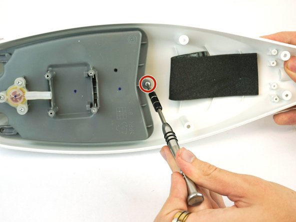

  15. Shark Professional Steam Pocket Mop Water Tank Replacement: crwdns2935265:015crwdnd2935265:01crwdnd2935265:02crwdne2935265:0 Shark Professional Steam Pocket Mop Water Tank Replacement: crwdns2935265:015crwdnd2935265:02crwdnd2935265:02crwdne2935265:0
    • Remove two 12.0 mm Phillips head #2 screws on the top and then pull back the black foam to reveal and remove the third 12.0 mm Phillips head #2 screw.
