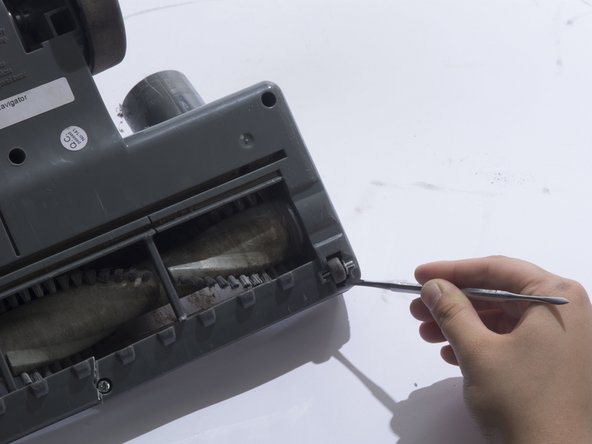

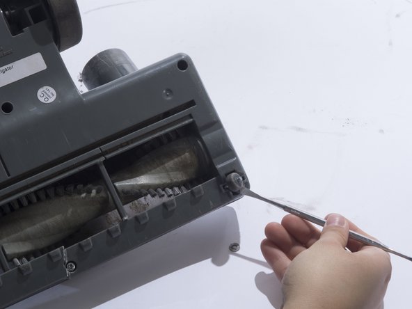

    4. Shark Navigator Lightweight Upright Motor Replacement: crwdns2935265:04crwdnd2935265:01crwdnd2935265:03crwdne2935265:0 Shark Navigator Lightweight Upright Motor Replacement: crwdns2935265:04crwdnd2935265:02crwdnd2935265:03crwdne2935265:0 Shark Navigator Lightweight Upright Motor Replacement: crwdns2935265:04crwdnd2935265:03crwdnd2935265:03crwdne2935265:0
      • Remove the small front wheels with a metal spudger by inserting the metal spudger in front of the wheel and slowly prying up. This will free the wheel and reveal the screw beneath it.
      • Repeat this for the other wheel.

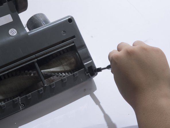

    5. Shark Navigator Lightweight Upright Motor Replacement: crwdns2935265:05crwdnd2935265:01crwdnd2935265:02crwdne2935265:0 Shark Navigator Lightweight Upright Motor Replacement: crwdns2935265:05crwdnd2935265:02crwdnd2935265:02crwdne2935265:0
      • Remove the two 18mm screws with a JIS 1 screwdriver.

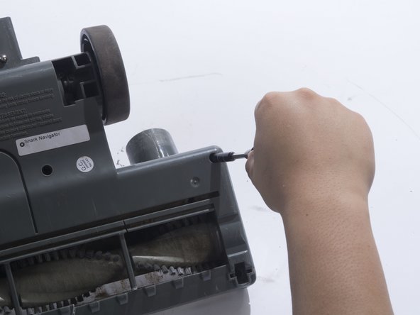

    6. Shark Navigator Lightweight Upright Motor Replacement: crwdns2935265:06crwdnd2935265:01crwdnd2935265:02crwdne2935265:0 Shark Navigator Lightweight Upright Motor Replacement: crwdns2935265:06crwdnd2935265:02crwdnd2935265:02crwdne2935265:0
      • Remove the four 18mm screws located on the top corners and the bottom/middle of the vacuum head using a JIS 1 screwdriver.

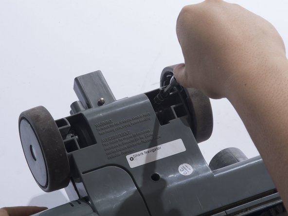

    7. Shark Navigator Lightweight Upright Motor Replacement: crwdns2935265:07crwdnd2935265:01crwdnd2935265:02crwdne2935265:0 Shark Navigator Lightweight Upright Motor Replacement: crwdns2935265:07crwdnd2935265:02crwdnd2935265:02crwdne2935265:0
      • Remove the two 18mm screws located on the inside of the large wheels using a JIS 1 screwdriver.

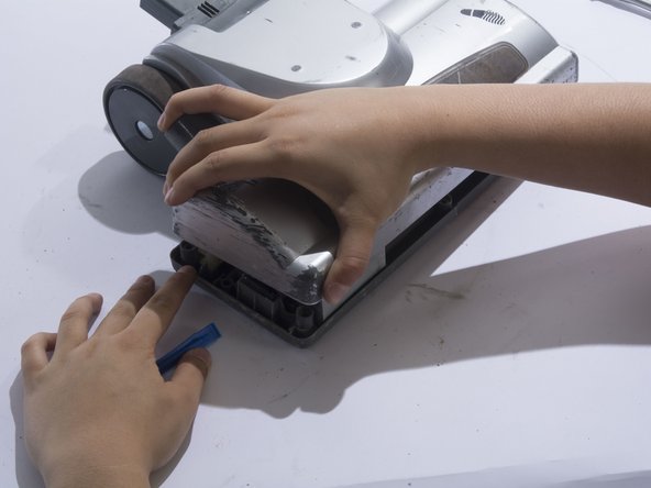

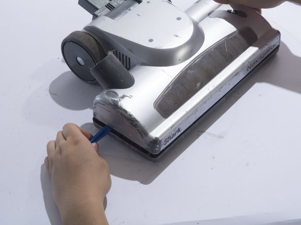

      • Remove the plastic cover by prying the plastic cover up using a plastic opening tool.
      • Prying in multiple locations may be necessary to create separation.
