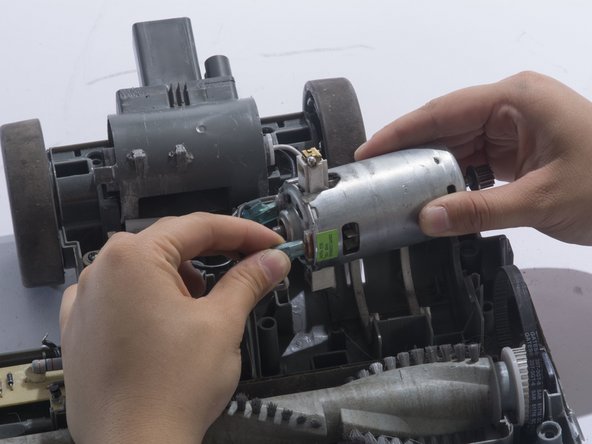

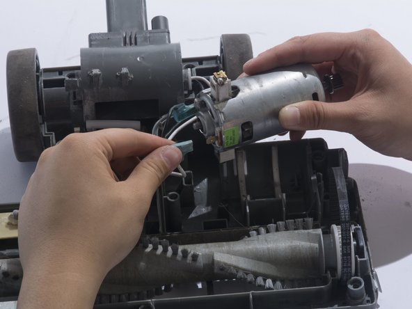

  9. Shark Navigator Lightweight Upright Motherboard Replacement, Motor: crwdns2935265:09crwdnd2935265:01crwdnd2935265:01crwdne2935265:0
    • Locate the motor on the top right corner of the vacuum head shell.

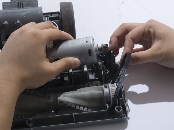

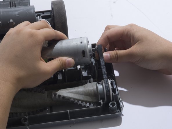

  10. Shark Navigator Lightweight Upright Motherboard Replacement: crwdns2935265:010crwdnd2935265:01crwdnd2935265:03crwdne2935265:0 Shark Navigator Lightweight Upright Motherboard Replacement: crwdns2935265:010crwdnd2935265:02crwdnd2935265:03crwdne2935265:0 Shark Navigator Lightweight Upright Motherboard Replacement: crwdns2935265:010crwdnd2935265:03crwdnd2935265:03crwdne2935265:0
    • Remove the belt from the motor gear by sliding the belt to the right.
  11. Shark Navigator Lightweight Upright Motherboard Replacement: crwdns2935265:011crwdnd2935265:01crwdnd2935265:03crwdne2935265:0 Shark Navigator Lightweight Upright Motherboard Replacement: crwdns2935265:011crwdnd2935265:02crwdnd2935265:03crwdne2935265:0 Shark Navigator Lightweight Upright Motherboard Replacement: crwdns2935265:011crwdnd2935265:03crwdnd2935265:03crwdne2935265:0

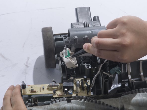

    • Remove the white metal wire connector from the motor.
    • The white cable is positive.

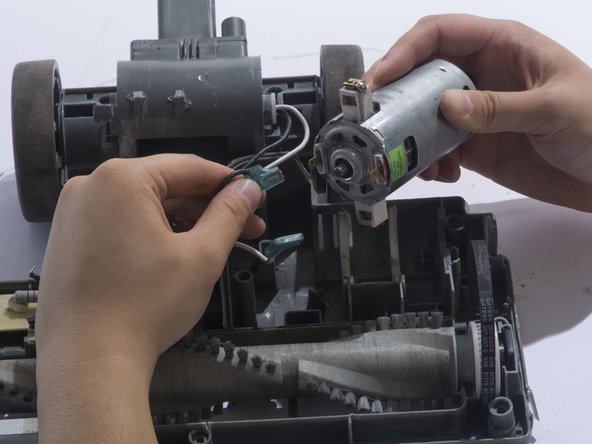

  12. Shark Navigator Lightweight Upright Motherboard Replacement: crwdns2935265:012crwdnd2935265:01crwdnd2935265:02crwdne2935265:0 Shark Navigator Lightweight Upright Motherboard Replacement: crwdns2935265:012crwdnd2935265:02crwdnd2935265:02crwdne2935265:0
    • Remove the black metal wire connector from the motor.
    • The black cable is negative.

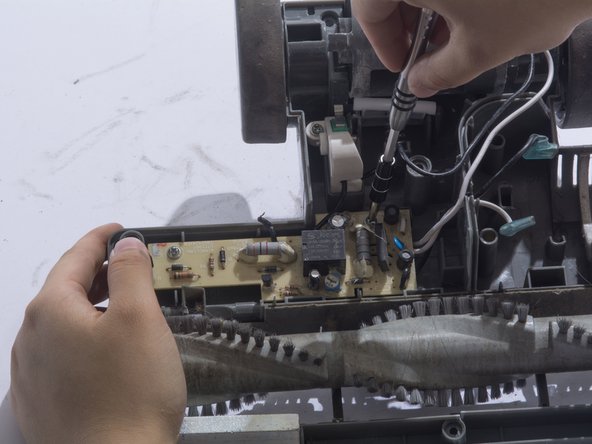

  13. Shark Navigator Lightweight Upright Motherboard Replacement, Motherboard: crwdns2935265:013crwdnd2935265:01crwdnd2935265:02crwdne2935265:0 Shark Navigator Lightweight Upright Motherboard Replacement, Motherboard: crwdns2935265:013crwdnd2935265:02crwdnd2935265:02crwdne2935265:0
    • Remove the two 12mm screws using a JIS 1 screwdriver.

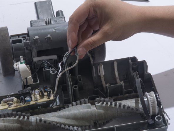

  15. Shark Navigator Lightweight Upright Motherboard Replacement: crwdns2935265:015crwdnd2935265:01crwdnd2935265:02crwdne2935265:0 Shark Navigator Lightweight Upright Motherboard Replacement: crwdns2935265:015crwdnd2935265:02crwdnd2935265:02crwdne2935265:0
    • Lift up the wire housing from the plastic base using tweezers.
  16. Shark Navigator Lightweight Upright Motherboard Replacement: crwdns2935265:016crwdnd2935265:01crwdnd2935265:02crwdne2935265:0 Shark Navigator Lightweight Upright Motherboard Replacement: crwdns2935265:016crwdnd2935265:02crwdnd2935265:02crwdne2935265:0
    • Free the black and white cables that were previously attached to the motor from their slot.
  17. Shark Navigator Lightweight Upright Motherboard Replacement: crwdns2935265:017crwdnd2935265:01crwdnd2935265:02crwdne2935265:0 Shark Navigator Lightweight Upright Motherboard Replacement: crwdns2935265:017crwdnd2935265:02crwdnd2935265:02crwdne2935265:0

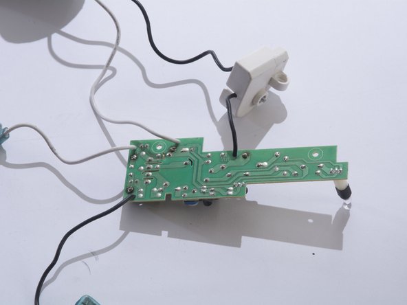

    • Free the motherboard and its connecting parts from the rest of the vacuum.
    • Turn the motherboard upside-down and spread wires out.

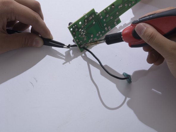

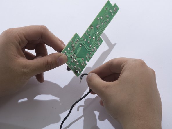

  18. Shark Navigator Lightweight Upright Motherboard Replacement: crwdns2935265:018crwdnd2935265:01crwdnd2935265:02crwdne2935265:0 Shark Navigator Lightweight Upright Motherboard Replacement: crwdns2935265:018crwdnd2935265:02crwdnd2935265:02crwdne2935265:0
    • Heat the wire connection's solder joint until the joint looks wet and liquidy.
    • While maintaining contact with the solder iron, free the wire end by pulling the wire away from the board with the tweezers.
    • For instructions on how to solder properly please refer to this soldering technique guide. How To Solder and Desolder Connections
    • Remember which cables were soldered onto where. You will have to re-solder the cables back onto the same joint.
    • Solder iron is extremely hot and should be handled with care. Always wear eye protection when soldering.

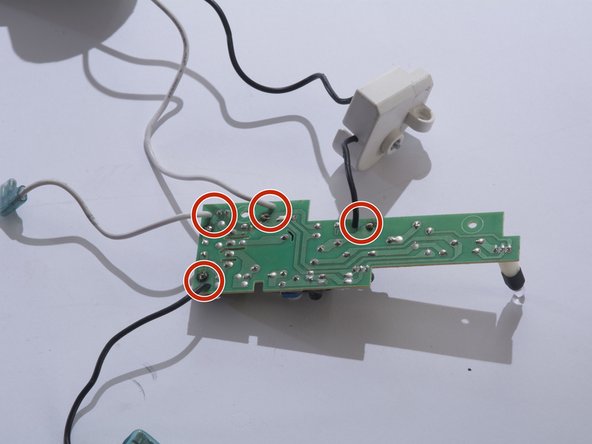

  19. Shark Navigator Lightweight Upright Motherboard Replacement: crwdns2935265:019crwdnd2935265:01crwdnd2935265:03crwdne2935265:0 Shark Navigator Lightweight Upright Motherboard Replacement: crwdns2935265:019crwdnd2935265:02crwdnd2935265:03crwdne2935265:0 Shark Navigator Lightweight Upright Motherboard Replacement: crwdns2935265:019crwdnd2935265:03crwdnd2935265:03crwdne2935265:0
    • Completely free the cable by pulling it out of the board.
    • Repeat for the remaining cables. There are 4 total.
