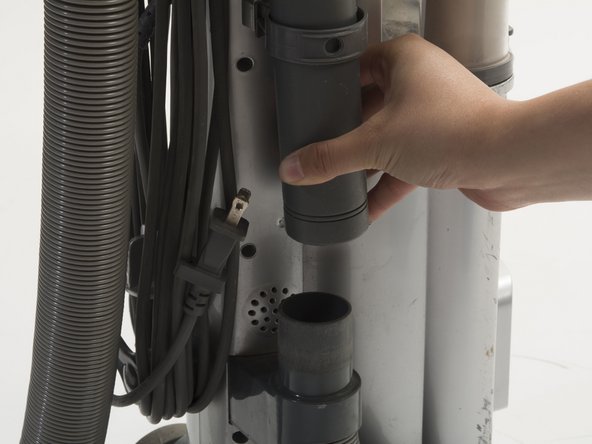

    • Locate the upper connection of the hose found directly below the base of the handle. Push in the the tab on the outside of the tube with your thumb.
    • Pull down on the tube while maintaining pressure on the tab.
    • Separate the upper connection of the tube from the housing, releasing the hose.
  2. Shark Navigator Lightweight Upright Hose Replacement: crwdns2935265:02crwdnd2935265:01crwdnd2935265:02crwdne2935265:0 Shark Navigator Lightweight Upright Hose Replacement: crwdns2935265:02crwdnd2935265:02crwdnd2935265:02crwdne2935265:0
    • Locate the lower attachment of the hose found in the bottom left corner.
    • Pull the hose down towards the floor, releasing the hose from the hose guide.

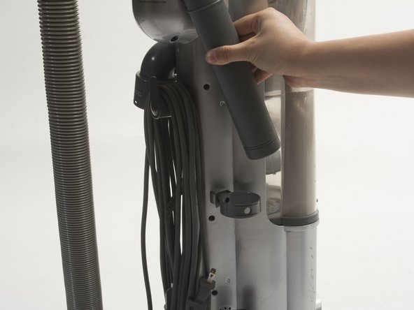

  3. Shark Navigator Lightweight Upright Hose Replacement: crwdns2935265:03crwdnd2935265:01crwdnd2935265:03crwdne2935265:0 Shark Navigator Lightweight Upright Hose Replacement: crwdns2935265:03crwdnd2935265:02crwdnd2935265:03crwdne2935265:0 Shark Navigator Lightweight Upright Hose Replacement: crwdns2935265:03crwdnd2935265:03crwdnd2935265:03crwdne2935265:0
    • Pull up on the hose pipe located on the right side of the vacuum firmly.
    • Lift the hose pipe upwards and all the way through the plastic guide ring.
