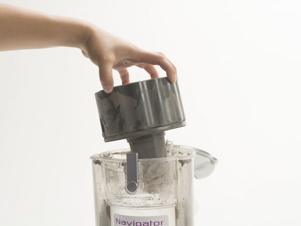

  3. Shark Navigator Lightweight Upright Dust Cup Replacement: crwdns2935265:03crwdnd2935265:01crwdnd2935265:02crwdne2935265:0 Shark Navigator Lightweight Upright Dust Cup Replacement: crwdns2935265:03crwdnd2935265:02crwdnd2935265:02crwdne2935265:0
    • Remove the dust cup from the inside of the dust container.

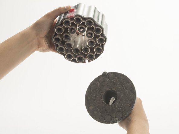

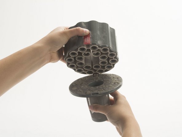

  4. Shark Navigator Lightweight Upright Dust Cup Replacement: crwdns2935265:04crwdnd2935265:01crwdnd2935265:03crwdne2935265:0 Shark Navigator Lightweight Upright Dust Cup Replacement: crwdns2935265:04crwdnd2935265:02crwdnd2935265:03crwdne2935265:0 Shark Navigator Lightweight Upright Dust Cup Replacement: crwdns2935265:04crwdnd2935265:03crwdnd2935265:03crwdne2935265:0
    • Push in the red tab located on the side of the dust cup.
    • Open the dust cup simultaneously with the cone-half pointing downwards.
    • Separate the two halves.
