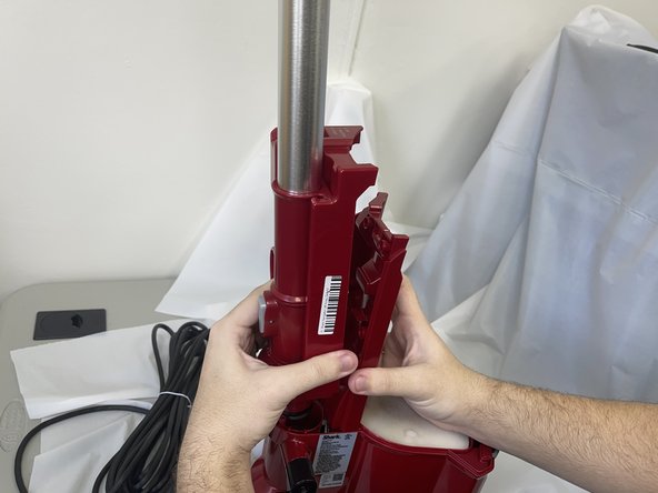

    • Grab the front of the vacuum frame and lift the wand assembly to remove it.
    • This will reveal the underside of the switch.

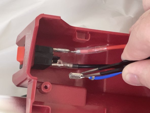

    • Use tweezers or your fingers to disconnect the power switch connectors.
    • Each of the wires has a release tab at the bottom of the metal portion. Be sure to depress it before pulling to avoid damage.

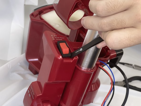

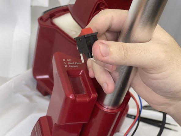

    • Push the switch out of its housing from the underside.
    • Remove the switch.
