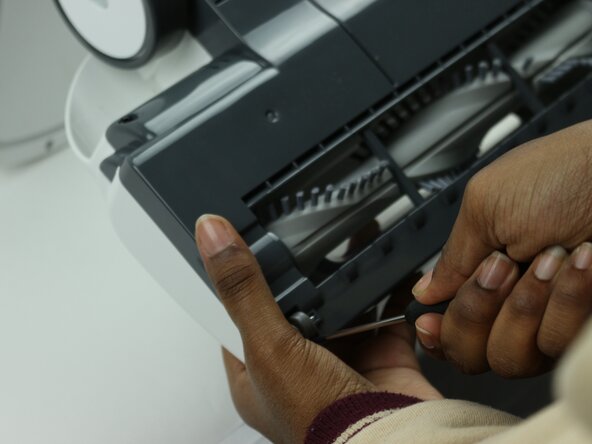

    • Flip the vacuum over.
    • Remove the bottom wheels with a spudger.

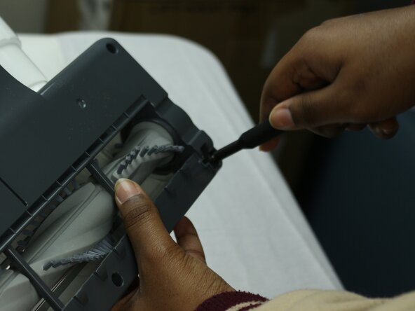

  2. Shark Navigator Lift-Away Pro NV356E V5 Motor Replacement: crwdns2935265:02crwdnd2935265:01crwdnd2935265:03crwdne2935265:0 Shark Navigator Lift-Away Pro NV356E V5 Motor Replacement: crwdns2935265:02crwdnd2935265:02crwdnd2935265:03crwdne2935265:0 Shark Navigator Lift-Away Pro NV356E V5 Motor Replacement: crwdns2935265:02crwdnd2935265:03crwdnd2935265:03crwdne2935265:0
    • Remove the six screws on the bottom of the roller brush compartment using a Phillips #1 screwdriver.

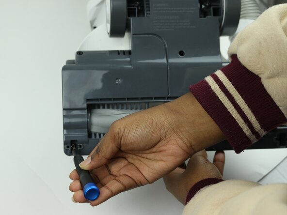

  3. Shark Navigator Lift-Away Pro NV356E V5 Motor Replacement: crwdns2935265:03crwdnd2935265:01crwdnd2935265:01crwdne2935265:0
    • Remove the grey cover to reveal the roller compartment.

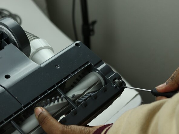

  4. Shark Navigator Lift-Away Pro NV356E V5 Motor Replacement, Motor: crwdns2935265:04crwdnd2935265:01crwdnd2935265:01crwdne2935265:0
    • Remove the motor.
  5. Shark Navigator Lift-Away Pro NV356E V5 Motor Replacement: crwdns2935265:05crwdnd2935265:01crwdnd2935265:01crwdne2935265:0
    • Unhook any wires connected to the motor.
