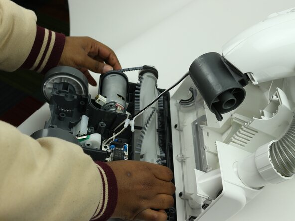

    • Flip the vacuum over.
    • Remove the bottom wheels with a spudger.
  2. Shark Navigator Lift-Away Pro NV356E V5 HEPA Brush Roller Replacement: crwdns2935265:02crwdnd2935265:01crwdnd2935265:03crwdne2935265:0 Shark Navigator Lift-Away Pro NV356E V5 HEPA Brush Roller Replacement: crwdns2935265:02crwdnd2935265:02crwdnd2935265:03crwdne2935265:0 Shark Navigator Lift-Away Pro NV356E V5 HEPA Brush Roller Replacement: crwdns2935265:02crwdnd2935265:03crwdnd2935265:03crwdne2935265:0
    • Remove the six screws on the bottom of the roller brush compartment using a Phillips #1 screwdriver.
  3. Shark Navigator Lift-Away Pro NV356E V5 HEPA Brush Roller Replacement: crwdns2935265:03crwdnd2935265:01crwdnd2935265:01crwdne2935265:0
    • Remove the grey cover to reveal the roller compartment.

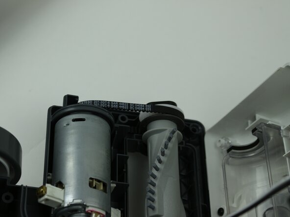

  4. Shark Navigator Lift-Away Pro NV356E V5 HEPA Brush Roller Replacement, Brush Roller: crwdns2935265:04crwdnd2935265:01crwdnd2935265:03crwdne2935265:0 Shark Navigator Lift-Away Pro NV356E V5 HEPA Brush Roller Replacement, Brush Roller: crwdns2935265:04crwdnd2935265:02crwdnd2935265:03crwdne2935265:0 Shark Navigator Lift-Away Pro NV356E V5 HEPA Brush Roller Replacement, Brush Roller: crwdns2935265:04crwdnd2935265:03crwdnd2935265:03crwdne2935265:0
    • Lift the old roller brush.
    • Remove the belt from the roller brush.
    • Remove the roller brush from the vacuum.

Failed to include the 4 screws in steps again such as the roller compartment guide. In the steps you did not include taking the belt off, only reassembling it.
