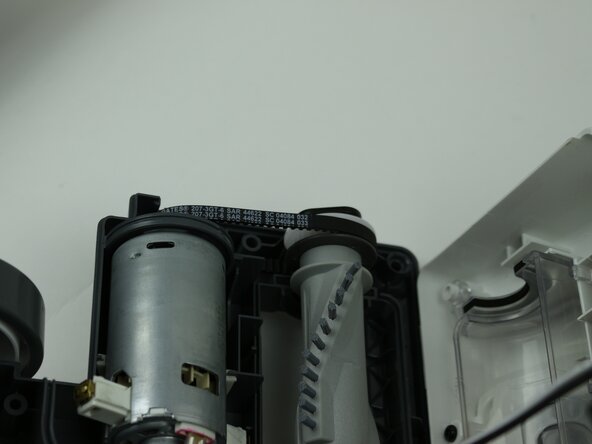

  4. Shark Navigator Lift-Away Pro NV356E V5 Brush Roller Belt Replacement, Brush Roller Belt: crwdns2935265:04crwdnd2935265:01crwdnd2935265:02crwdne2935265:0 Shark Navigator Lift-Away Pro NV356E V5 Brush Roller Belt Replacement, Brush Roller Belt: crwdns2935265:04crwdnd2935265:02crwdnd2935265:02crwdne2935265:0
    • Lift up the brush roller.
    • Remove the belt from the brush roller.
