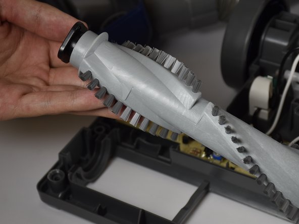

  9. Shark Navigator Lift-Away Deluxe NV360 Roller Brush Replacement, Roller Brush: crwdns2935265:09crwdnd2935265:01crwdnd2935265:02crwdne2935265:0 Shark Navigator Lift-Away Deluxe NV360 Roller Brush Replacement, Roller Brush: crwdns2935265:09crwdnd2935265:02crwdnd2935265:02crwdne2935265:0
    • Remove the roller brush from the plastic frame using your hands by lifting it away.
