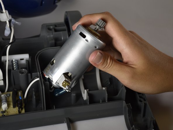

  10. Shark Navigator Lift-Away Deluxe NV360 Roller Brush Motor Replacement, Roller Brush Motor: crwdns2935265:010crwdnd2935265:01crwdnd2935265:02crwdne2935265:0 Shark Navigator Lift-Away Deluxe NV360 Roller Brush Motor Replacement, Roller Brush Motor: crwdns2935265:010crwdnd2935265:02crwdnd2935265:02crwdne2935265:0
    • Lift the roller brush motor up and away from its half-cylindrical holder with your hand.
  11. Shark Navigator Lift-Away Deluxe NV360 Roller Brush Motor Replacement: crwdns2935265:011crwdnd2935265:01crwdnd2935265:03crwdne2935265:0 Shark Navigator Lift-Away Deluxe NV360 Roller Brush Motor Replacement: crwdns2935265:011crwdnd2935265:02crwdnd2935265:03crwdne2935265:0 Shark Navigator Lift-Away Deluxe NV360 Roller Brush Motor Replacement: crwdns2935265:011crwdnd2935265:03crwdnd2935265:03crwdne2935265:0

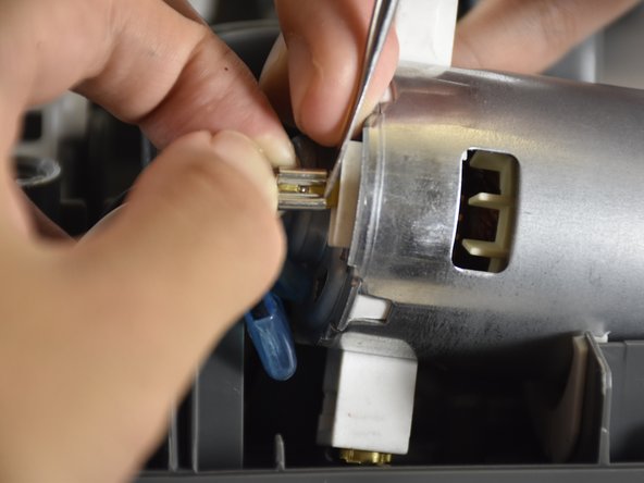

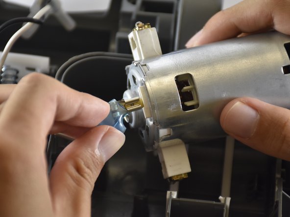

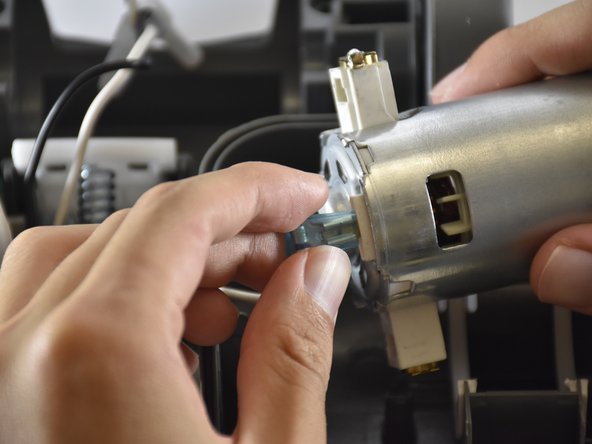

    • Locate the two connectors coming out of the roller brush motor.
    • Pinch and pull the blue plastic insulation down the wire and away from the motor until the metal connectors are fully exposed.
  12. Shark Navigator Lift-Away Deluxe NV360 Roller Brush Motor Replacement: crwdns2935265:012crwdnd2935265:01crwdnd2935265:03crwdne2935265:0 Shark Navigator Lift-Away Deluxe NV360 Roller Brush Motor Replacement: crwdns2935265:012crwdnd2935265:02crwdnd2935265:03crwdne2935265:0 Shark Navigator Lift-Away Deluxe NV360 Roller Brush Motor Replacement: crwdns2935265:012crwdnd2935265:03crwdnd2935265:03crwdne2935265:0

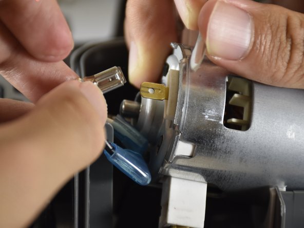

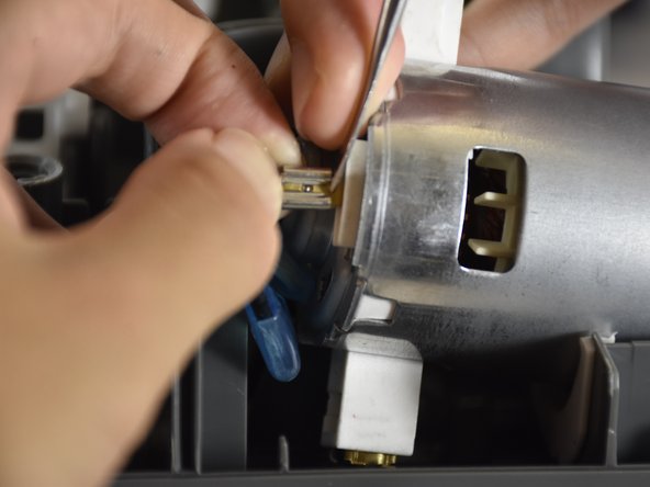

    • Locate the protrusion near the connection between the metal and wire.
    • Push down on the protrusion with your finger and push the metal connector away from the motor with the metal spudger.

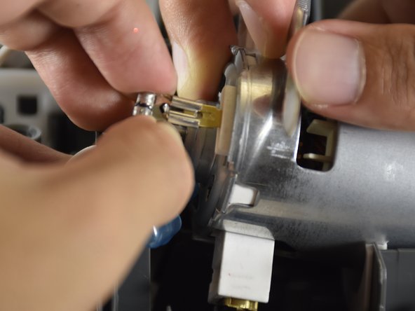

  13. Shark Navigator Lift-Away Deluxe NV360 Roller Brush Motor Replacement: crwdns2935265:013crwdnd2935265:01crwdnd2935265:03crwdne2935265:0 Shark Navigator Lift-Away Deluxe NV360 Roller Brush Motor Replacement: crwdns2935265:013crwdnd2935265:02crwdnd2935265:03crwdne2935265:0 Shark Navigator Lift-Away Deluxe NV360 Roller Brush Motor Replacement: crwdns2935265:013crwdnd2935265:03crwdnd2935265:03crwdne2935265:0
    • Continue to push on the connector away from the motor with the metal spudger until it is disconnected completely.
    • Repeat the steps 12-14 for the other wire.

    • Take the motor out and away from the motorized floor brush compartment by hand.
