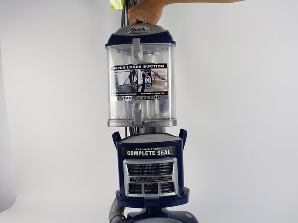

    • Locate the latches on the side of the dust cup, the clear plastic chamber in the center of the vacuum.
  2. Shark Navigator Lift-Away Deluxe NV360 Power Button Replacement: crwdns2935265:02crwdnd2935265:01crwdnd2935265:03crwdne2935265:0 Shark Navigator Lift-Away Deluxe NV360 Power Button Replacement: crwdns2935265:02crwdnd2935265:02crwdnd2935265:03crwdne2935265:0 Shark Navigator Lift-Away Deluxe NV360 Power Button Replacement: crwdns2935265:02crwdnd2935265:03crwdnd2935265:03crwdne2935265:0
    • Pull the bottom of the latch with your hand in an upward direction.
    • Lift the top of the latch up and away from the dust cup using your hand.
    • Repeat the above steps with the latch on the other side of the dust cup.
  3. Shark Navigator Lift-Away Deluxe NV360 Power Button Replacement: crwdns2935265:03crwdnd2935265:01crwdnd2935265:02crwdne2935265:0 Shark Navigator Lift-Away Deluxe NV360 Power Button Replacement: crwdns2935265:03crwdnd2935265:02crwdnd2935265:02crwdne2935265:0
    • Lift the dust cup up and away by its handle on the top with your hands.

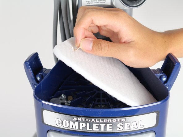

  4. Shark Navigator Lift-Away Deluxe NV360 Power Button Replacement: crwdns2935265:04crwdnd2935265:01crwdnd2935265:03crwdne2935265:0 Shark Navigator Lift-Away Deluxe NV360 Power Button Replacement: crwdns2935265:04crwdnd2935265:02crwdnd2935265:03crwdne2935265:0 Shark Navigator Lift-Away Deluxe NV360 Power Button Replacement: crwdns2935265:04crwdnd2935265:03crwdnd2935265:03crwdne2935265:0

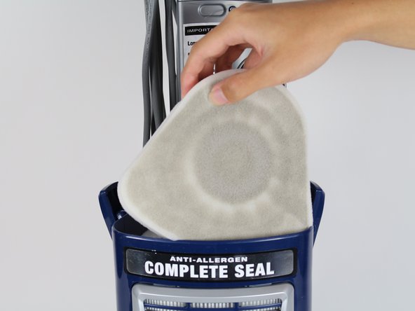

    • Lift the foam filter up, out, and away with your hands.

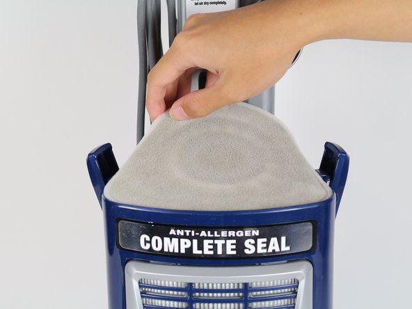

  5. Shark Navigator Lift-Away Deluxe NV360 Power Button Replacement: crwdns2935265:05crwdnd2935265:01crwdnd2935265:03crwdne2935265:0 Shark Navigator Lift-Away Deluxe NV360 Power Button Replacement: crwdns2935265:05crwdnd2935265:02crwdnd2935265:03crwdne2935265:0 Shark Navigator Lift-Away Deluxe NV360 Power Button Replacement: crwdns2935265:05crwdnd2935265:03crwdnd2935265:03crwdne2935265:0

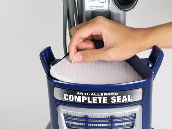

    • Lift the felt filter up, out, and away with your hands by the tab on the top.

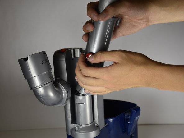

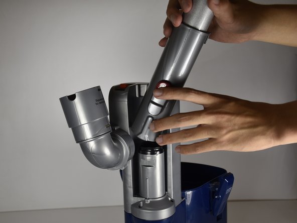

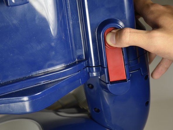

    • Locate the red latch on the side of the vacuum cleaner.
    • Push the circular region of the latch with your finger.
  7. Shark Navigator Lift-Away Deluxe NV360 Power Button Replacement: crwdns2935265:07crwdnd2935265:01crwdnd2935265:02crwdne2935265:0 Shark Navigator Lift-Away Deluxe NV360 Power Button Replacement: crwdns2935265:07crwdnd2935265:02crwdnd2935265:02crwdne2935265:0
    • Lift this upper plastic body of the vacuum cleaner up with your hands while continuing to press on the circular region of the latch.

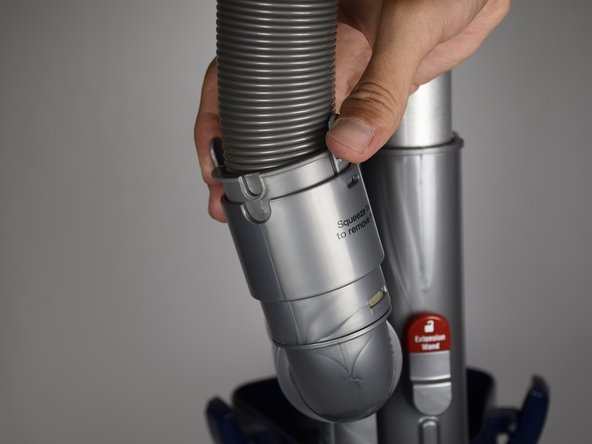

  8. Shark Navigator Lift-Away Deluxe NV360 Power Button Replacement: crwdns2935265:08crwdnd2935265:01crwdnd2935265:03crwdne2935265:0 Shark Navigator Lift-Away Deluxe NV360 Power Button Replacement: crwdns2935265:08crwdnd2935265:02crwdnd2935265:03crwdne2935265:0 Shark Navigator Lift-Away Deluxe NV360 Power Button Replacement: crwdns2935265:08crwdnd2935265:03crwdnd2935265:03crwdne2935265:0

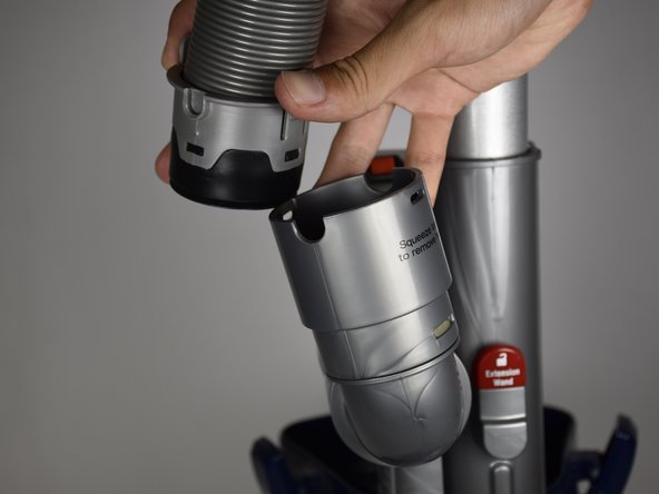

    • Locate the lower junction that connects the curved grey plastic tube and the hose coming from the vacuum cleaner's handle.
    • Press on the two grey flaps on either side of the hose simultaneously with your fingers and lift the hose out of the plastic cup with your hand.

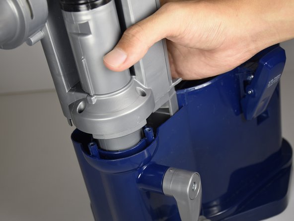

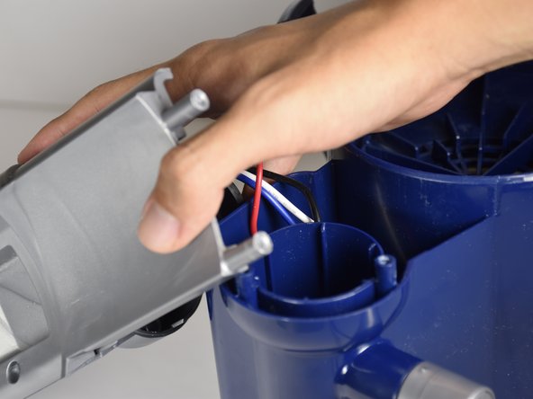

    • Locate the red latch that was next to the hose from the previous step.
    • Hold the bottom of vacuum cleaner's handle and its extension.
    • Use your other hand to press on the latch.

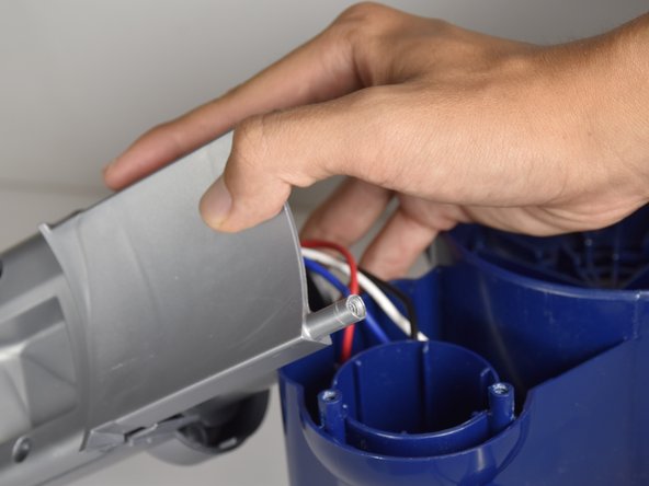

    • Lift the handle off the vacuum cleaner.

    • Remove the two 15mm screws with the PH1 screwdriver located on the bottom side of grey plastic body from which the handle was removed.

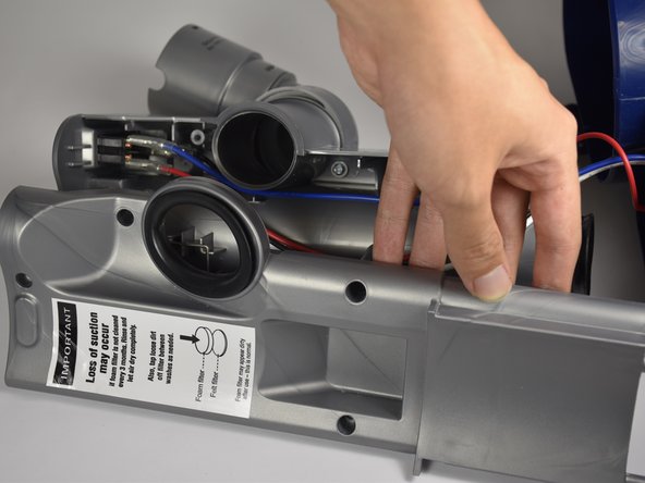

  11. Shark Navigator Lift-Away Deluxe NV360 Power Button Replacement: crwdns2935265:011crwdnd2935265:01crwdnd2935265:02crwdne2935265:0 Shark Navigator Lift-Away Deluxe NV360 Power Button Replacement: crwdns2935265:011crwdnd2935265:02crwdnd2935265:02crwdne2935265:0
    • Lift the grey compartment out of the main body of the vacuum cleaner by pulling upwards with your hands.
  12. Shark Navigator Lift-Away Deluxe NV360 Power Button Replacement: crwdns2935265:012crwdnd2935265:01crwdnd2935265:03crwdne2935265:0 Shark Navigator Lift-Away Deluxe NV360 Power Button Replacement: crwdns2935265:012crwdnd2935265:02crwdnd2935265:03crwdne2935265:0 Shark Navigator Lift-Away Deluxe NV360 Power Button Replacement: crwdns2935265:012crwdnd2935265:03crwdnd2935265:03crwdne2935265:0
    • Continue to pull on the grey compartment until it is fully out of the main body of the vacuum.
    • Place the grey compartment on a surface for the next step.

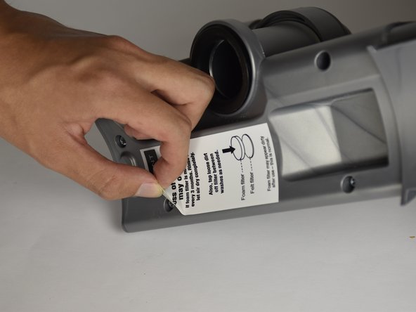

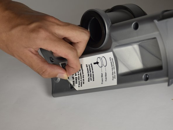

  13. Shark Navigator Lift-Away Deluxe NV360 Power Button Replacement: crwdns2935265:013crwdnd2935265:01crwdnd2935265:03crwdne2935265:0 Shark Navigator Lift-Away Deluxe NV360 Power Button Replacement: crwdns2935265:013crwdnd2935265:02crwdnd2935265:03crwdne2935265:0 Shark Navigator Lift-Away Deluxe NV360 Power Button Replacement: crwdns2935265:013crwdnd2935265:03crwdnd2935265:03crwdne2935265:0
    • Peel the sticker away with your hands until the hidden screw hole is fully exposed.

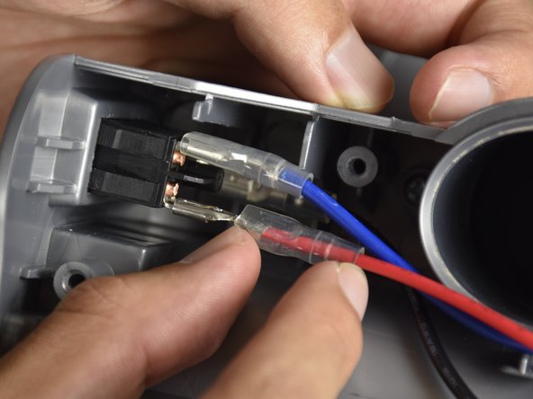

  16. Shark Navigator Lift-Away Deluxe NV360 Power Button Replacement: crwdns2935265:016crwdnd2935265:01crwdnd2935265:02crwdne2935265:0 Shark Navigator Lift-Away Deluxe NV360 Power Button Replacement: crwdns2935265:016crwdnd2935265:02crwdnd2935265:02crwdne2935265:0

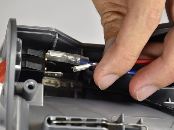

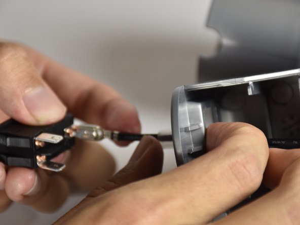

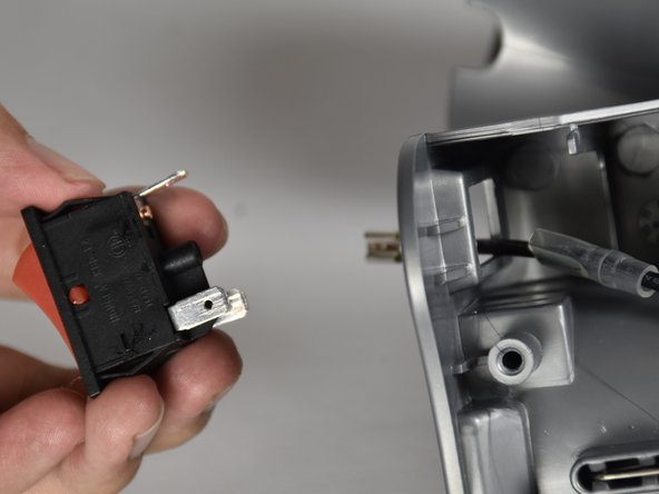

    • Locate the red power button and its red, blue, and black connected wires.
    • Pinch and pull the red wire's clear plastic insulator away from the power button with your hands until the metal connector is fully exposed.
    • Repeat this step for the blue wire.

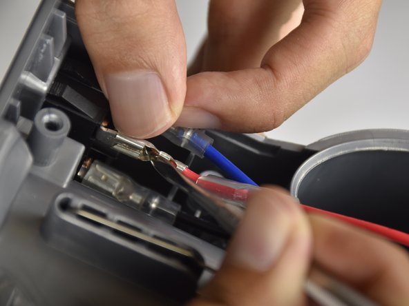

  17. Shark Navigator Lift-Away Deluxe NV360 Power Button Replacement: crwdns2935265:017crwdnd2935265:01crwdnd2935265:03crwdne2935265:0 Shark Navigator Lift-Away Deluxe NV360 Power Button Replacement: crwdns2935265:017crwdnd2935265:02crwdnd2935265:03crwdne2935265:0 Shark Navigator Lift-Away Deluxe NV360 Power Button Replacement: crwdns2935265:017crwdnd2935265:03crwdnd2935265:03crwdne2935265:0

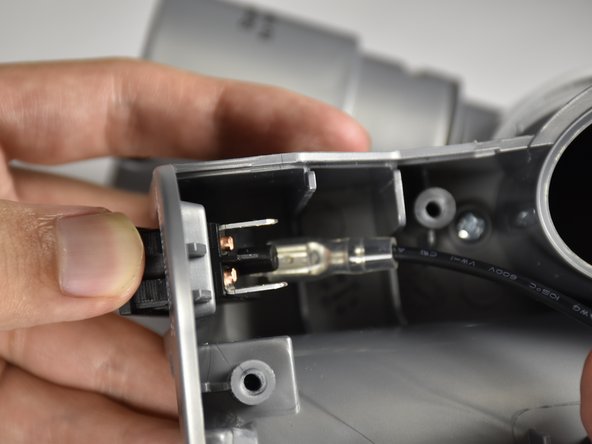

    • Locate the protrusion on the metal connector of the red wire.
    • Push down on the protrusion with the metal spudger while pushing the connector on the red wire away from the power button with your fingers.
    • Pull and wiggle the wire away by its connector with your fingers until it is completely detached from the connector on the power button.

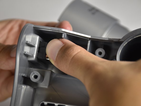

    • Push down towards the outside on the ledges that are holding the power button inside the grey frame.
    • Pull on the power button from the outside of the grey compartment with your hands, once the ledges are past the edge of grey frame.
  19. Shark Navigator Lift-Away Deluxe NV360 Power Button Replacement: crwdns2935265:019crwdnd2935265:01crwdnd2935265:03crwdne2935265:0 Shark Navigator Lift-Away Deluxe NV360 Power Button Replacement: crwdns2935265:019crwdnd2935265:02crwdnd2935265:03crwdne2935265:0 Shark Navigator Lift-Away Deluxe NV360 Power Button Replacement: crwdns2935265:019crwdnd2935265:03crwdnd2935265:03crwdne2935265:0
    • Pull the power button a couple inches away from the grey frame with your hands so that you have easy access to the black wire's connection.
    • Repeat steps 16 and 17 on the black wire and its connector.
    • Remove the disconnected power button away from the frame with your hands.
