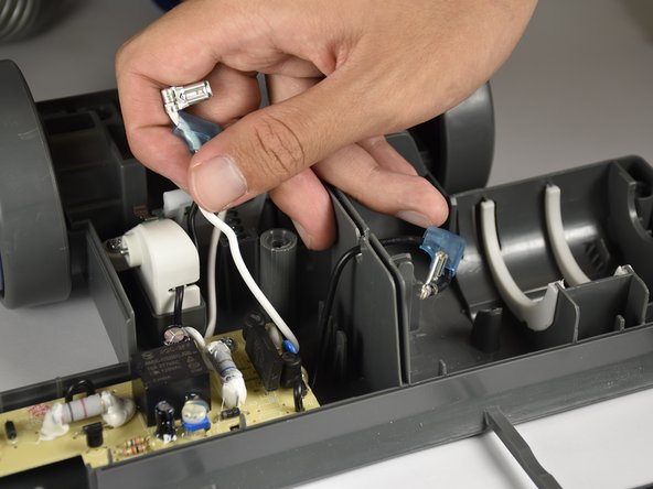

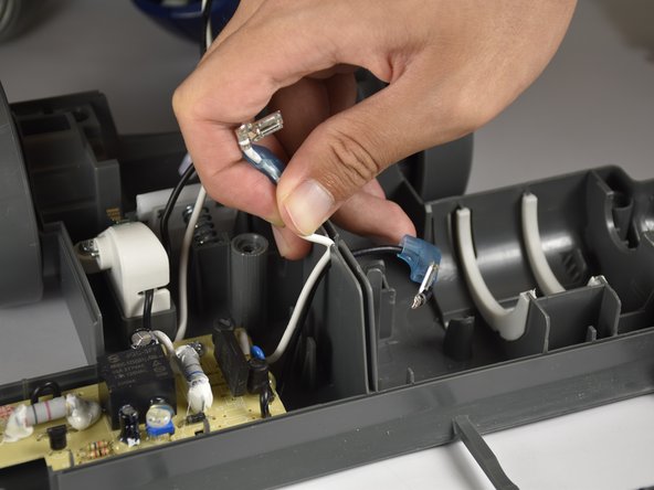

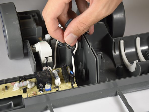

    • Locate the two wires that were connected to the roller brush motor.
    • Remove the white wire from the pass-through hole in the divider of the motorized floor brush compartment.
  16. Shark Navigator Lift-Away Deluxe NV360 Motherboard Replacement: crwdns2935265:016crwdnd2935265:01crwdnd2935265:02crwdne2935265:0 Shark Navigator Lift-Away Deluxe NV360 Motherboard Replacement: crwdns2935265:016crwdnd2935265:02crwdnd2935265:02crwdne2935265:0
    • Remove the black wire from the pass-through hole in the divider of the motorized floor brush compartment.

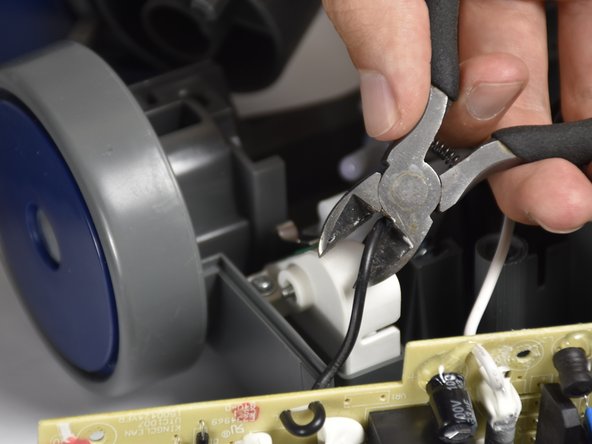

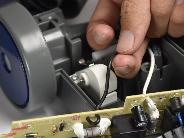

    • Pull the black wire out of the white holder with a pass-through slot using your hands.
    • Cut the black wire from the motherboard with the wire cutters.
    • Solder the wire connection back together during reassembly.
