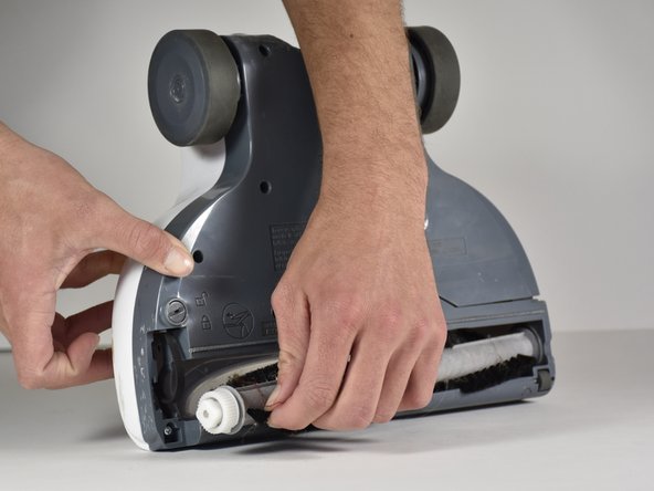

    • Remove the black rubber band from the roller brush
    • In most models there will be a plastic cover over the rubber band. You will use the quarter to twist the latch and take off the cover

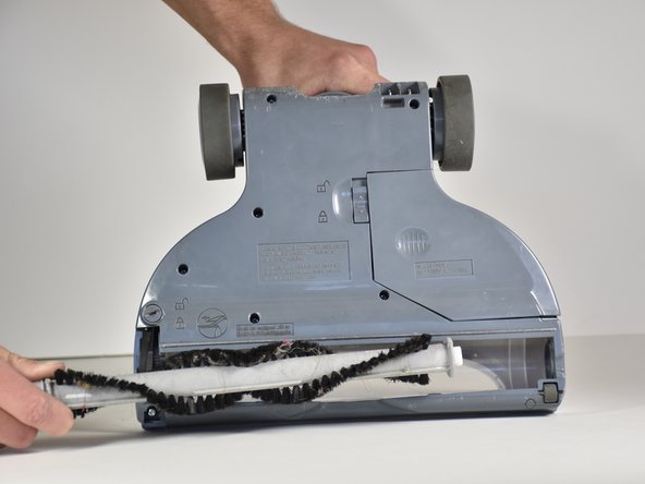

  2. Shark Navigator Freestyle SV1106 Roller Brush Replacement: crwdns2935265:02crwdnd2935265:01crwdnd2935265:03crwdne2935265:0 Shark Navigator Freestyle SV1106 Roller Brush Replacement: crwdns2935265:02crwdnd2935265:02crwdnd2935265:03crwdne2935265:0 Shark Navigator Freestyle SV1106 Roller Brush Replacement: crwdns2935265:02crwdnd2935265:03crwdnd2935265:03crwdne2935265:0
    • Use the bristles to pull the end of the brush that was connected to the belt away from the vacuum.
  3. Shark Navigator Freestyle SV1106 Roller Brush Replacement: crwdns2935265:03crwdnd2935265:01crwdnd2935265:03crwdne2935265:0 Shark Navigator Freestyle SV1106 Roller Brush Replacement: crwdns2935265:03crwdnd2935265:02crwdnd2935265:03crwdne2935265:0 Shark Navigator Freestyle SV1106 Roller Brush Replacement: crwdns2935265:03crwdnd2935265:03crwdnd2935265:03crwdne2935265:0
    • Slide the roller belt off of the roller brush and pull the roller away from the motorized brush.
