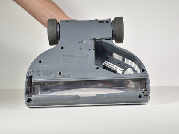

    • Turn the device over to reveal the bottom of the motorized brush head.

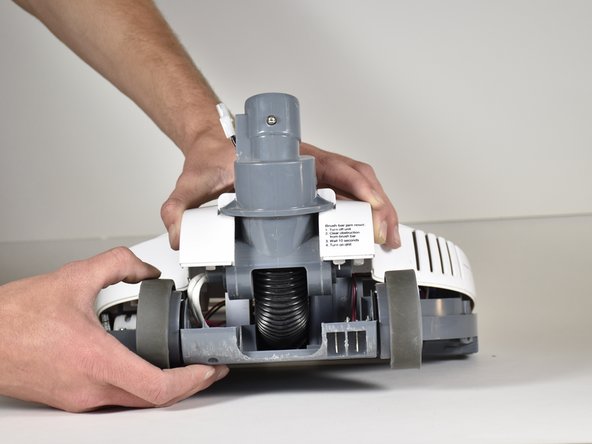

    • Pull the battery from the vacuum.

    • Remove the eight 25.4 mm Phillips #1 screws holding the bottom panel to the vacuum.

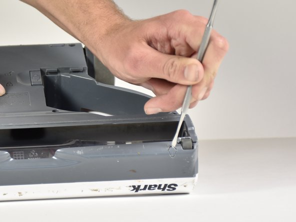

    • Use the metal spudger to remove the plastic plug to reveal a 12.4 mm Phillips #1 screw and remove it.
  7. Shark Navigator Freestyle SV1106 Roller Belt Replacement: crwdns2935265:07crwdnd2935265:01crwdnd2935265:01crwdne2935265:0
    • Remove the final 25.4 mm Phillips #1 screw inside the battery compartment.

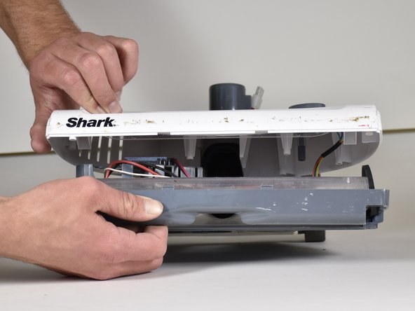

  8. Shark Navigator Freestyle SV1106 Roller Belt Replacement: crwdns2935265:08crwdnd2935265:01crwdnd2935265:03crwdne2935265:0 Shark Navigator Freestyle SV1106 Roller Belt Replacement: crwdns2935265:08crwdnd2935265:02crwdnd2935265:03crwdne2935265:0 Shark Navigator Freestyle SV1106 Roller Belt Replacement: crwdns2935265:08crwdnd2935265:03crwdnd2935265:03crwdne2935265:0
    • Remove the bottom panel from the vacuum by pressing to release the latches at the front and pulling the bottom panel away from the vacuum.

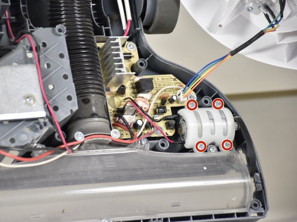

    • Remove the 12.2 mm Phillips #1 screws holding the motor in place and remove the motor by pulling directly upwards.

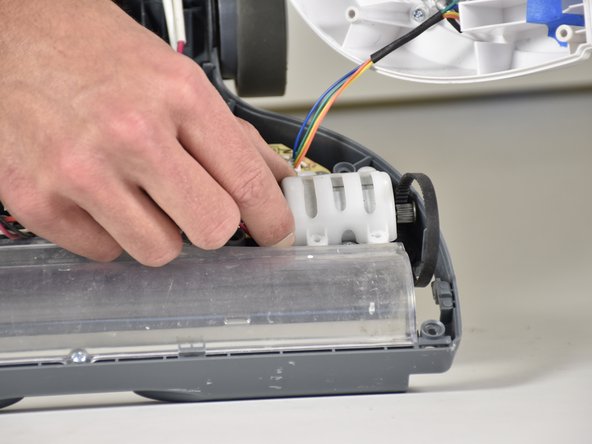

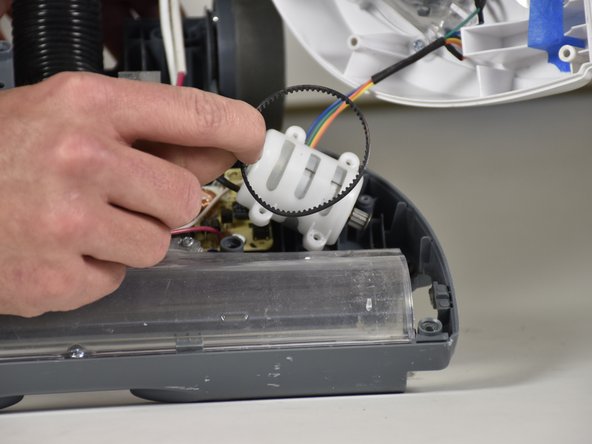

    • Remove the belt by sliding it off the end of the motor.
